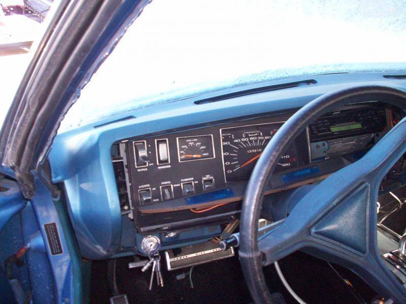

This is awful to admit but my steering column isn't straight and I never noticed it before. I dropped the column down to remove the instrument cluster and put it all back together, finally, about a week ago. Today was the first chance I had to actually sit in the car and I noticed that the steering wheel isn't square with the rest of the car. The column isn't either and, unless I am missing something very unusual, that's how it was built. If I put a straight edge against the wheel it doesn't line up straight with the windshield for example. It is at an angle so, while driving the car, the right side of the wheel is closer to the driver than the left side.
I know this must sound nuts but I really need some confirmation about what I am seeing. Anyone wish to tell me the story?

This is partially because of the optical illusion created by the slightly curved dash. The mount bolts for the coluum have some adjustment built into them, try loosing them up to see if it will compensate. In any case it wont hurt a darn thing if it is a little cockeyed. Most of us driving these things are that way too!

The issue isn't with the column but with the column /steering box misalignment. Also the adjustability of the column is very limited and doesn't come close to making up for you misalignment.
Thanks all.
On the lower end of the steering column, the position of the steering gear dictates where the column ends.
According to one theory, the upper end of the steering column is pointing to the driver's side door a little to place the steering wheel in front of the driver - who, in a six-passenger car, has his assigned position at the far left and not towards the middle.

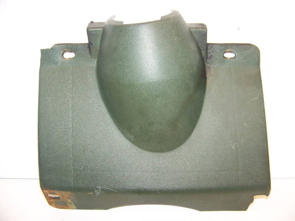

But the angle is far smaller than the lower column cover/shield might make you think whose form is mostly due to the curvature of the dash and not the angle of the column to the centerline of the car.
simply the steering gear couldn't move any further left, they didn't want the driver more to the right. The only way they could have fixed this was to utilize a couple u-joints and they didn't want to do that, why? who knows.
