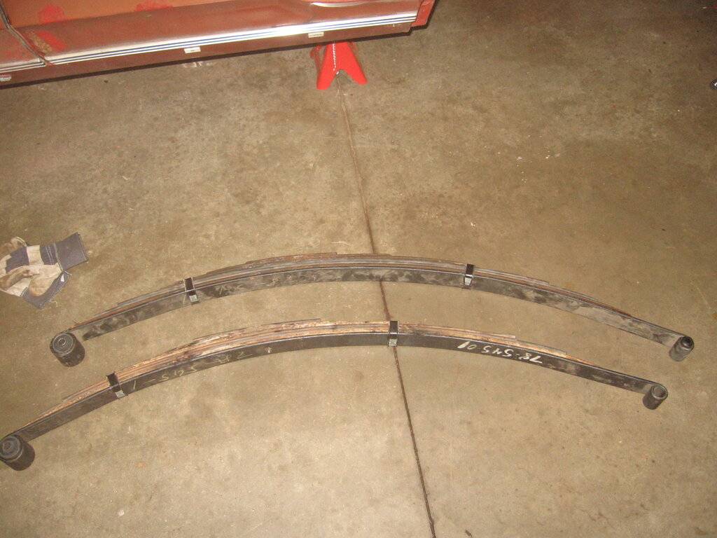

not the best shot but the only one I could find. I have never been able to find the original bolt clamps that goes through the springs (located where the current strap clamp is).
NOS main leafs 68 Chrysler natural grey metal.
