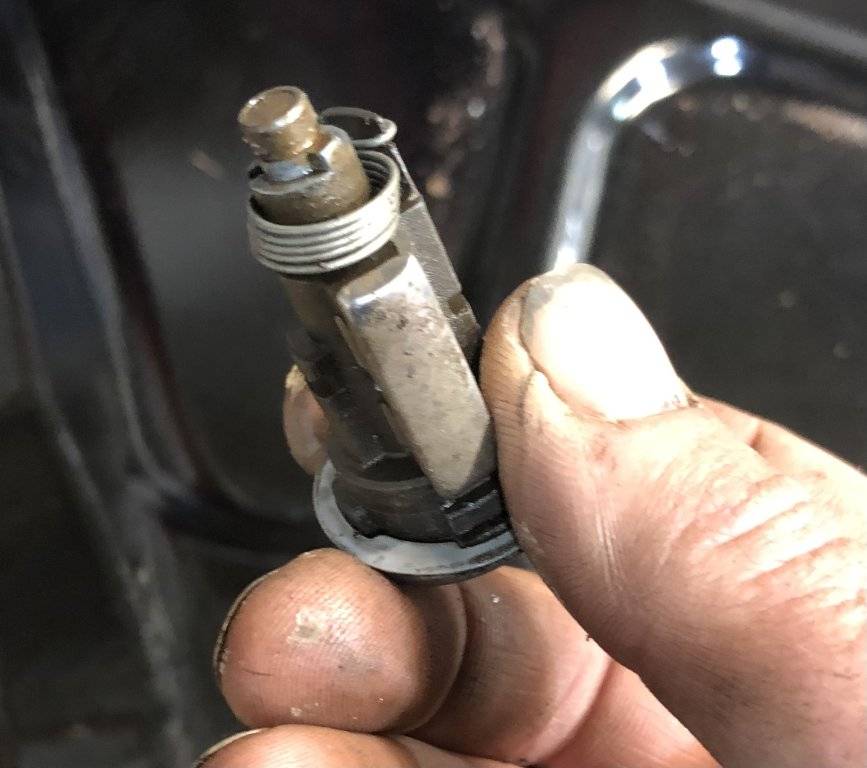

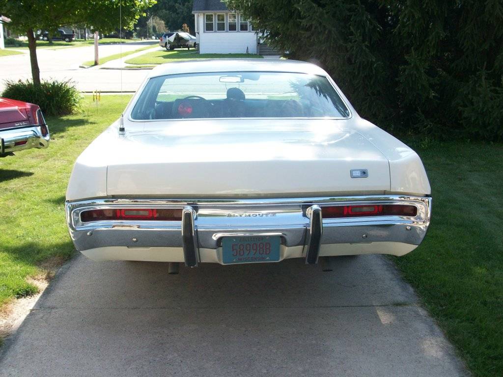

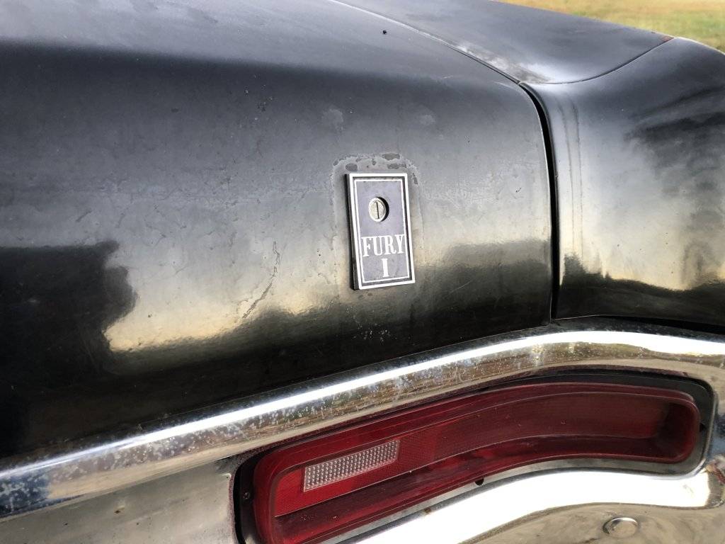

First, I want to thank everyone again for their response. Secondly, I feel that I need to clarify my inquiry.
I think I threw everyone off track with the backstory of my dilemma. That’s all on me,and, I apologize. Now, to clarify what I am wanting to know, I’ll put it differently. I’ll include pictures as a visual aid.

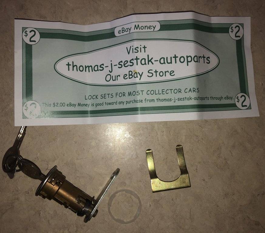

The first picture shows the mechanism that I want to replace.
The second picture illustrates where it goes on the car. This is located on the right side of a 1970 Plymouth Fury I trunk lid, or boot if you’re from UK.

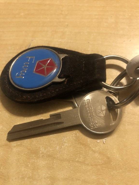

The third picture is of the kind of key it should take. It is a blank because I don’t have the mechanism yet to match it with. THAT is the lock/tumbler that I am trying to find.

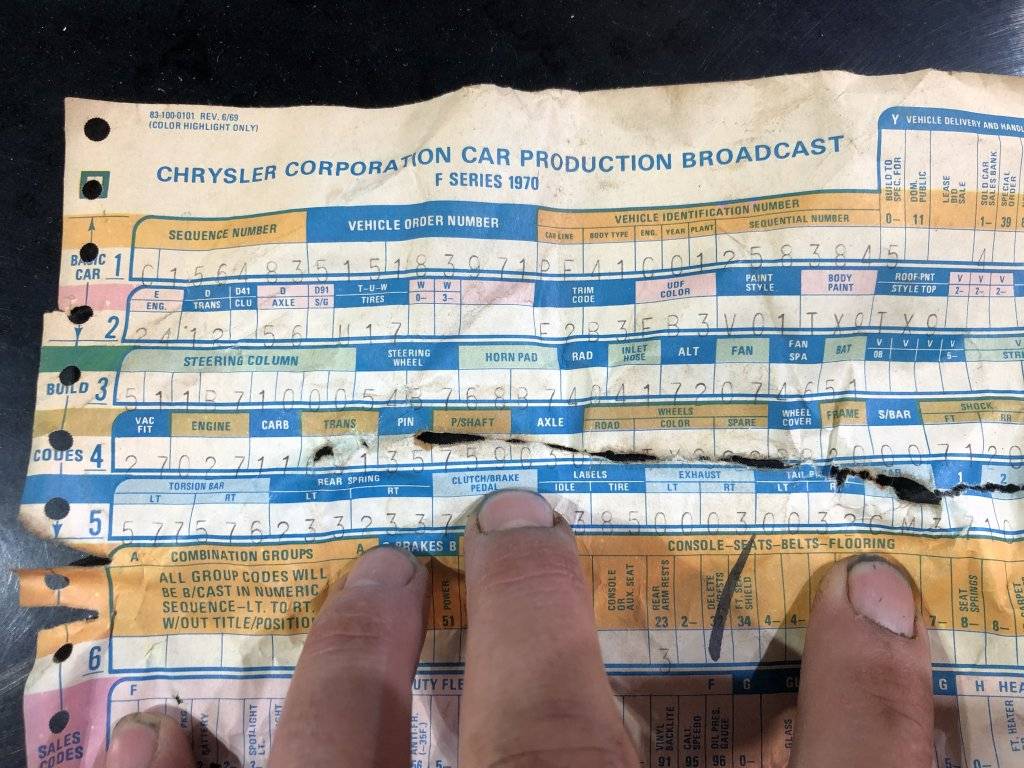

The fourth picture is of a blank that fits the ignition switch as well as the door locks. I do have the original that fits perfectly which I will use to transfer the pattern of to this blank. No help needed there. I felt it necessary to include it to show that I do know what key goes where on this model Plymouth. Again, I thank you for your input and apologize for the confusion.

I was thinking that the same year Barracuda might use the same lock cylinder because of the right side mounting, but the part numbers are different. 3419453 for the Plymouth and 341952 for the Barracuda.
But if you are just looking to get that round head key to fit that lock, you can take that cylinder and the blank key to a good locksmith and they can change the tumblers to match.

I believe that I understand what you are looking for, but let me first repeat what I believe are your requirements:
You are looking to have a trunk lock and key that are different than the ignition key.
(And you have a trunk lock cylinder that is keyed the same as the ignition lock cylinder)
If this is a correct regurgitation of your requirements as well as the statement in parentheses is true, then I would recommend that you do this:
1) you can take the lock cylinder for the trunk with the key that fits it to a locksmith and have them jumble the pins in the lock cylinder and make a new trunk key, which will be keyed differently than the ignition key and cylinder and you will then have a unique key and lock cylinder for the trunk.
OR
2) you could buy the item that you cited in post #5 and install that.
Did I get your problem statement correct?

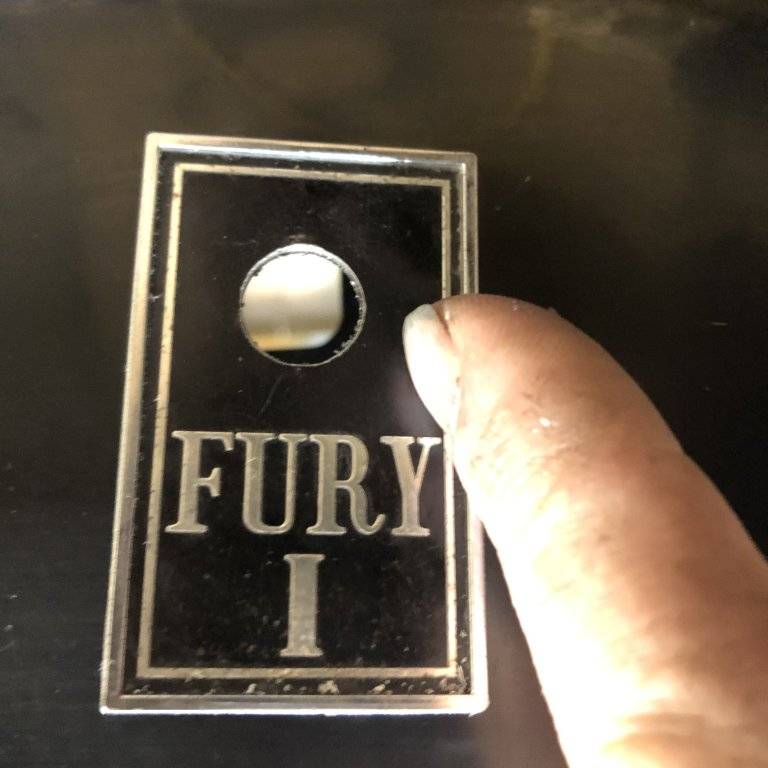

You got it! I’m going with option 2. I just didn’t know if it would work for sure because of the location being different than most.
Full disclosure that I didn’t want to mention before because I didn’t think it was pertinent: The lock sometimes acted weird. Occasionally I’d have to jiggle the key to get it to turn, most times it would work fine. The last time the jiggling didn’t work. So I used a 3/8” drill bit on it. So, when I say, “I need a trunk lock for my ‘70 Plymouth Fury I”, I ain’t kidding!

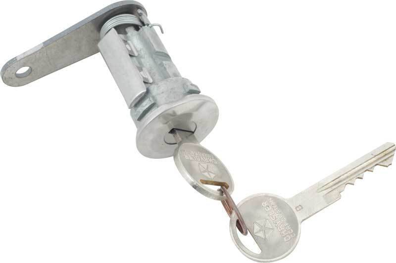

I don't think "option 2" is going to work for you. The lock in the eBay link isn't correct for your car.
Someone correct me if I'm wrong, but IIRC, the lock cylinder in the Fury, because it's mounted on the right side, has an arm on it that connects to the rod that connects to the actual latch in the center. It looks like this Barracuda lock.
