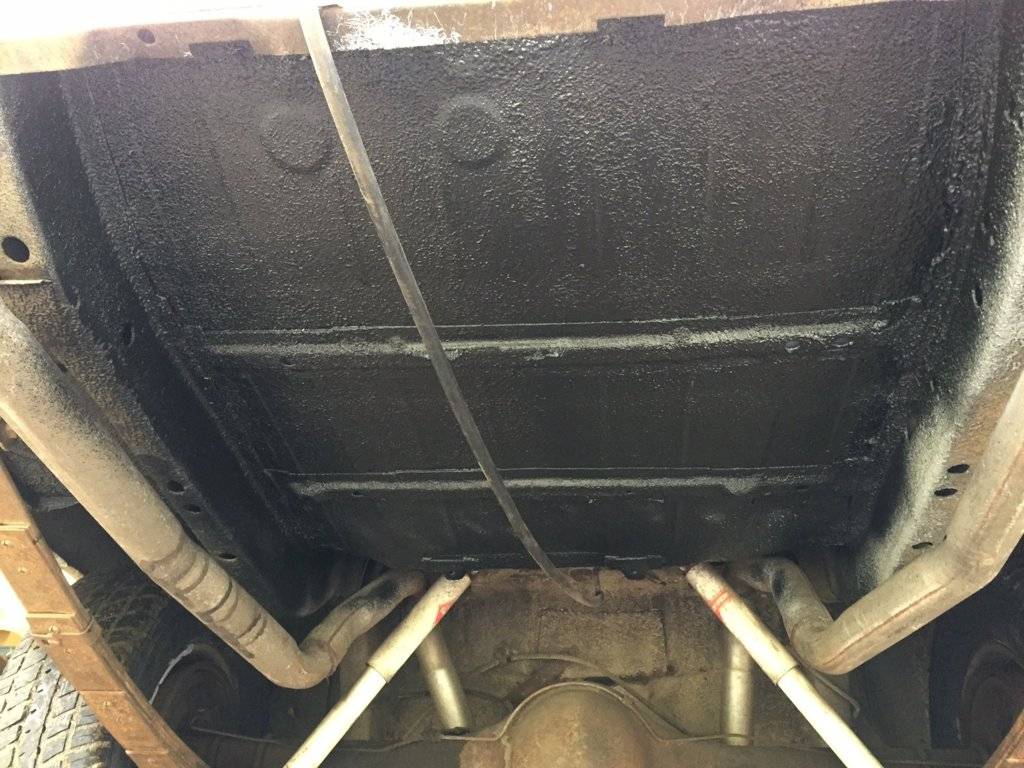

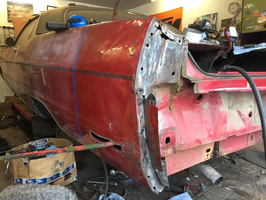

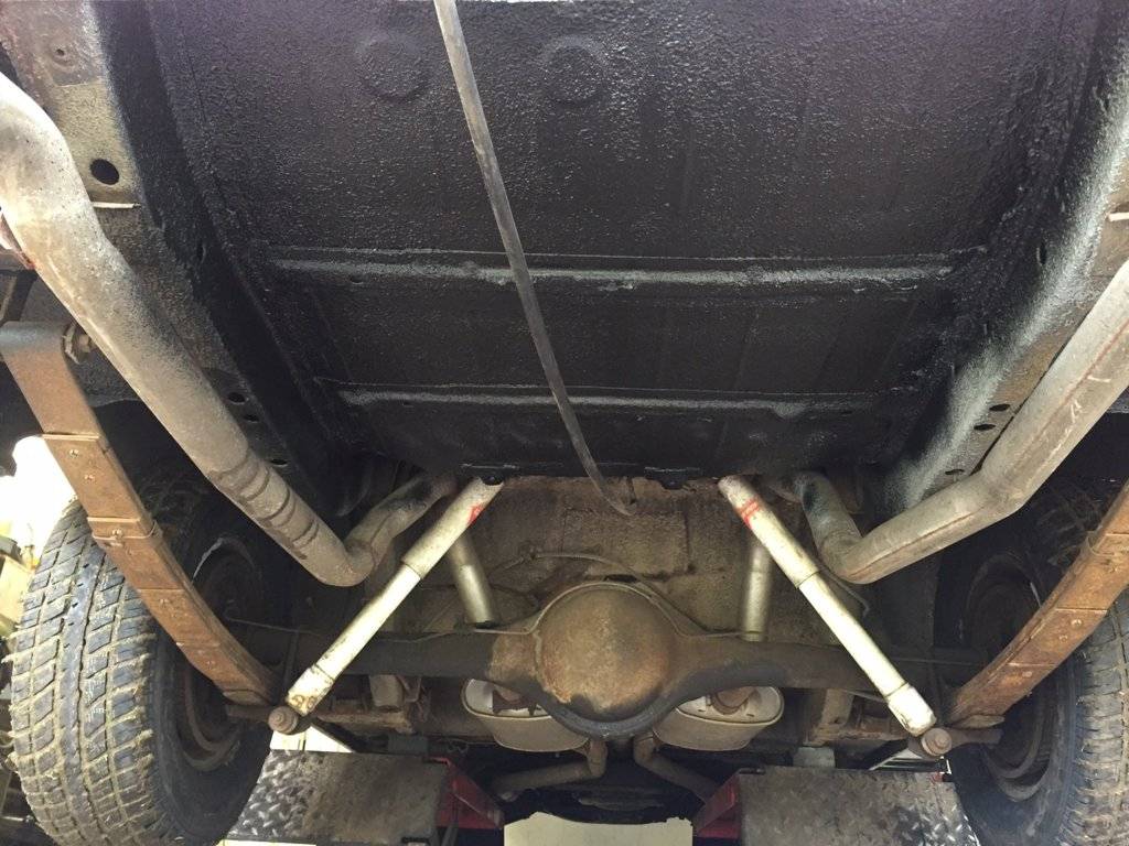

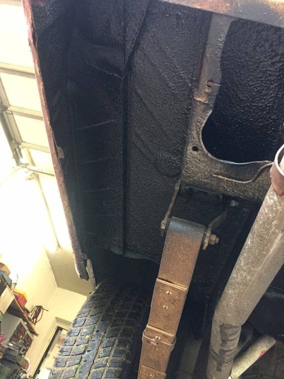

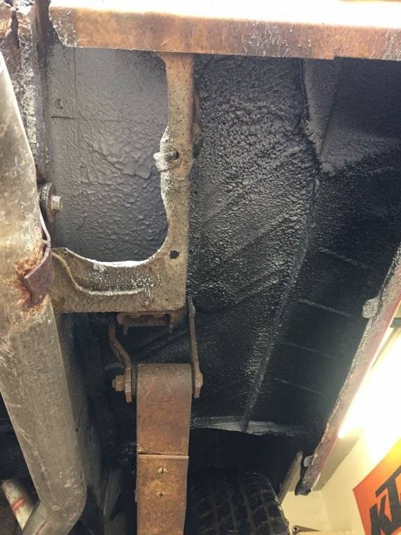

First we cut out the old trunkfloor.
We had some trunkfloor repairmetal from Goodmark (from back in the day).
Poor quality pieces.
We had to adjust a lot and fabricate some metal to make it fit

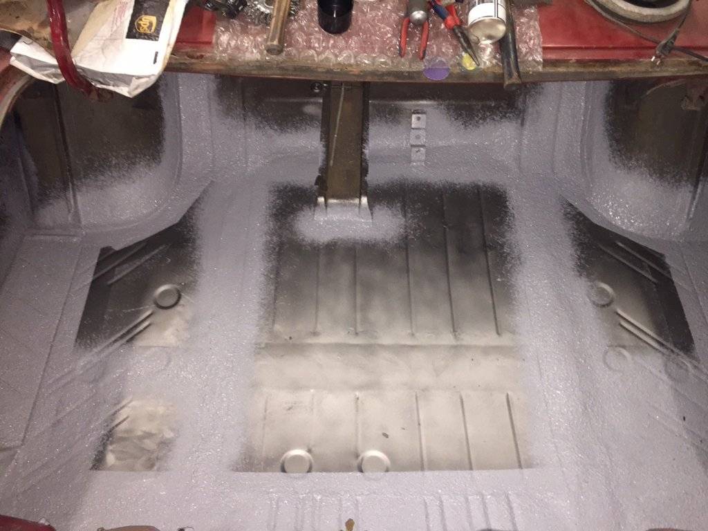

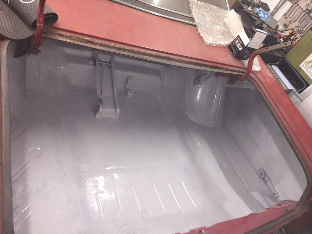

after that we sealed the seams
followed by primer
and we put sprinkle over it

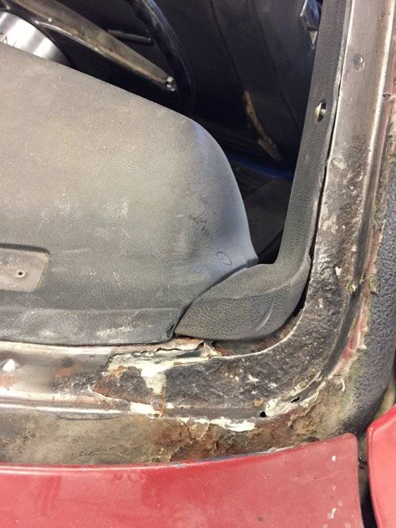

Front windshield was cracked so we removed it and found rust of course
But it wasn't bad so we only had to weld three small holes.

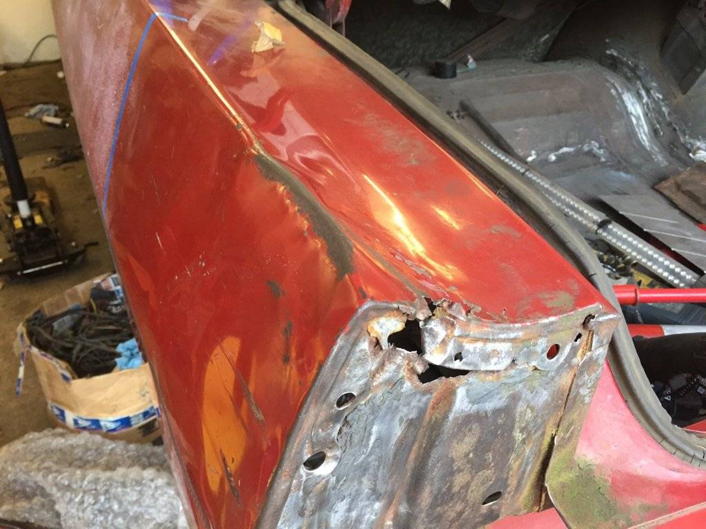

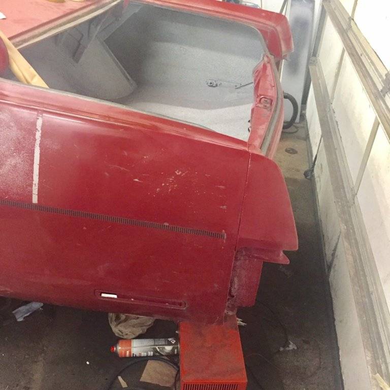

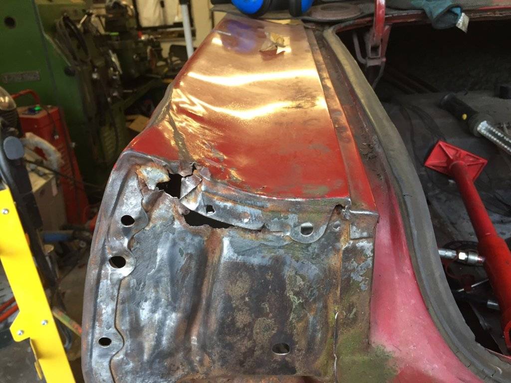

It was important for me to safe the old quarterpanel and paint

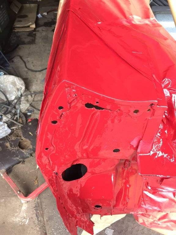

prepaing for paint (as tiny as posible) we didn't use any bondo to straighten it. It is of course still slightly waivy but all metal, no bondo
and painting
