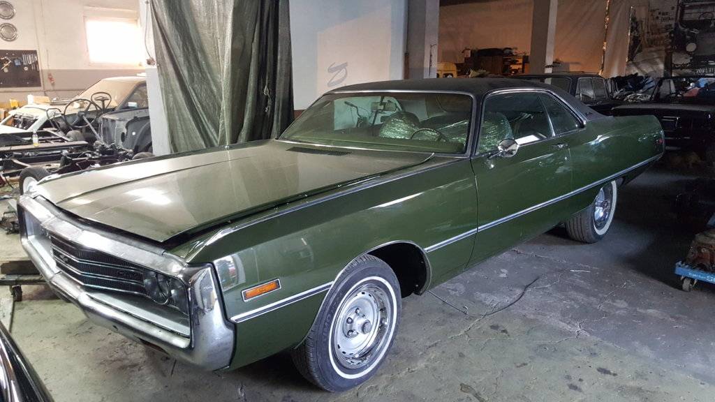

would like to share my experience of giving my Chrysler a rebuild in Poland.

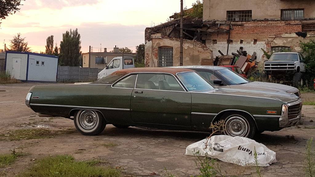

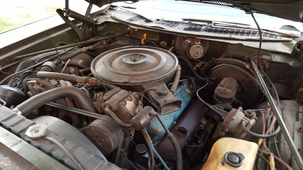

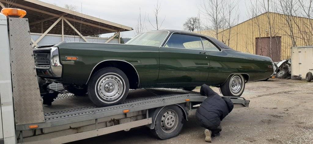

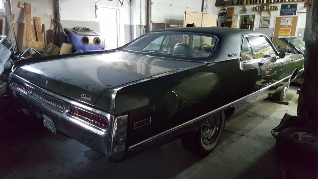

The car was imported to Poland in 2017 by a trader. Bought by me in August 2018 in running condition. The reason i bought it here instead of the US was that i could verify the condition of the car - mostly the rust involved. This one was not bad, and all original, no body or paint work ever performed - a BIG advantage. All the bits were on the car (except for the trim on the front grill). It's a 383 2bbl. Drives nice , engine & trans in good order (however on idle for a longer period of time the oil light flashes) . Suspension ok, steering bad - very loose - probably shot bushings all around and the steering box needs a rebuild. Brakes good.
This is the one:
For Sale - 1971 Chrysler Newport Custom - 383 V8 - $4000 (Linden)
Anyhow, i'm having the car rebuilt.

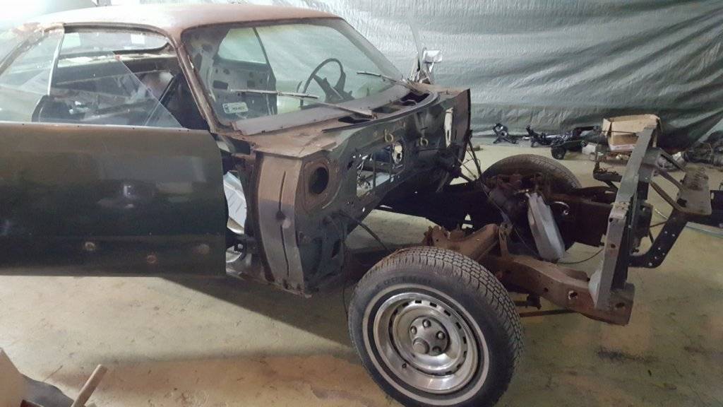

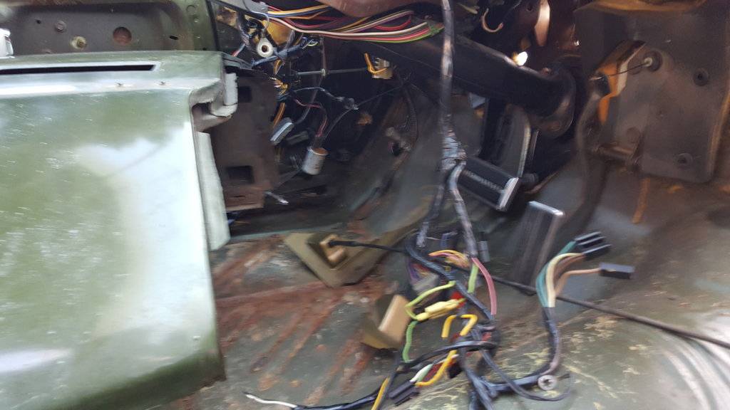

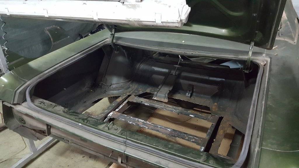

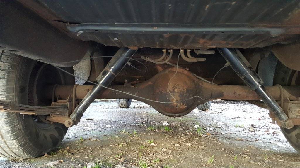

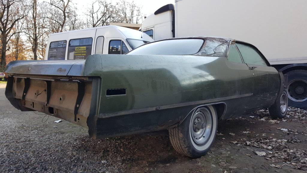

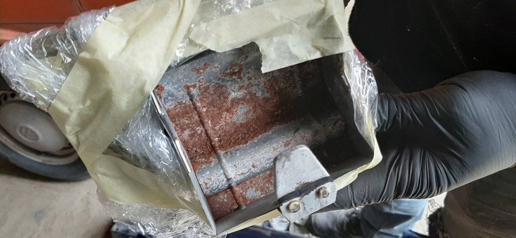

Body work, paint, interior, engine rebuild, new suspension, brakes, steering, brake lines, fuel lines, fuel tank.... well, basically everything. The trunk floor was in poor condition - but not from driving and salt - rather water laying on the floor. Quarter panels need some work on the bottom, as well as front fenders just behind the wheel wells. Other than that, the body is in excellent condition. Before i had the car taken apart, i ordered the floors from c2c fabrication - and the only bit im using is the trunk floor... which is a very pleasant surprise!
The plan is to keep the car in original spec, it's probably going to get the same color, Chrysler Avocado Metallic - GF9 code.

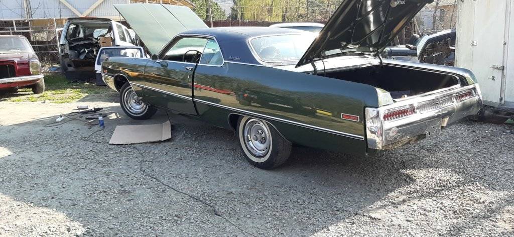

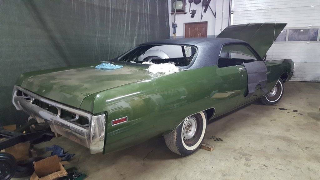

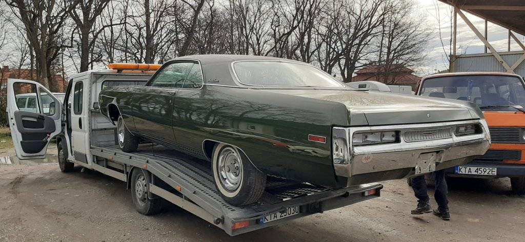

Getting there :)
Need the glass to go in, rest of the trim, interior. Then the car will be off to the mechanic for the engine, fuel and brakes lines, exhaust. All the bits that are going back on the car are rebuilt, like new... the body shop is doing an excellent job!
For now, the front and rear bumper won't get rechromed, I'll do it next winter.

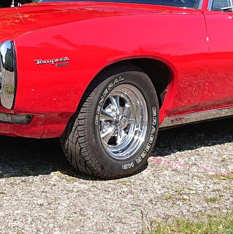

I had BF Goodrich on m my car but never had a clue why they're so expensive.. If you want to have white letters I can recommend General Grabbers... General Tires is from UK I think, so you might save a few bucks on shipping.
@Elcaine has them on his SportFury, looks decent on a fuselage 1970 Plymouth Sport Fury

Sidewall on General Grabbers is ok for me, but I have to admit I don't like the looks of the tread pattern. But, they do well in the rain. I only have them on the rear, front tires are General Altimax.

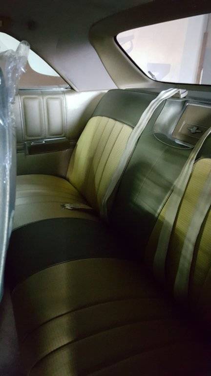

Great restoration — thank you for posting about your experience! The seats look perfect, can you tell us more?

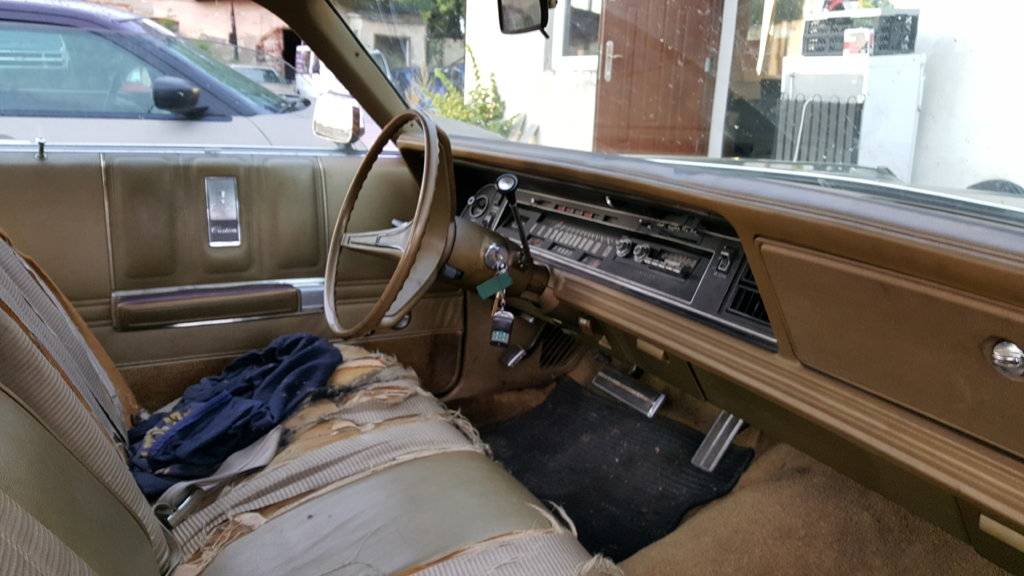

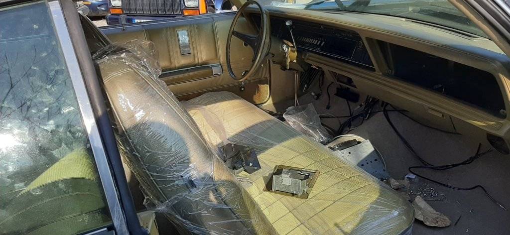

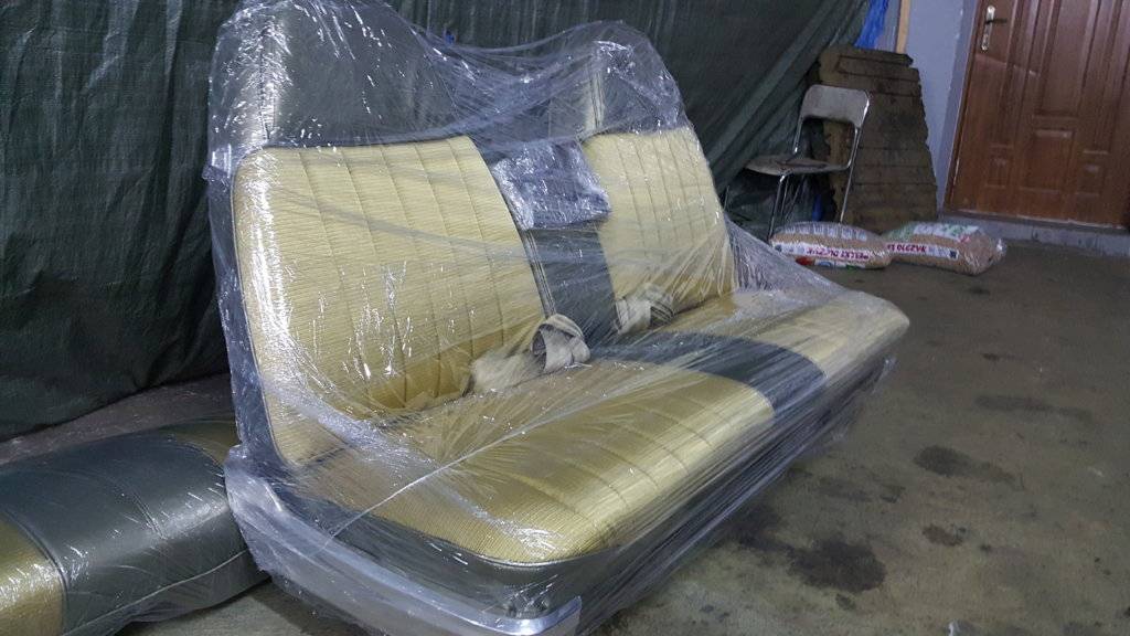

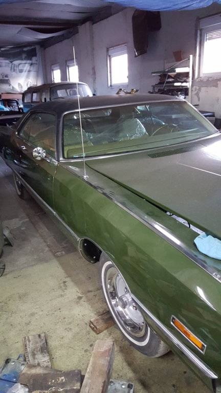

The seats were upholstered in the correct material (except for the vinyl - used similar generic). They were fully rebuild - new foam, springs, etc. For all the work the price was really honest.

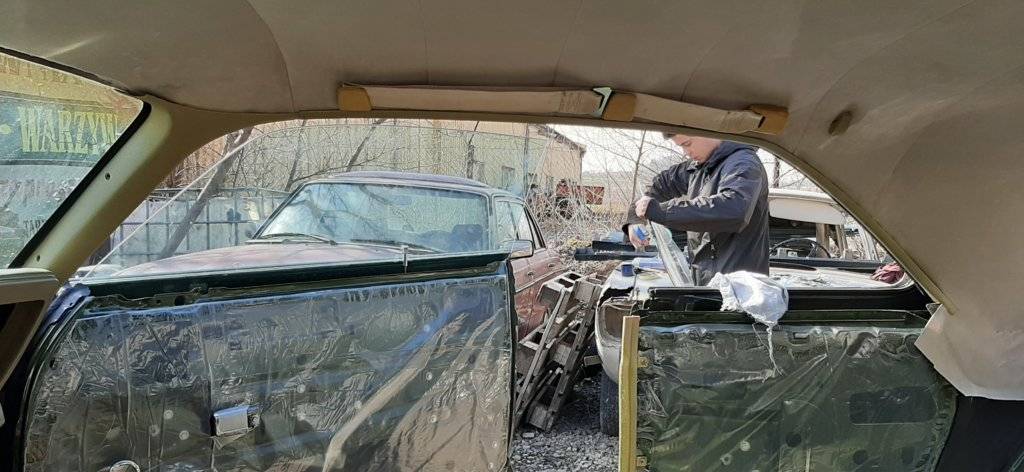

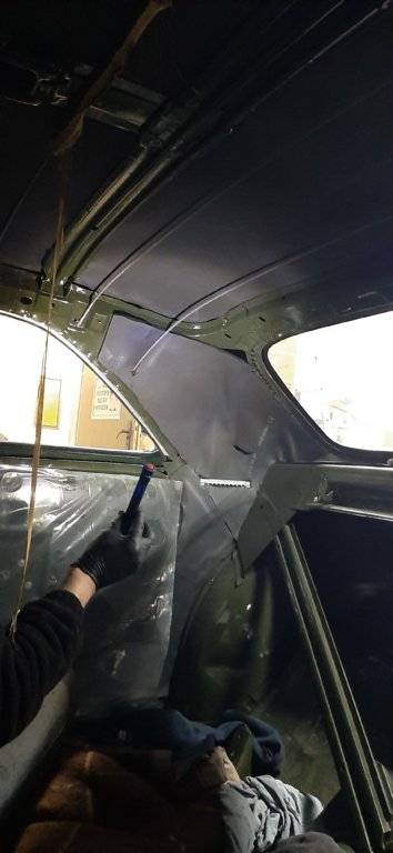

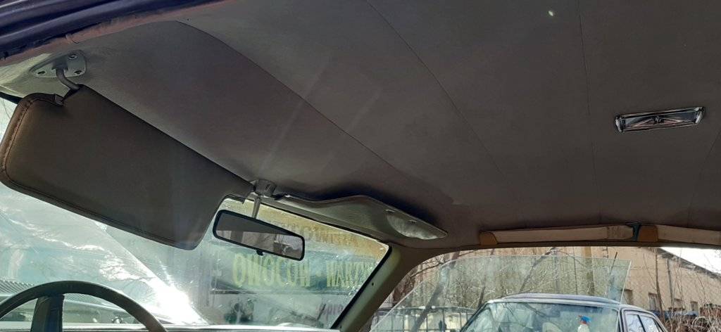

Recently had the windows go in, weatherstripping and chrome bits, the inside of the body was insulated (roof, floor, firewall, rear pillars, everything basically) for better temperature and sound control. All the panels and crevices on the inside were also rust proofed beforehand. A new headliner has been put in - i know the color is bright beige - but i wanted the interior not to be so dark, same goes with the carpets - bright beige.

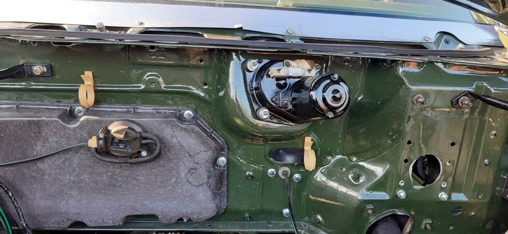

At this point in time the body is almost finished. The interior has to go in as well as the side body moldings. Everything has been rebuilt, heater core, wiper motor, fan etc... really like new. I cannot express my gratitude for the body shop which is doing the work. Really amazing stuff goes on in there. I must say if i had the car elsewhere i just wouldn't be able to get all the work done.

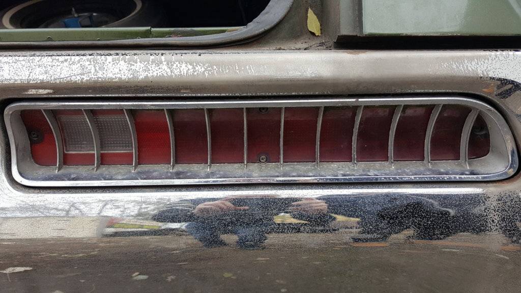

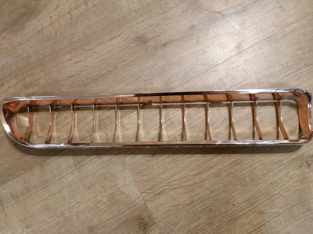

The rear chrome covers for the lenses were in horrible condition, but the body shop had a place which managed to get them refurbished - now they are ready for re-chroming. Amazing really.

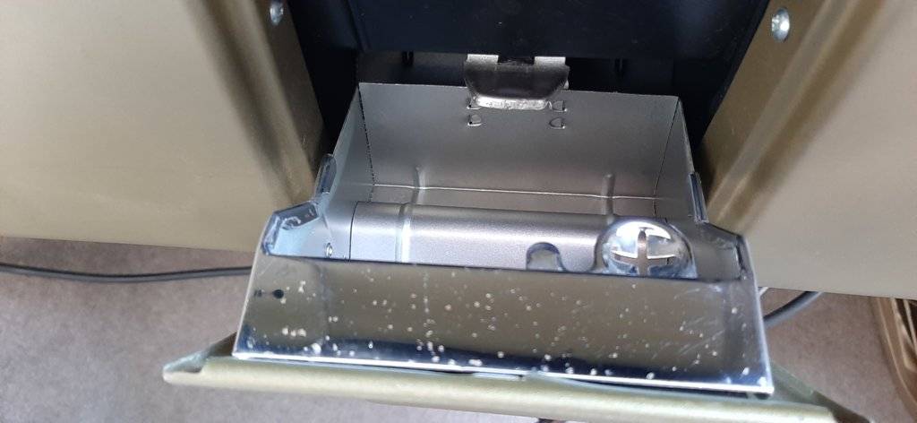

How in the world did you sanitize and beautify that ashtray?
i believe it was sandblasted by one of those small precise blasters that aerograph painters use, then painted in silver.

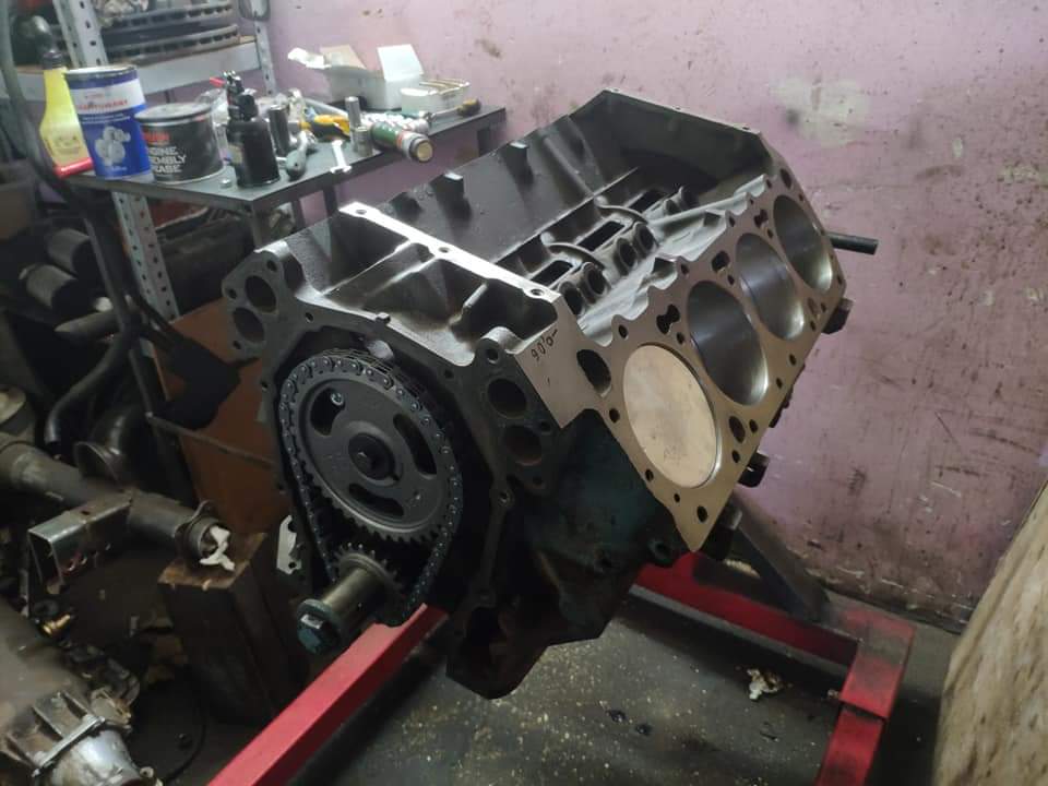

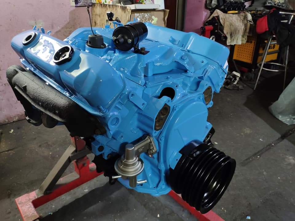

Engine is done. All internals are new, except for crankshaft.
