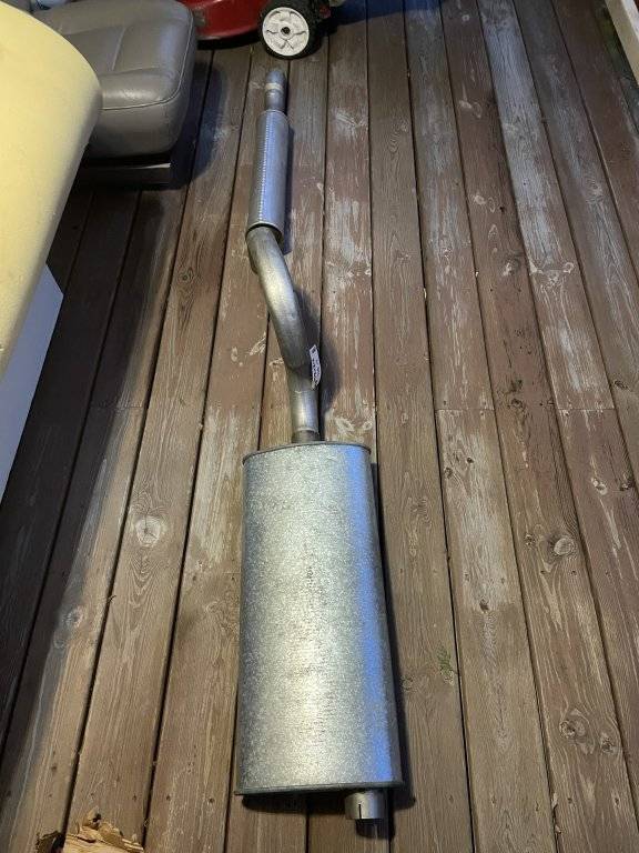

NOS exhaust parts are here. I hope to rebuild the carburetor this weekend and get it started. Carburetor kit should be here tomorrow. I have a couple parts carburetors that I can use as well.

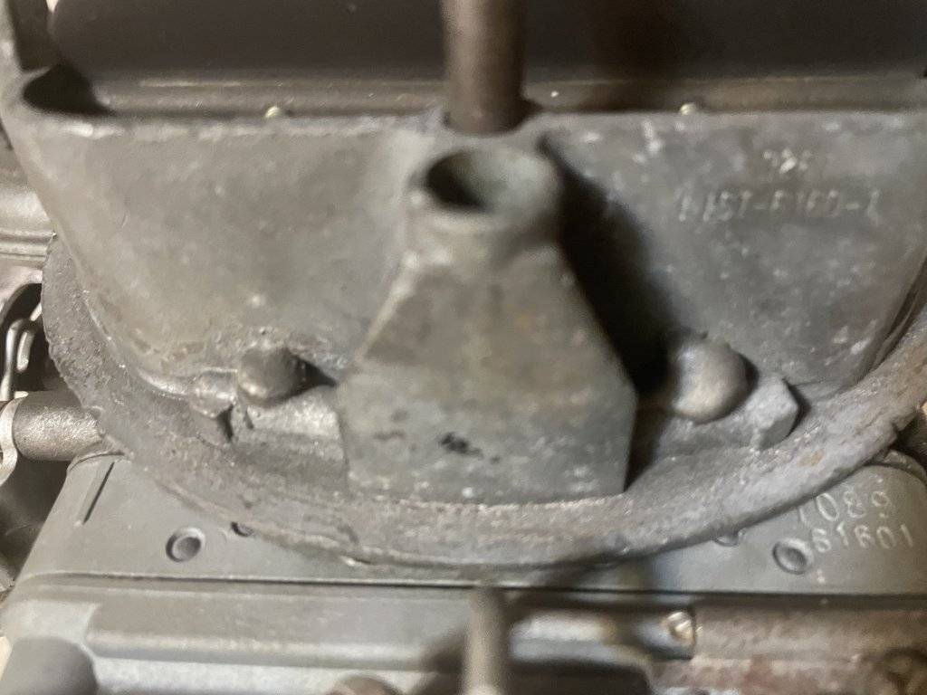

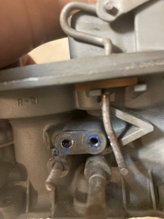

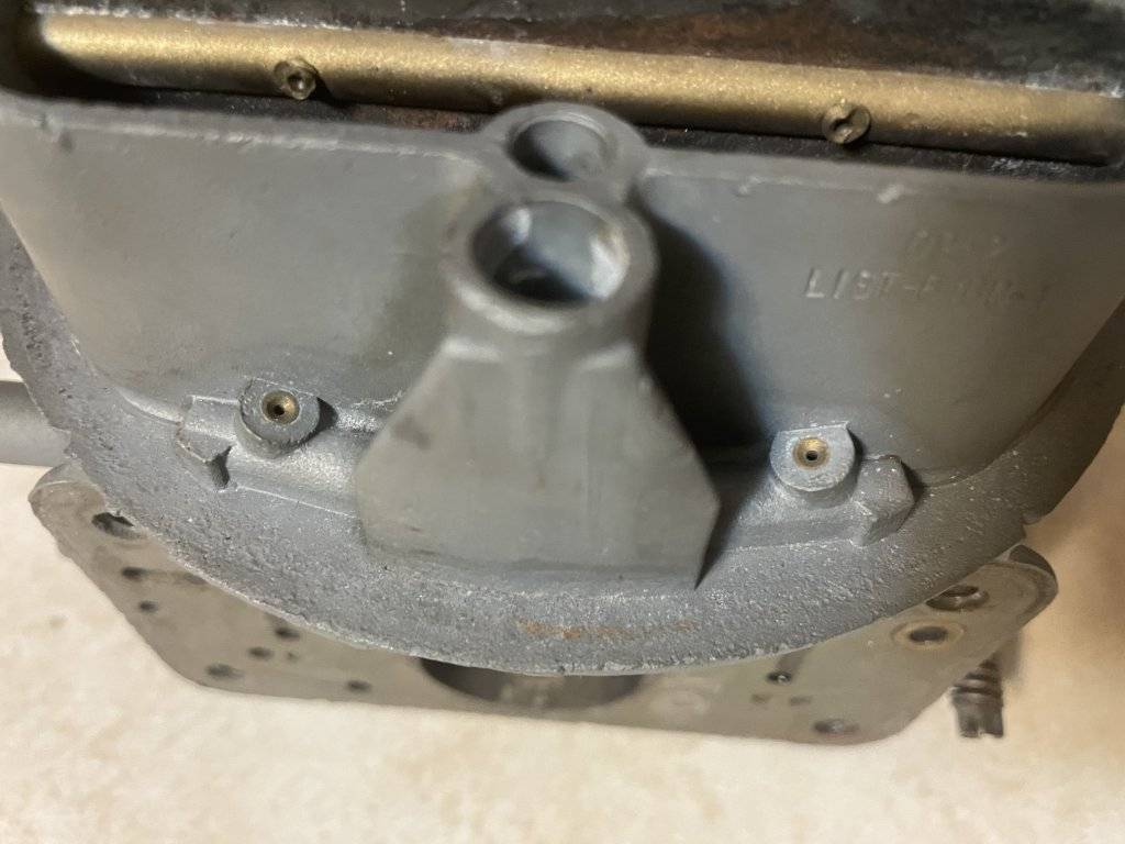

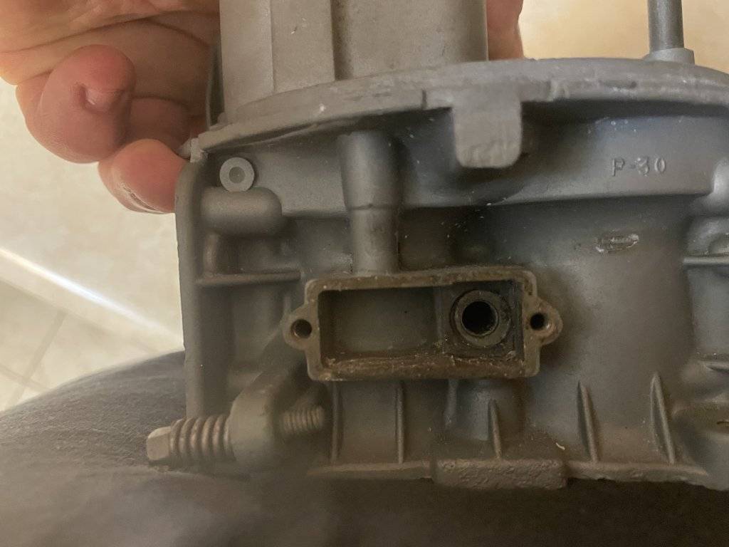

I am stuck with two carburetors I am not happy with. One some do his converted to mechanical secondaries and decided it would be a good idea to put RTV is the secondary diaphragm oriface. The other some other dingus brazed over some air bleeds on the primaries and the hot-idle compensator valve hole. I’m not happy. The original carburetor was corroded beyond repair.

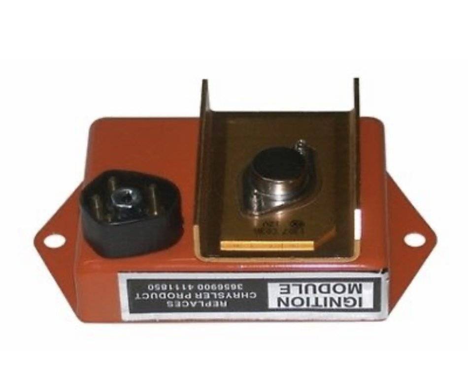

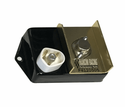

So I have power to the ECU but no power coming out of it. Brand new and it’s garbage. I am disgusted that I have to do this again. I really want to get a Rev-n-nator but they are out of stock. This thing is not worth the first penny.

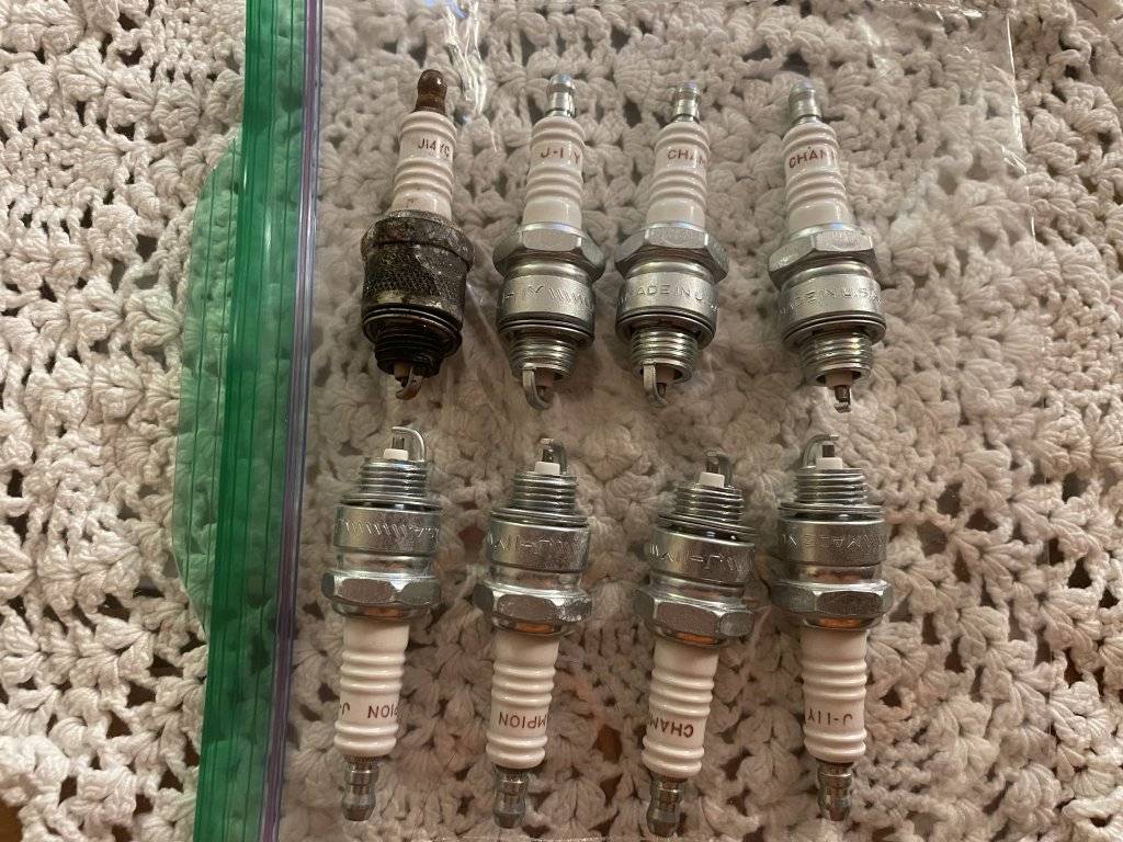

I got an ECU that is more subtle and looks closer to the original. I really am going to put NOS Champion J11Y spark plugs in the engine. I pulled one plug and it was tan. Looks like this car was running yesterday!
It’s too cold, too dark and too late to do the other 7 cylinders. I will have to wait for the weekend.

Those 4160 Holley carburetors were notoriously bad. 1972 was the last year Chrysler used them - for good reason. The metering blocks warp over time (about 20K miles). Most rebuilders won't touch them. You would be far better off with a new/modern comparable Holley 4 bbl. The current ones have quality castings whereas the original ones did not. The new ones are relatively expensive but you would likely be money ahead to just get a new one than try to rebuild that one.
Those 4160 Holley carburetors were notoriously bad. 1972 was the last year Chrysler used them - for good reason. The metering blocks warp over time (about 20K miles). Most rebuilders won't touch them. You would be far better off with a new Holley comparable Holley. The current ones have quality castings whereas the original ones did not. The new ones are relatively expensive but you would likely be money ahead to just get a new one than try to rebuild that one.
It’s already rebuilt. If I have any issues I will just order a new one anyways. It’s worth a shot to get the car running.

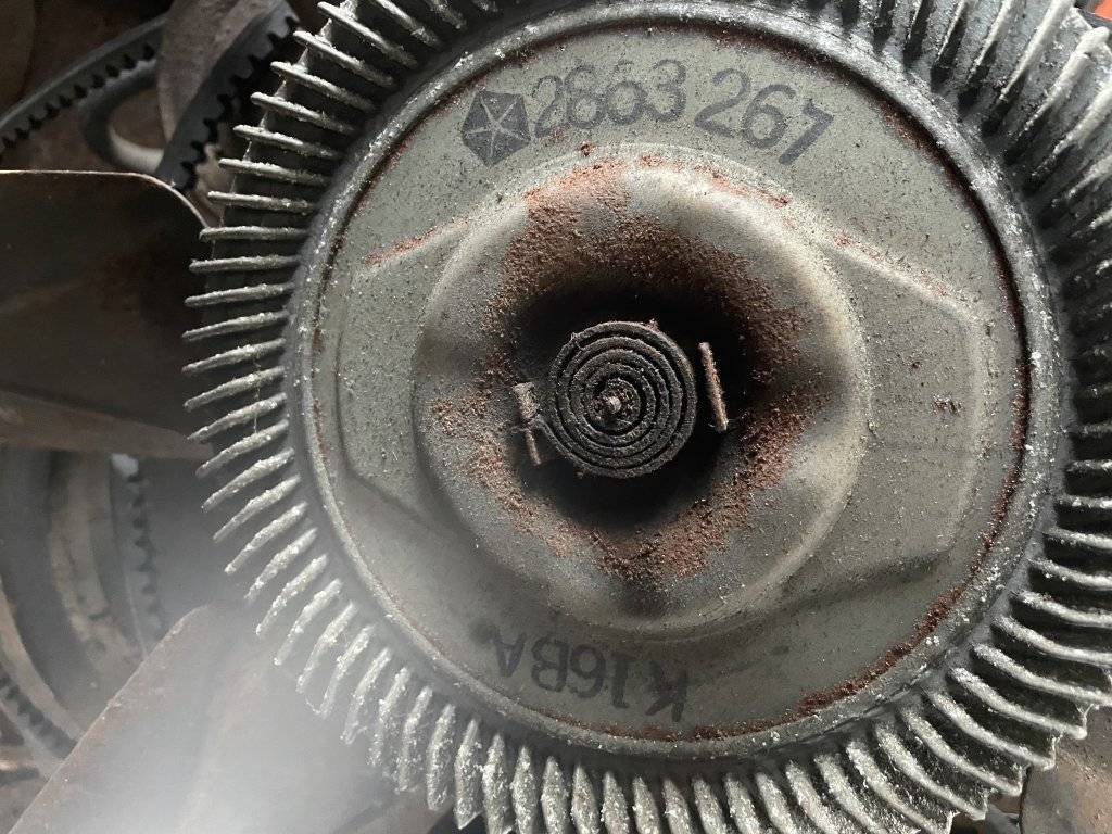

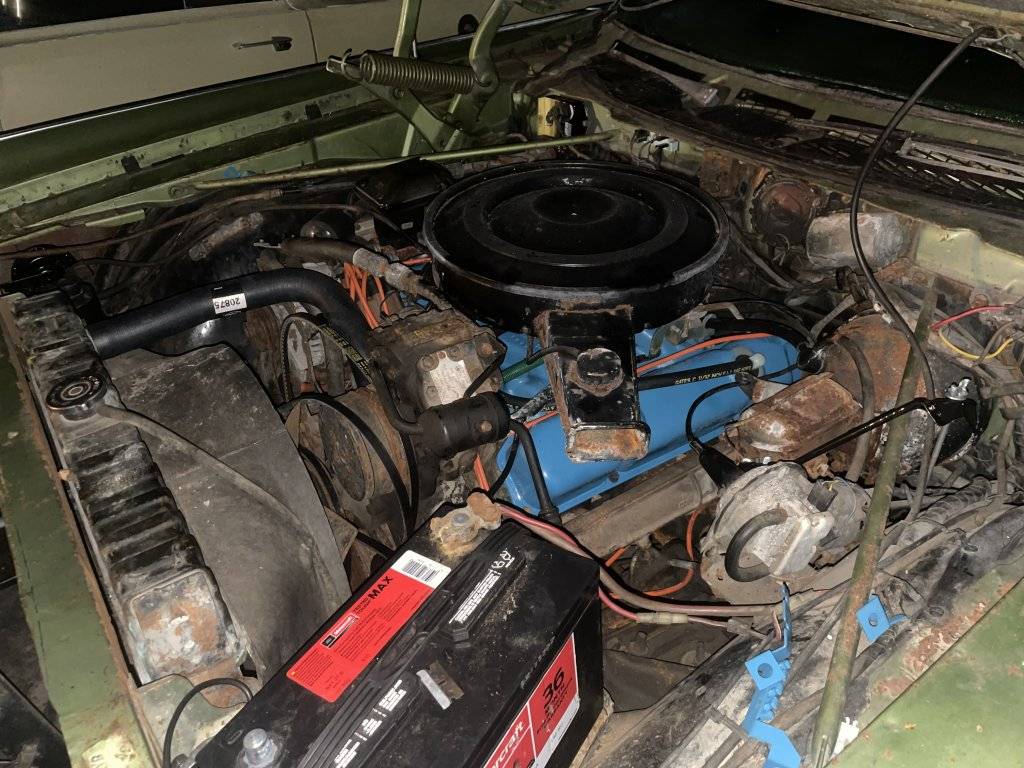

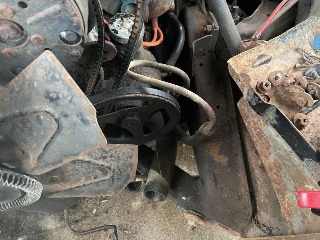

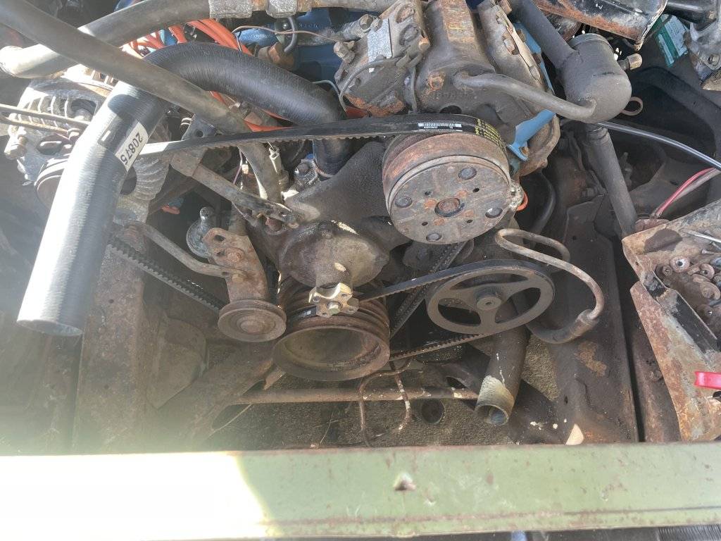

Some details from the engine. The fan clutch is original and still good. Time to get the pulleys out and confirm TDC and the #1 spark plug wire. The car came with an extra set of pulleys that I will clean and paint.

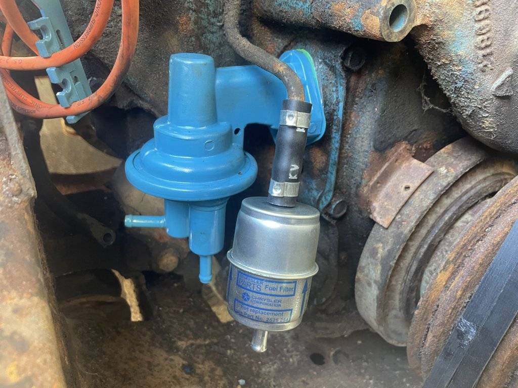

The alternator was sent out for a rebuild and the original fuel pump was still good but I replaced it anyways. All the parts I pull off are being saved. Power steering pump looks like it is leaking.

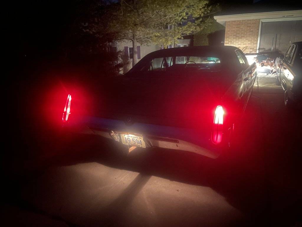

I got the turn signals working. There have been some ground issues with the tail lamps and the right turn signal quit working. I replaced the headlamp switch and the the floodlighting started working. I will be getting the clock and radio working soon.

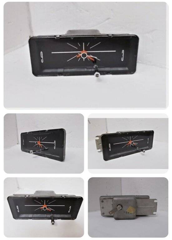

I ordered a clock to replace the one that does not work. Also I am looking for a radio rebuild service so I can send out both of the radios that came with the car.
