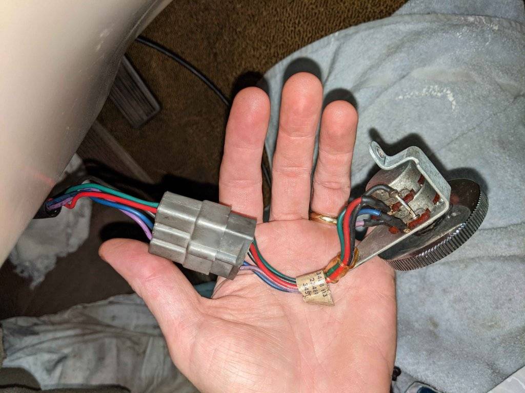

You need the wiring harness including the thumbwheel fader if there is one on the under column panel.
Fader

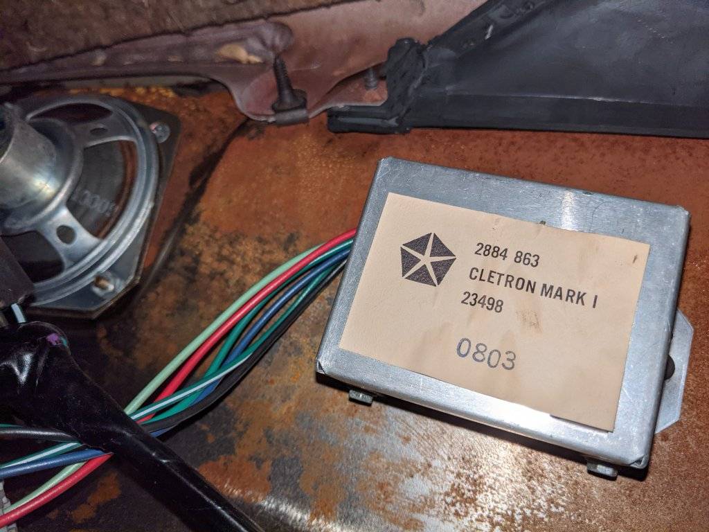

Also, the wiring harness includes this Crossover for running rear speakers. Accessible with glove box removed.
