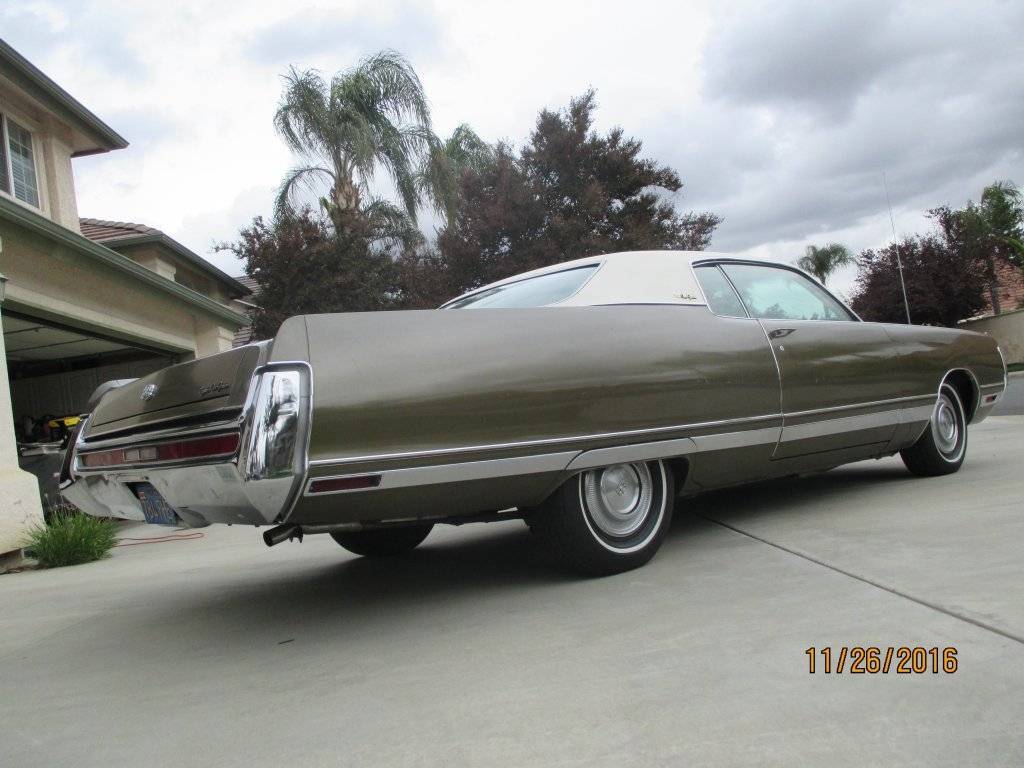

Here are a few that I have found and believe to be original:

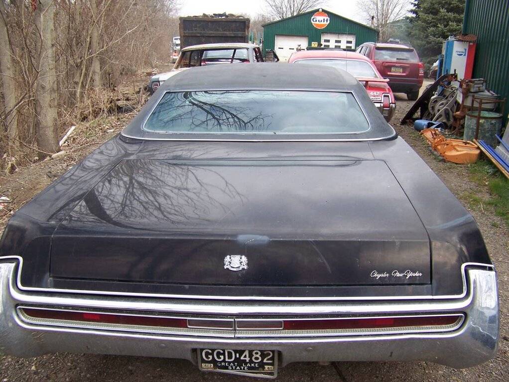

1. Regular NYer (other thread on the same car here in 2016):

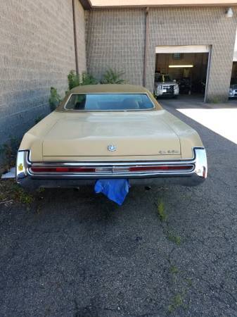

Another one from Michigan in May 2020:

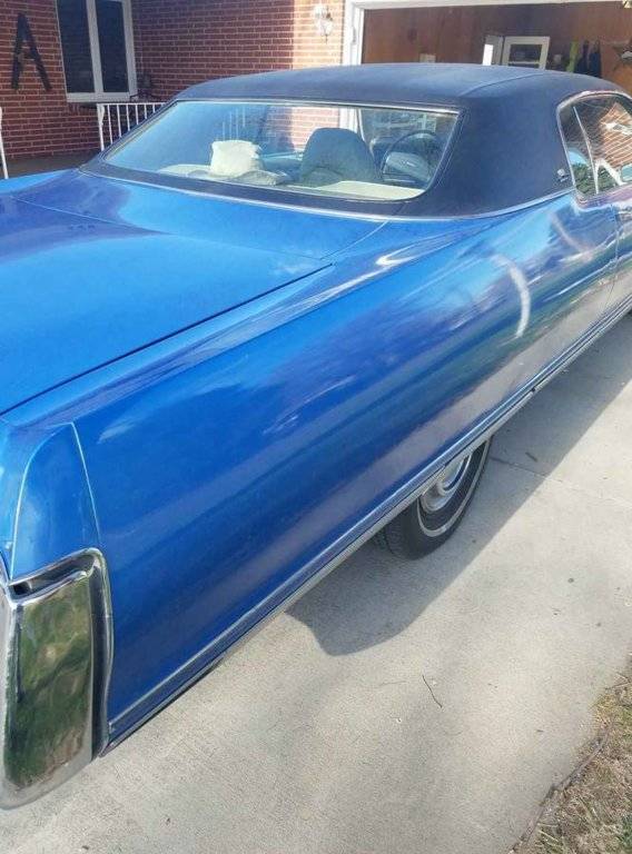

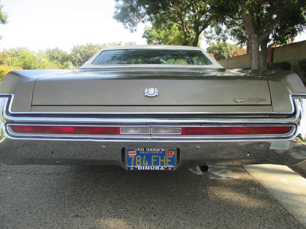

2. NYB:
Here is another one that was for sale in Pittsburgh -- exact same top as mine, BTW:
I am having a very hard time seeing any difference...

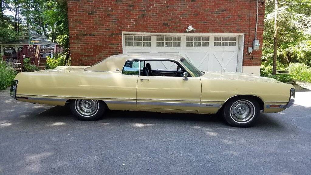

Thank you Lea, that'd be great except the top on mine is gold (V1G code) and I plan to stay original. Here is Buttercup (her skirts are in the garage):

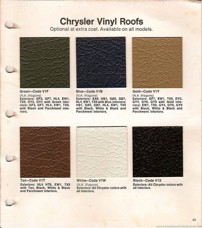

Go to the 1970 Hantramck register website, look up library then in 1972 you'll find information on the available color and trim combinations including vinyl roofs
Hopefully there's enough information to answer your queries there.

Good suggestion, the NY and NYB used the same colors and grain

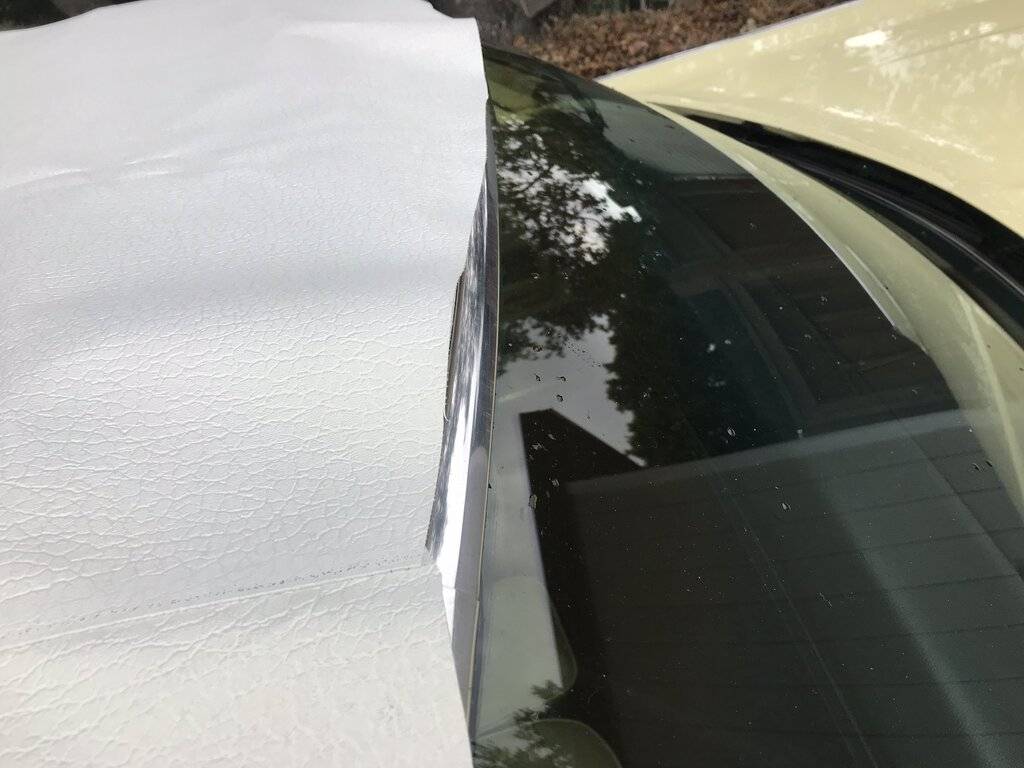

Here are the measurements from my 73 NYB.... prepared exclusively for the fine folks at SMS. All dimensions are to the finished edges.
Thanks a real lot. I have a bunch of questions, for example how did you/they account for the radiuses, do you have pictures of the installation process, and what happened to the old rear window molding?
