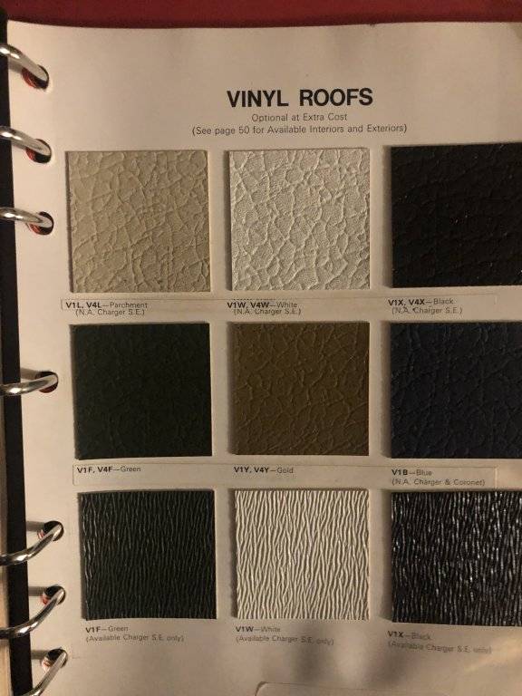

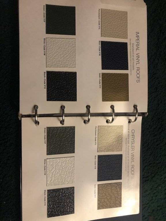

From my 73 Dodge and Chrysler color and trim books. The Imperial is a smaller grain For what it’s worth Topsonline sent me the smaller grain as a sample for my 73 Monaco
From my 73 Dodge and Chrysler color and trim books. The Imperial is a smaller grain For what it’s worth Topsonline sent me the smaller grain as a sample for my 73 Monaco View attachment 628586View attachment 628587
That's so interesting. .The Imperial top is exactly the grain on my vinyl roof and not the Chrysler grain. Wow. And I know my top is original. I will have to research this further. I have literature on this Spring Special. I need to read thru it and see if they make any mention of it . Thanks to all who responded to my post. I always know where to go for good info. Will be interesting to see where this leads.
I just checked tbm3fan posts about his vinyl top. That is the correct grain that I have on my car as well. It's smaller and grainer than the Chrysler sample they sent me.
