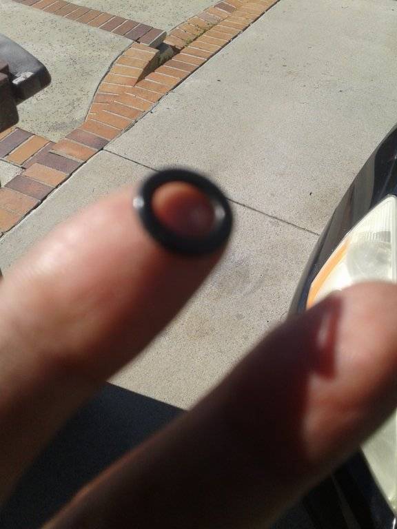

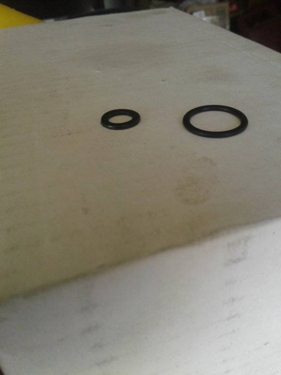

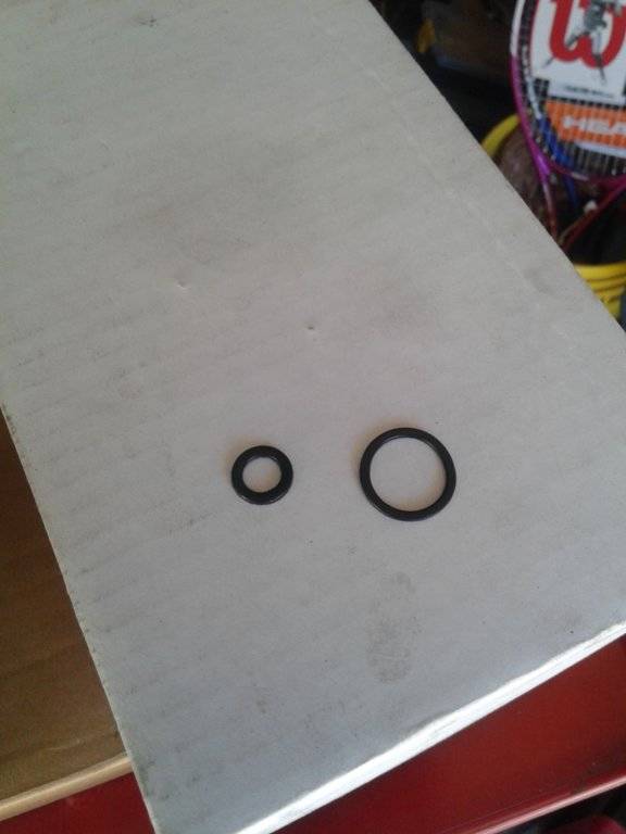

Pulled the valve body from the steering box to replace the o-rings..
I had bought the assortment pack from Harbor Freight. The larger O-ring was a good match but the two smaller ones didn't have a match there.. I tried some that fit but seemed too thin, though they extended a small amount above the deck,,. I tried them and it leaks.. on my way to Home depot and the auto parts to see if I can get a match...
The old ones were quite flattened but fit so exactly into place that I am wondering if they weren't more like flat seals than O-rings...
Anyway, anyone happen to have an exact size? I have seen them online (expensive) but I'm trying to get this done today so other ideas are welcome please

Oh geez.... I went through this 2 yrs. ago. I suggest that you buy the expensive online set. Maybe contact firm feel or somebody. I installed some auto parts store O-rings (twice) and both sets started leaking within a few days. All O-rings are not created equal.
I had to assemble the unit....used two O-ring from the Harbor Freight Kit and resorted to Home Depot (perfect fit)...yes, I know I will order the right ones but for now I need to be able to move the car around without leaking so much...

Take the aluminum piece and the old smashed orings to your local hydraulic hose store and they will get you a pair of quality o-rings in the right diameter and cross section.
