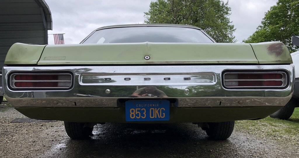

1972 Polara 4 door sedan
Haven't seen a bumper jack used in forever! How many miles you put on her since the rebuild?

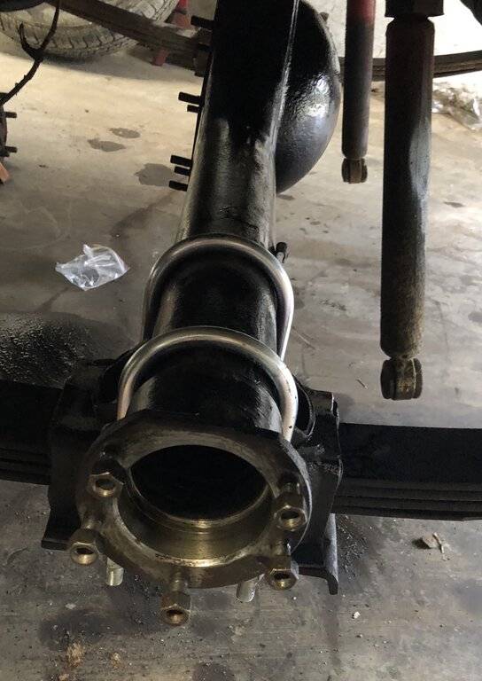

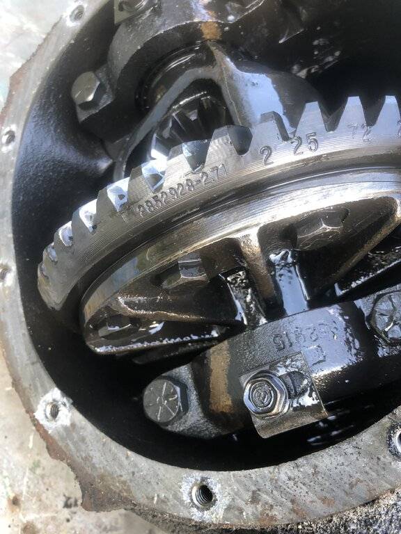

I haven’t been driving my Polara at all for quite some time. Nothing wrong with it, I just parked it one day and drove other stuff for a while. The only thing that bothered me about it was the rear axle. It’s a 8.25 open 2.71 gear and I hated it. I found a housing from a good friend named Wyatt. Y’all might have heard of him,,, anyway, it should be here Friday. So I put the Polara in the garage and dropped the old axle out.
Some might have noticed that I had intended to put a 9.25 axle in this car previously. Long story short, that didn’t go so well. Hopefully this time I’ll be more successful.

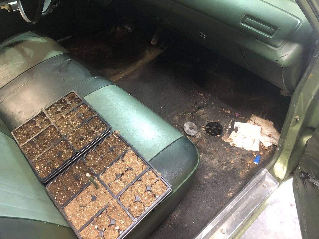

A few months of neglect and the mice have taken over. But I did start some sunflowers and Dragons tounge beans in there! Plus birds enjoy looking in the mirror while taking a crap down the side of my door!

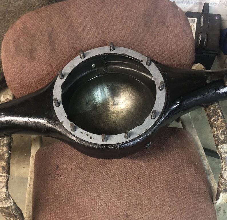

UPS stopped by today..

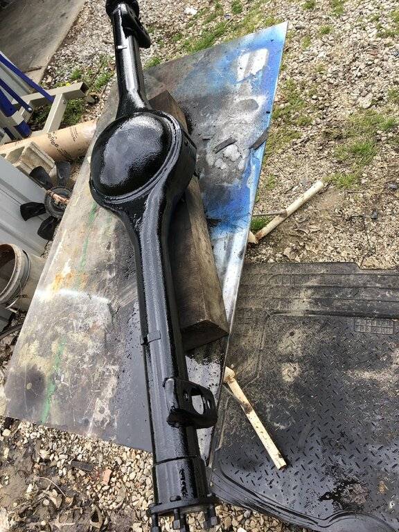

A little modification to the perches, drain plug installed, clean up and paint. Won’t be long now!!

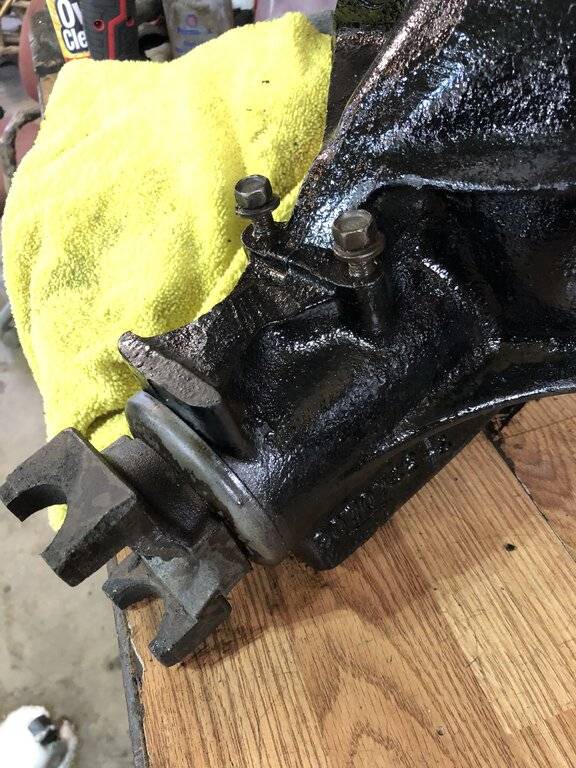

What’s missing here? That’s right. The snubber. I didn’t have one for the 8.75, but the 8.25 has one. In case you don’t know, they are close. But, it’s not a bolt on situation. But maybe I can modify it a little. Plus I’m waiting on the correct yoke. This is the biggun and I need the little un.
A little die grinding of the mounting holes and bench grinding of the area between and it fits. Pretty sure I’ve done this before without an issue.
