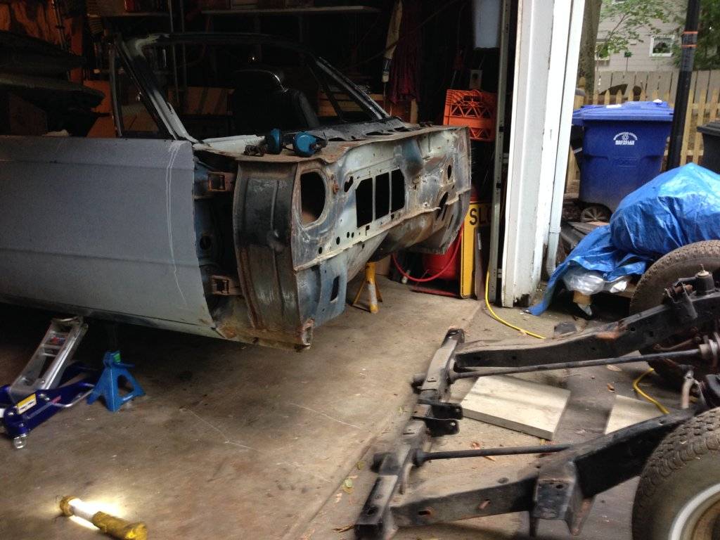

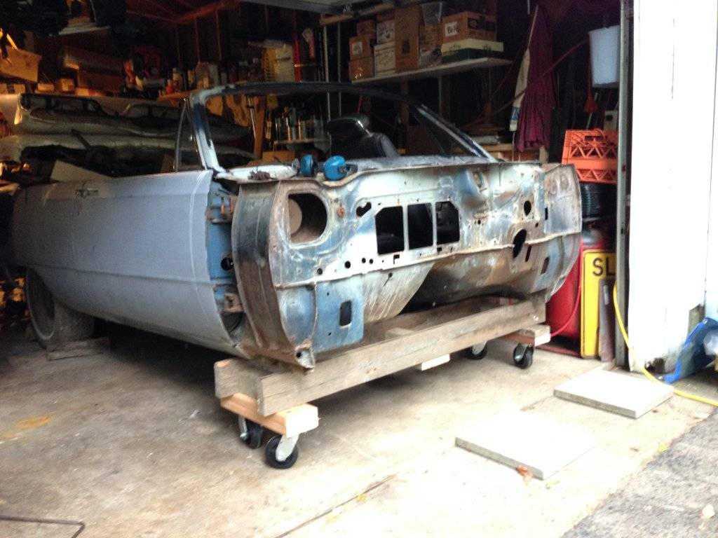

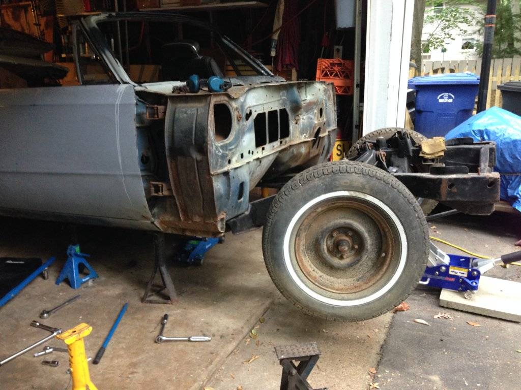

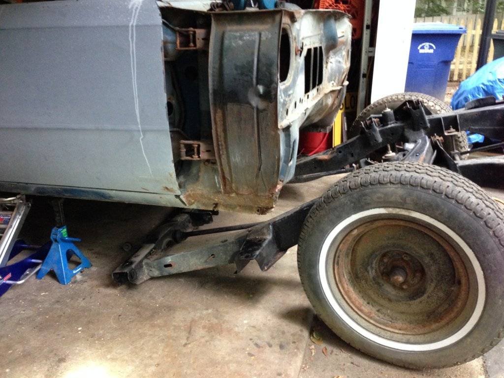

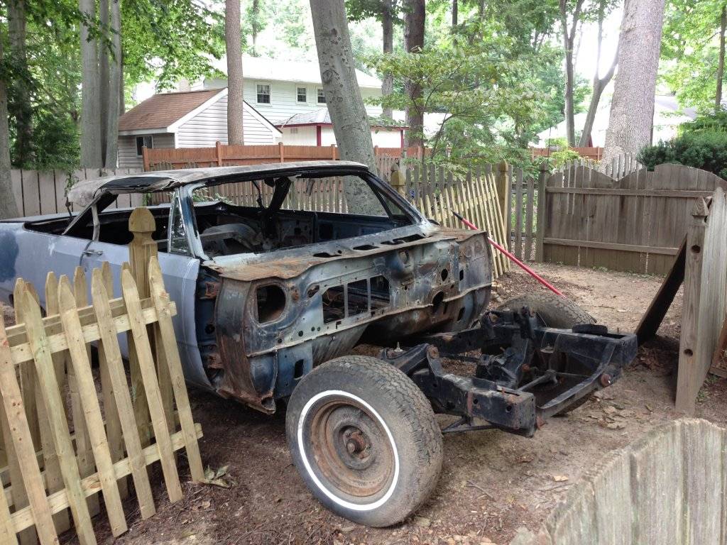

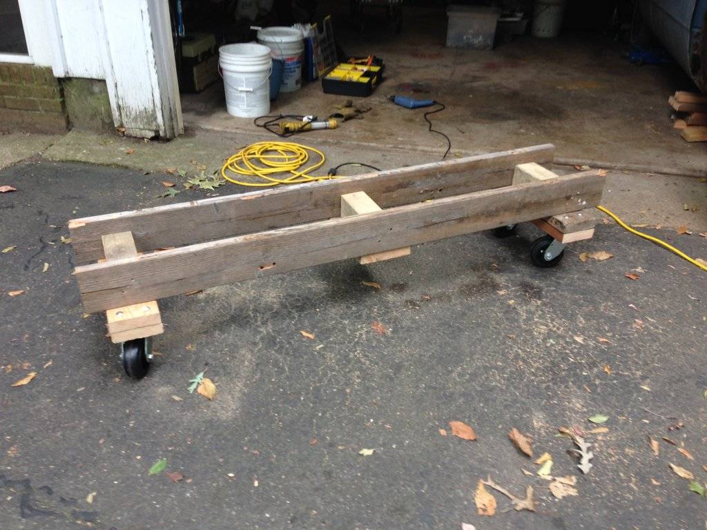

Here is how I did mine. First, strip down the nose, fenders hood, rad support, etc.
Then build a rolling support that will span the pinchwelds of the car.
Next support the front with Jack stands at the pinchwelds, and also by the stub frame.
Then remove the bolts supporting the stub and lower the frame down.
Roll the frame away.
Roll the support structure under, Jack the support up to remove the stands and you are done.

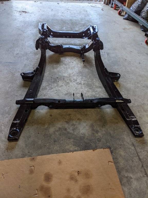

Sure, it’s a work in progress. Here is the thread. I still have to update the rest of last year’s work.
Resurrection of my 1970 Chrysler 300 Convertible

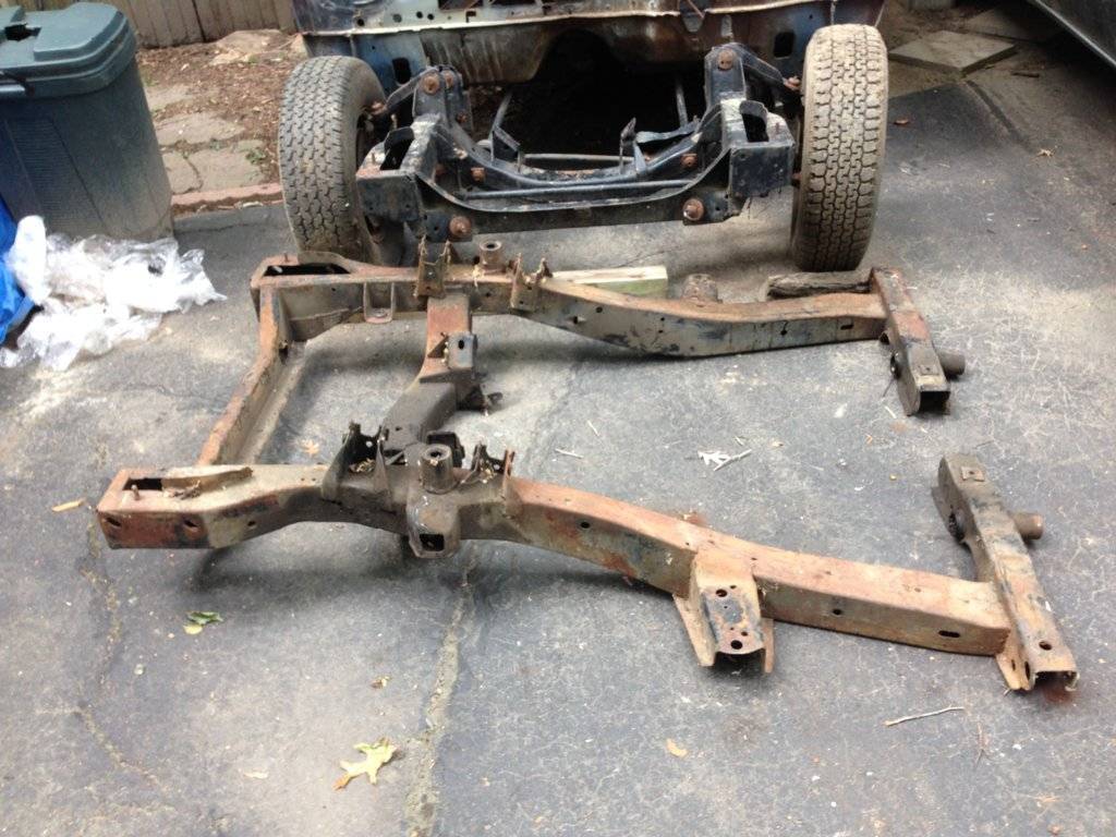

Good question. The frame that is in my car now is actually from a 1969 Dodge Polara. These are solid mount frames, no rubber isolators that are found on ‘70-‘73 hardtops. There is a great thread on here that dives into great detail about the differences between solid mount and torsion quiet, just do a search on “sub (stub) frame” and it should come up.
Back to the question, I have studied many pictures of frames and looked at different FSM measurements and I see no difference in the actual mounting from year to year. However, I do know that there are subtle differences in how accessories are attached, the way the fuel line is routed and the way the emergency brake cable is mounted. It didn’t require a great deal of mods, just drove me nuts thinking I had the wrong parts. I’ve detailed some of these issues in my thread. Best thing to do is spend some time at the next Chrysler Nationals, and get under some cars with a tape measure and your camera and start documenting, that’s what I did (with the owners permission of course). Good luck!

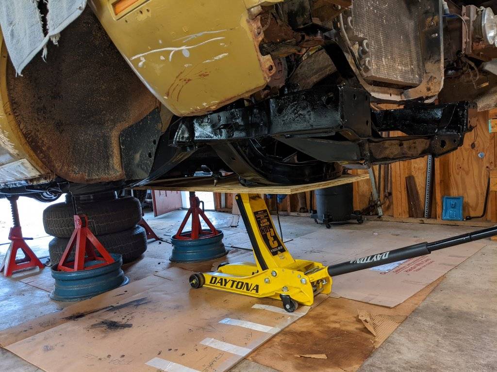

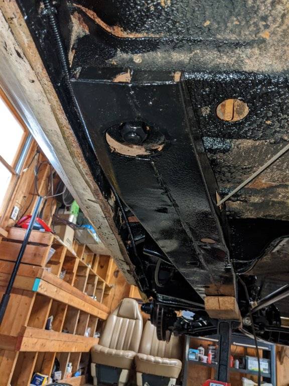

Kenyon: to answer your question, for my 1971 Fury, I installed the Isolated subframe with fenders, radiator support, and hood still in place.
My 1971 Plymouth Isolated subframe. Rear mounts
Borrowed this non-isolated subframe pic from @Samplingman thread mentioned above
See, no rear mounts. Does not need the rear mounts because it is tight with no isolators.
I used a board and hydraulic jack to lift my isolated subframe
I hope that helps with your questions

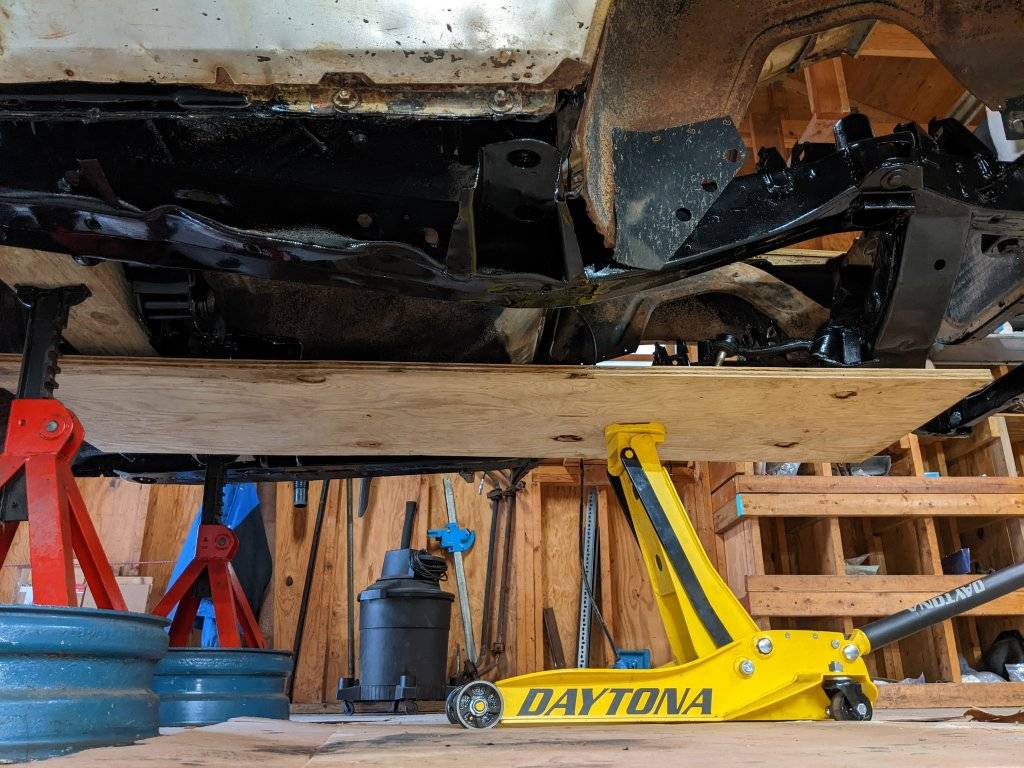

That adds questions.
What I think that I see in the photo is:
1. Body and all non-subframe components hanging in space, cantelevered off of the body shell. Where does it all fasten? Through the fenders? Did you leave the bumper on? Those things weigh as much as three wives, so that can't be.
2. 4 jackstands supporting the body shell, with a 4x6 distributing the load on the floor up front, and the pinchwelds in back while some tires or wheels do something mysterious in the center - surely you were not insane and left the transmission in, no, it could not be THAT. What job are the tires doing?
3. Plywood skid used to jack-lift the freshly painted subframe into place for re-fastening.

it fastens at 4 places under the body shell floor and at 2 places under the radiator support panel. The bumper fastens to the subframe via the brackets. I removed the grill and bumper as a unit before removing the subframe.
You can call the tires a safety measure, but you could also call them a storage area. I removed the transmission and engine before removing the subframe. I also removed the suspension before removing the subframe. The jacks are under the rear subframe and under a small crossmember that supports the front floor.
