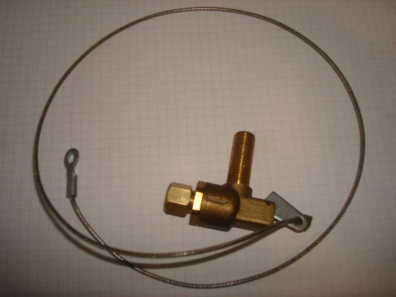

Yeah drove my fair share of cabover **** speaders to enjoy that lanyard. The all metal interior ensures that the driver does not survive to contradict the DOT assement of the accident.
