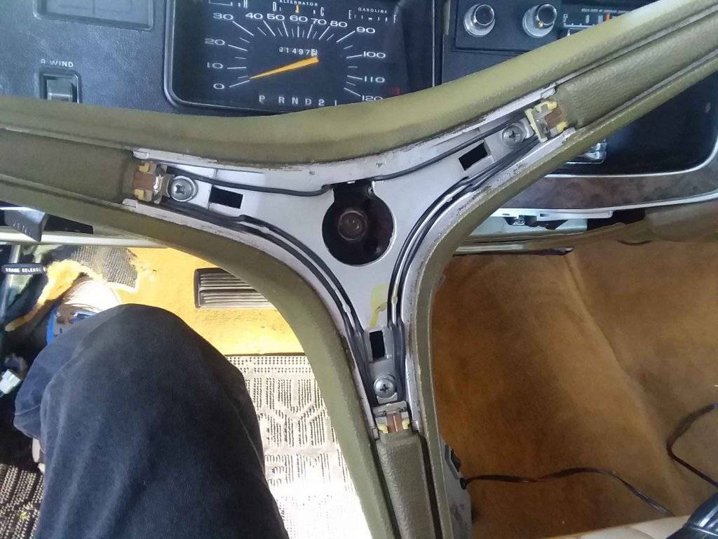

At first I assume buy pushing the triangle on the steering wheel it should honk, right? (never worked when I got the car) (Picture 1)
I am down chasing the problem probably back to the steering wheel. Checked all Continuity by chasing the wiring with the FSM wiring diagrams. Checked the horns with a battery (works loud and clear). Got a new NOS Horn/KeyBuzzer relay -> Key Buzzer works excellently!

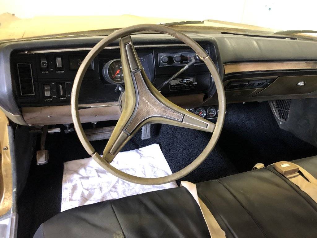

I assume the to activate the horn the two contacts (red and black cable) inside the steering wheel will get together by pushing the horn button right? (2nd pic) . That means the red cable coming from the TSS through the copper ring on the wheel ; and the black cable thats attached on the column ground right?

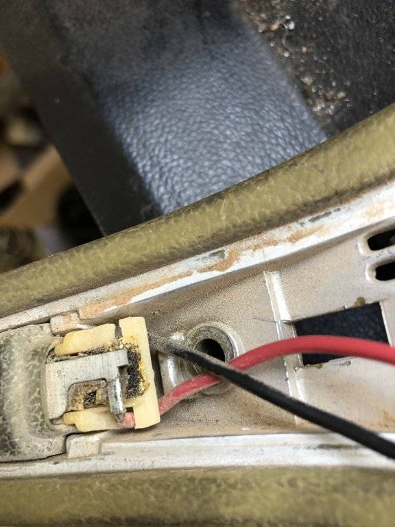

Right now the horn button is off and if i want to honk by connecting red and black via the contacts shown on pic 3 nothing works.

Do all of the three corners of the horn button have to be pushed simultaneously to activate the horn or is one corner of the triangle enough? (Because on one of the three the cable is off)

There are no "hot" or live wires in the horn buttons.
The buttons are grounds that complete tge circuit when pressed.
The 3 buttons you have are known to be problematic.
You do not need to press all 3 to activate horn.
If you unhook the button harness and then touch the steering column with the main feed wire going to the buttons the horn should blow.
If so, replace the buttons.

Should be a black wire going up into the column that connects to the black wires of the 3 buttons.
Remember body is ground so any metal surfaces in the column you can touch like the nut that holds the steering wheel to the column for example.
Even if you use a jumper wire to touch metal to diagnose horn operation.
The contacts at the buttons typically corrode.

the centre triangular pad is not the horn button, any of the 3 rectangular buttons at the ends of the triangle are what you press for the horn

That’s why I asked that simple question :) I was actually wondering why I couldn’t find any spring below the buttons?! How do they come back after pushing ?

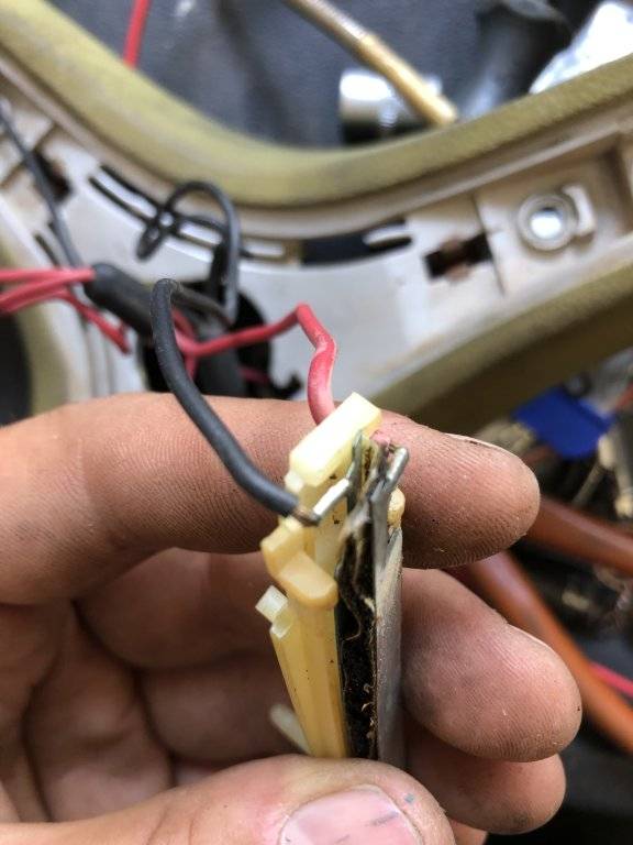

But why there is a kind of plastic strip between the contacts? For me it seems like isolating the two contacts from each other but it´s on all three corners so there has to be a reason why it´s there. Just can´t see it......

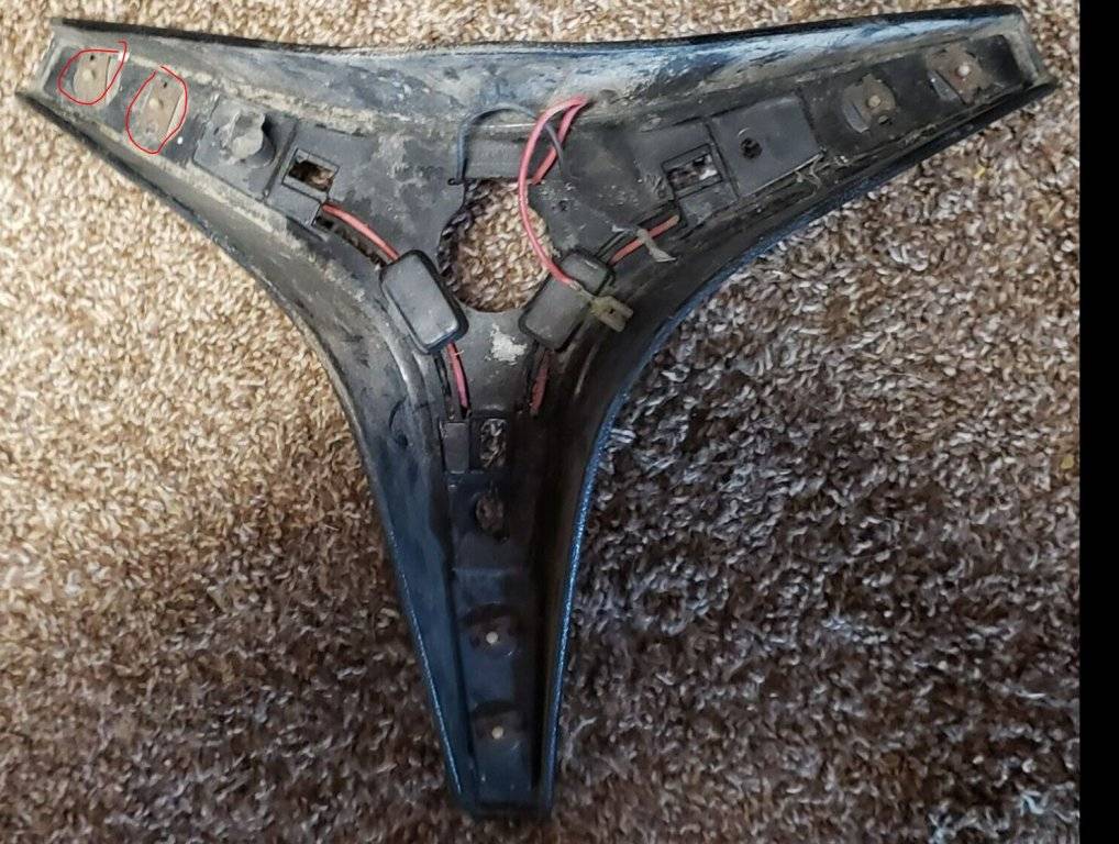

Sorry. I never figured out how to remove the contact pads/horn pads. How do you take them apart?
Mine we´re kinda loose but they are clipped twice with metallic holdings from the back. If you take them away the buttons come apart from the whole triangle.

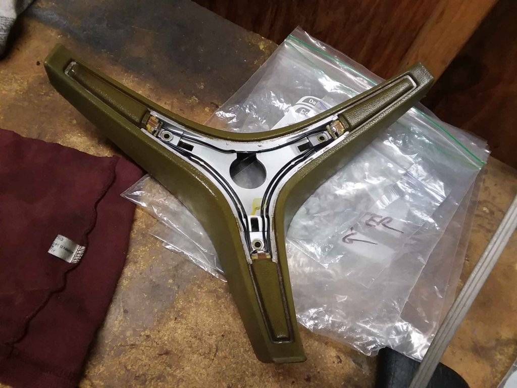

EDIT: Found a pic :)

Just put in my battery yesterday and the honk somehow just works fine by pushing on the ends of the contacts . Just not by pushing on the buttons maybe the got harder through the years ?
And : Honk does not work when car is running ….. obviously wiring issues but tripple checked wiring before when I was looking for the issue itself so kinda clueless where to look at now ?!
Honk works great when car is off but don’t when engine is running…
