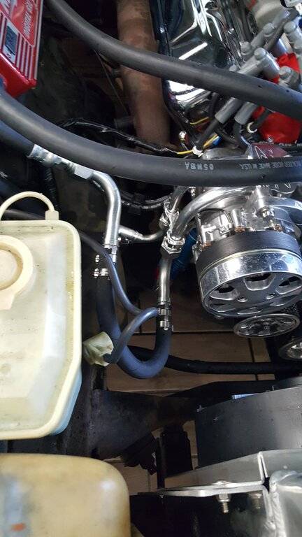

This thing cranks out the BTU's! I am pleased as punch. Please, just do it. I understand the originality thing. But in 2017 the argument carries little weight unless your car is intended to be a like-new, as-delivered, project. Yes. I get it.
In the other 95% of the cases, this is the only way to go. The BPE brackets make it a no-brainer. I heard horror stories about alignment and interference but it just isn't so. I have no idea why so many people had issues.
I spent a ton of money. Here's the definitive installation. Yours may vary.
1. New modern style parallel flow condensor. DIY brackets.
2. Pusher fan(s). Two in this case. DIY brackets.
3. Custom Barrier hoses.
4. New OEM dryer.
5. New OEM Expansion valve.

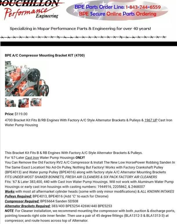

6. New compressor. Note on compressors: Bouchelon sells the Sanden 133 cu. in. compressor. For the same money, I went internet and bought a 155 cu. in. compressor that is OEM in big trucks. Be aware most of the compressors on ebay and auto sites are "Sanden style" Chinese clones. It's up to you.
7. BPE bracket kit. #4700 in my case.
8. Tinted windows.
Last night I had to turn the temperature up. That was a first. All is goid. Don't consider it. Just do it if you live down south or you do major cruising. :thumbsup:

Please post the part numbers and vendors for the compressor and brackets.
:thumbsup:
http://www.discountacparts.com
BPE A/C Compressor Mounting Bracket KIT - Bouchillon Performance Engineering

Late signup, thanks for a great thread. I'm reading all the A/C conversion stuff before I do mine.
@commando1 , I am working on my conversion now and got a lot of great info from your threads. Just checking back after a couple of years to see if everything is still working and if you may have any additional thoughts or advice.
Just about everything got covered. The only additional thought is, I should've done it sooner.
Glad to hear it. We have already brushed 100 a few time here in DFW so I sure have my fingers crossed that it works for me.
I went with the Sanden conversion as part of my serpentine conversion. It worked great!
