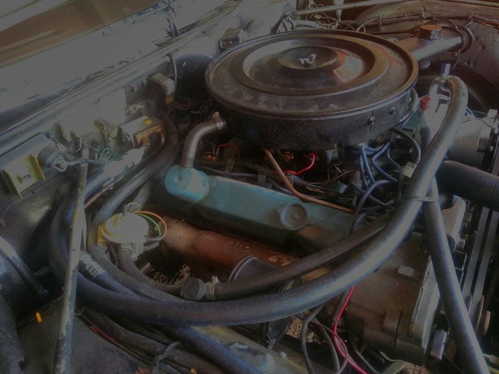

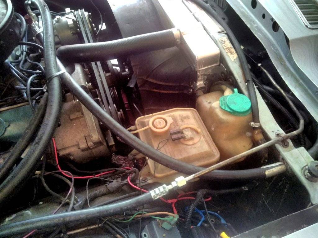

I fretted unnecessarily over this project. The compressor is literally plug n play.
The hoses were another story. Very EXPENSIVE :eek:
What's an H-block? lol. The Expansion Valve is still the OEM style on the firewall. I put in a new one (as well as a new drier). Those damn things are a POS. Constantly get clogged. I think I'm on #4 now.

The old compressor was using R134 also so I can't answer that.
My understanding is that an R12 system converted to 134 will deliver the correct operating pressures with less weight of R134 installed. If you installed the R12 spec'd weight it might be slightly overcharged which can affect how the system performs.
I don't know what the optimum suction and high pressure specs are for R134 but that's what a few A/C gurus I know use instead of weight when retrofitting an R12 system and it always takes less weight to hit them.

Did you pull a really good vacuum on your system before recharging?
With a smaller system, even getting a lines worth of air can keep it from cooling to peak efficiency.
Not sure what the internal displacement of the new compressor is compared to the old one, but, it should be smaller.If the system was charged by refrigerant weight alone, you are going to be running a higher pressure, with a higher evaporator temp.
Pulled a vacuum for an hour. Sucked everything out going back to 1976. lol
Charging was done by pumping in R134a until the outlet temp. at the vent wouldn't get any lower. 42° vs the 48° the R2 cranked out. So I can't say how many lbs. of refrigerant it took. I don't do the pressure guage thingy. (that should freak Jeff out :p)
Also,unrelated, what are your thoughts on the cooling efficiency of your aluminum radiator compared to the original?
Did you go with more core rows on the new rad?
I went with a 3 row. I'd say the cooling efficiency improved but the only thing I can compare it to was the old original radiator. How the Champion would compare to a new OEM radiator I can't say.
