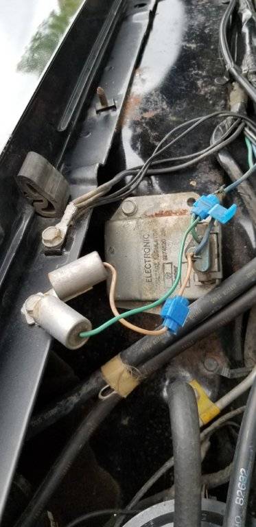

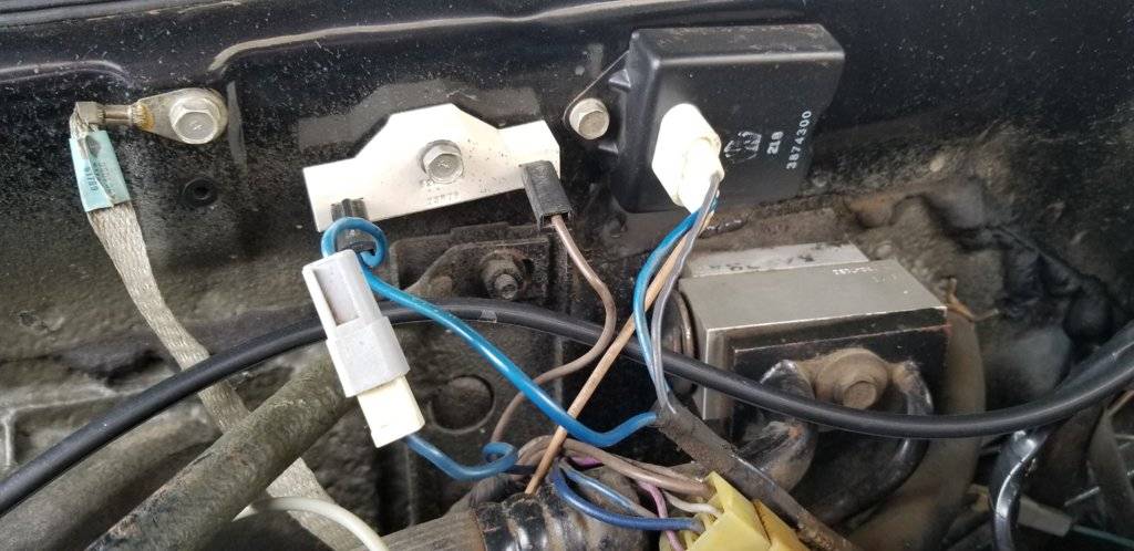

Is there anything else I am missing? Coil?? While inspecting I found a ballast resistor and ignition module mounted and connected. I thought lean burn cars didnt have these components? Do they need to be replaced? The module looks like someone added a couple of caps grounded to the fender. Any idea why? Where do I go from here? Thanks!

NOT sure about that mass of capacitors and such that's been added to the car. Possibly somebody was trying to chase an ignition noise issue?

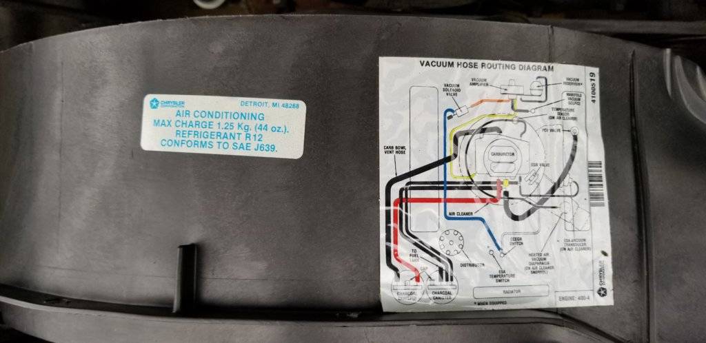

Other than those extra condensers, everything looks very unmolested, from what I can see. Plus the vac routing decals and such.
CBODY67
Other than those extra capacitors, everything looks very unmolested, from what I can see. Plus the vac routing decals and such.
CBODY67
Those are not capacitors, they are condensers to bleed off any static. This was supposed to help protect the electronics.

Very true. That advice was given to me at a fairly young age and it has served me well over the years. Also those "scotch locks" that spliced your condensers into the wiring are known to be problematic. They were intended for temporary use. Use solder connectors, or just solder, for best results. Always check your ground connections. Good luck and keep us posted.

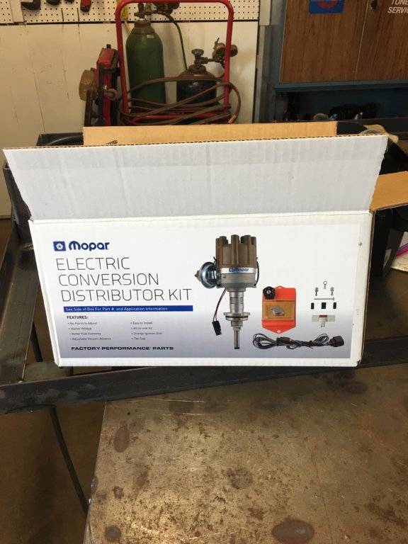

i had to do the covert ion for lean burn to electronic, mice made a home in the lean burn ignition box, i bought mine from jegs for like $139.00 for the whole kit
