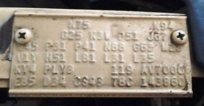

How about a picture of your fender tag. Another thing we do on here is figure out who may have the last Formal made.

I believe the end of production for 1978 C-bodies was probably sometime in August 1978. November 1978 was deep in to 1979 production year already. Take a picture of the assembly decal on the driver's door.
Bob, from what I can see on the window sticker, it appears the SPD is 119 or January 19th. Or, maybe is is B19 if the OP thinks it was made in November. Either way, it does not appear to be a "late" car.

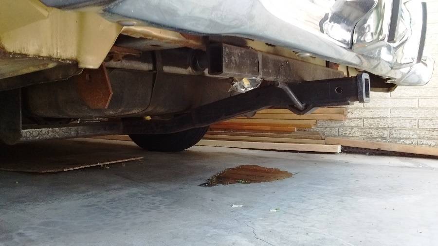

Here are the photos of the door jam VIN info, the VIN Plate and the trailer hitch. It turns out to be a Drawtite from 1981, (paperwork fond in bag on hitch) so it is not a "factory" item as I was told.
I posted photos that you requested on the Vin plate and door label. Steve
