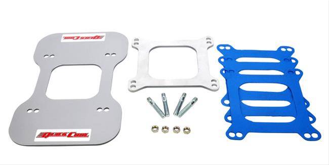

No problem....I had to order a few parts from Summit to adapt and overcome the vapor lock. The temps were pretty cool last fall when I finished the build.
Holley has a Quick Fuel Insulator Kit that is basically a shield that goes between the intake and the carb. Even though Formals have a ton of room under the hood I'm pushing the limit with the Performer RPM Eddie intake. I should be able to get this kit to work and not mess with the hood.
Quick Fuel Quick Cool Carburetor Insulator Kits 300-4013QFT

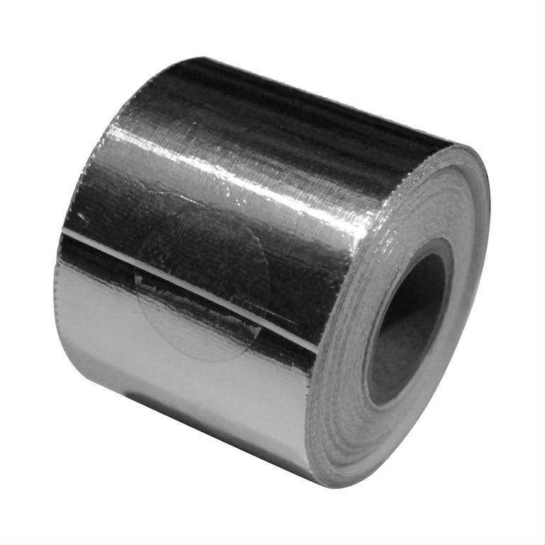

Big block Mopar's dissipate a huge amount of heat from the exhaust manifolds and the engine in general and I'm also going to wrap the fuel lines fom the fuel pump to the carb with Summit fuel line heat tape. If this doesn't work I'll sleeve the fuel line with a heat barrier sleeve. Let's try the easy way first.
Summit Racing® Heat Tape SUM-350122
I don't want to use a 1/2" or bigger spacer between the carb and manifold because I would have to go with a 6 pack hood scoop.

I'm concerned with hood height. I think shielding the fuel bowls with that kit might do the trick.
I'll have to test for hood clearance and see if I can add a spacer if the kit isnt enough to counter the vapor lock.
