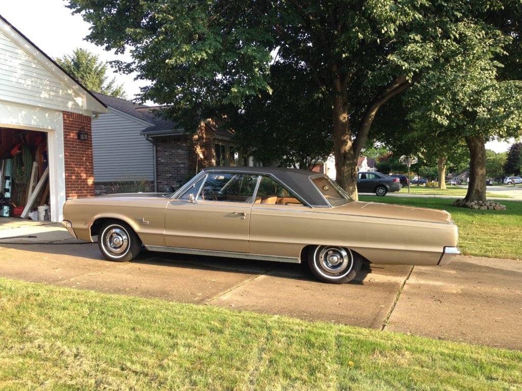

These are 215/75x14’s on my Monaco. In my opinion they are way too small for the car.
Diameter wise they’re about an inch less than the original 8.55/78x14’s and they look too skinny. At least by todays standard.

Thanks for all the photos and opinions, I think the 215/75-14 looks good for a driver.
Would be nice to have a slightly wider white wall but you have to live with whats available.

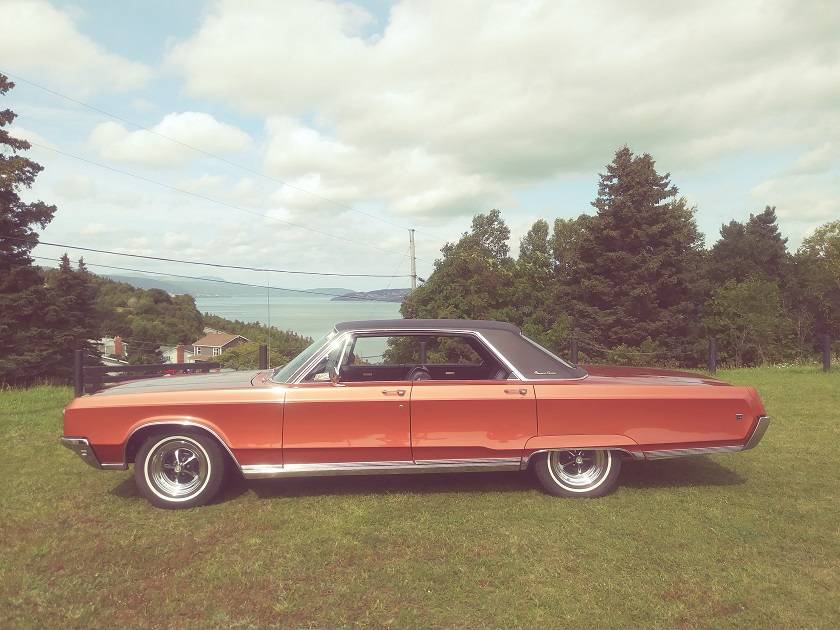

I use the 235/75/15s on all my fuselage cars - no rubbing and they don't look wide enough for my likes, but at least they are tall enough and look like they belong with the cars. I have some older white wall Michelins in that size on my avatar car at the left, and those look perfect, but of course you can't get them anymore in a whitewall. They were tall and wide, more so that anything else available these days.

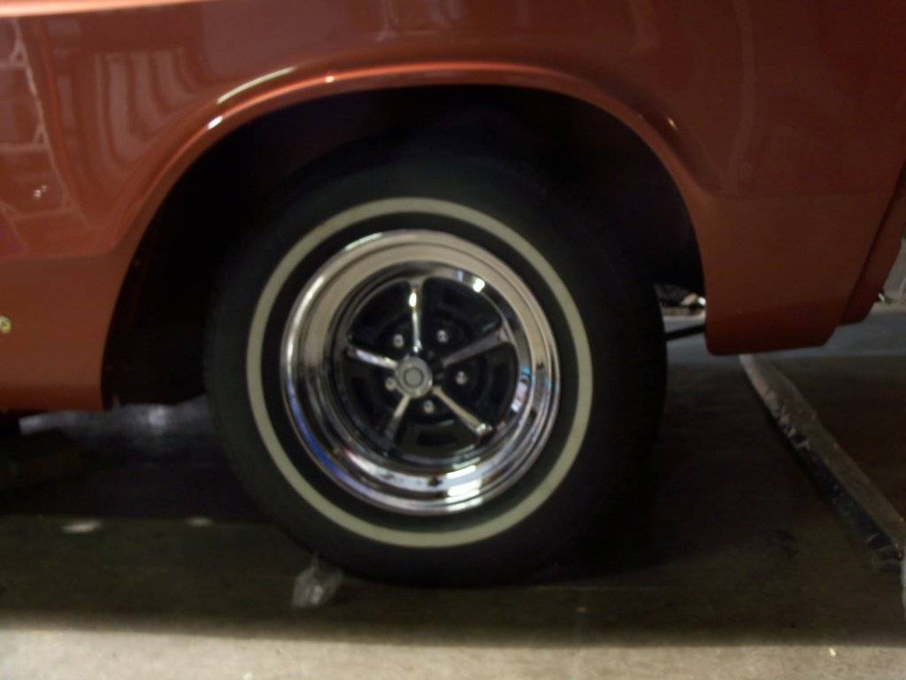

I work at a tire shop and I have access to 23570R15 GT Radial Max Touring with a whitewall.18 in stock.
I have them on the BoaB on the 15X7 Magnum 500's and do not rub anywhere.
PM me here or email me directly at my desk lpatey@jiffyautoservice.com if you are interested in the whitewall 23570R15's or have any questions.

Those 235/70R15 w/w on the BoaB look perfect on it, and with the miles you put on it last summer you'd certainly know if they ride well. I will be shopping for some 15" tires for my convertible. Nice to know those are an option.
