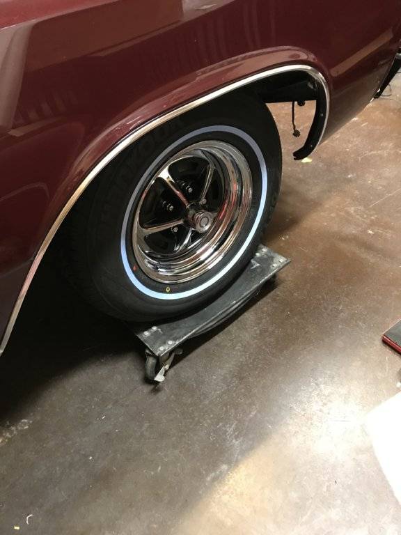

If I'm not mistaken, that's what is on my 68 in thie picture, getting replaced as we speak with new wheels and tires.
215-75-14 - I'll confirm in just a moment.
Sadly that's the largest size we can get from the tire store for 14 inch rims

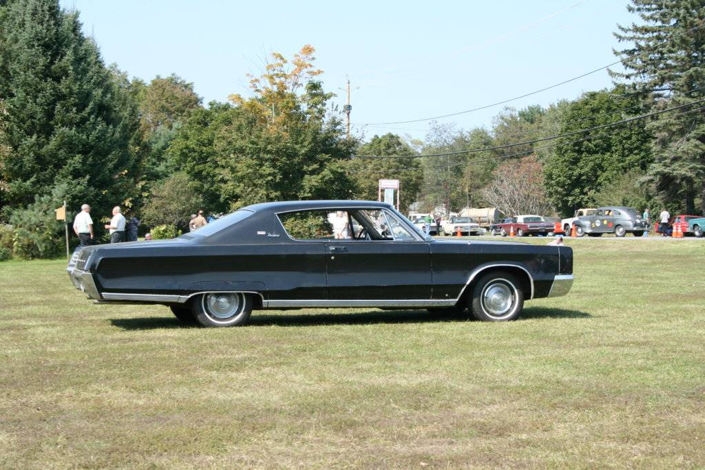

IMHO, this is the "right" size for a stock look:
Here's the size and brand:
hankook optimo 225/70r14 - Yahoo Search Results Yahoo Search Results
I didn't search for white walls, so don't know if they're still available.
Mine are 10 years old now, still ride, handle, and look great.
Hope the input helps.
John

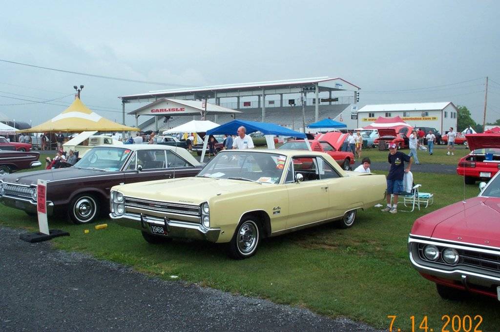

215/75R 14's Photos. Too small. Wished I had went for large 14's way back in the late 90's when I bought the tires for this Sport Fury.
They are a bit too small, but the only reasonably priced tire. The restoration tires are too much money and not very good quality.
