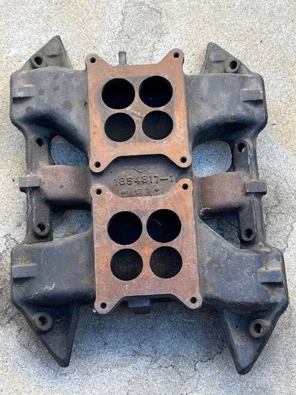

I’ve been on a kick lately… Normally I’m a record fiend. I’ve got tons and tons of rare Soul, Doo Wop and other miscellaneous 45s worth $$$. Now it seems my knack for finding stuff has crossed into the Mopar world…
You may remember I scored these awesome 413 4 bolt valve covers not too long ago
Now I’ve scored this awesome 2X4 intake I believe came from a letter car!
I’m curious now. What carbs would’ve came with this from the factory? Thinking of running it on the 413 to my future 62 Chrysler. Don’t want to “over carb” the engine but… I can’t not put this beautiful intake on that 413 same for those rare Moon valve covers!
If that is from a letter car, then I would sell it and get an aluminum one. They are still available new, and those cast-iron ones are heavy. I like the valve covers. Years ago, I had 3 big blocks with 4 bolt heads. Two were 426s. Those would look nice on the 413.
There is an episode of Nick's Garage where they ran an intake and carb set-up with that "ancient" 2x4bbl manifold (or one just like it). It made over 500 lbs/ft of torque. Totally amazing for the technology back then! Carb sizes would have been about 500 cfm each, I'm speculating as cfm ratings were not really worried about back then, just the number of holes in the throttle body. Progressive linkage keeps excess capacity waiting for activation, just like the secondaries of a normal 4bbl.
Enjoy!
CBODY67
They had Carter AFB's. I think they were originally set up on processive linkage and only the primary carb had a choke setup.
I had one of these manifolds once and tried to run two Eddie's on it and they bolted up but the butterflies hit the manifold so I had to run a spacer.
That only came on the 300E, and it’s verified with the 58 casting date. The F & G had the long rams.
That manifold is the easiest and cheapest part of the complete set up to find. The parts to complete it will cost you plenty.
Think of it as a gateway drug, a teaser to the pain ahead. Once you search for the rest of the stuff then get a reality check from the price tag.
And why is it always a bare manifold for sale? No carbs aircleaners or hardware. Same with the ram manifolds.
I agree that the manifold is the easiest and cheapest part of the set up.
Actually though, besides the 300 Es, that manifold setup was also used on the 1962 Chrysler 300H and non-letter 300s with the optional power pack 413 engine.
As the evolution of intake manifold technology and design has progressed, a 750+cfm carb on a single 4bbl intake can rival or best earlier multi-carb intakes with over 1000cfm of carburetor capacity sitting on top of them, which is good. But back then, multi-carb set-ups were the way to go for power and certainly "street cred" when tuned properly. And, running on just the primaries of the primary carburetor, they got pretty decent cruise fuel economy, too! But some over-cammed the engine for lower rpm operation, so many didn't have that benefit.
