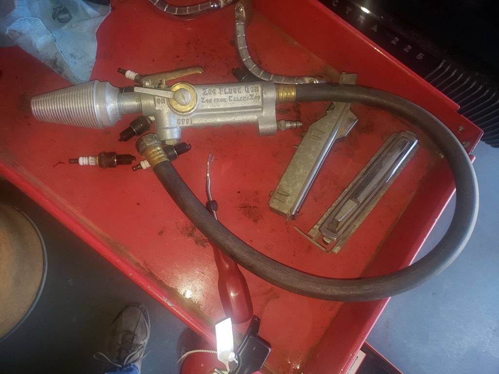

If you can find one of these, they work great and washing soda does a good job on the clean out.
saw a similar device that uses both air pressure and water into the heater hose, and out the radiator for hard flush. but have never heard of using baking soda....interesting
