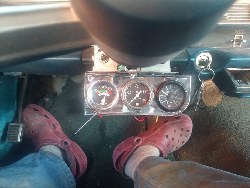

Progress! Flushed the coolig system again yesterday, and for the first time since buying this car, was able to drive it to and fro my wife's workplace and eldest daughter's elementary school; about 11.2 miles in morning traffic! This came mostly of the advice of one of this Forum's MOST sagacious members, who just CAN'T FLIP a Mopar, may he be blessed forever!
So, I flushed the system yet AGAIN, and THAT improved engine cooling almost to a stable operating temperature around 200F!
Having reached this state, I opted to carry out the second Thermocure "enema" on the cooling system this Friday morning, and will retain the cleanser in the cooling system at least through Sunday, and maybe longer, depending on how many hours of runtime I get this weekend.

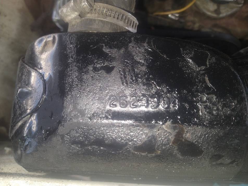

I also put my venerable 1965 2524984 radiator in a shop for a rod cleaning job, and then for some leak sealing. This radiator has at least DOUBLE the capacity of whats on that convertible now; 4 rows of 1/2 inch copper tubes in a core twice the thickness of the '68 model. Its rated for AC on the mountains of Hell while towing lead sleds uphill, all in a 22 x 18 inch package. That should do for south Tucson. I liked the cheap aluminum radiators for their price, but their asiatic builders have left them on the docks. The american front companies who vend these get none of my sympathy. I will have a GOOD radiator rehabilitated for less money than even a "Champion" costs. Mathilda never overheated with this radiator in her. I expect neither shall Gertrude

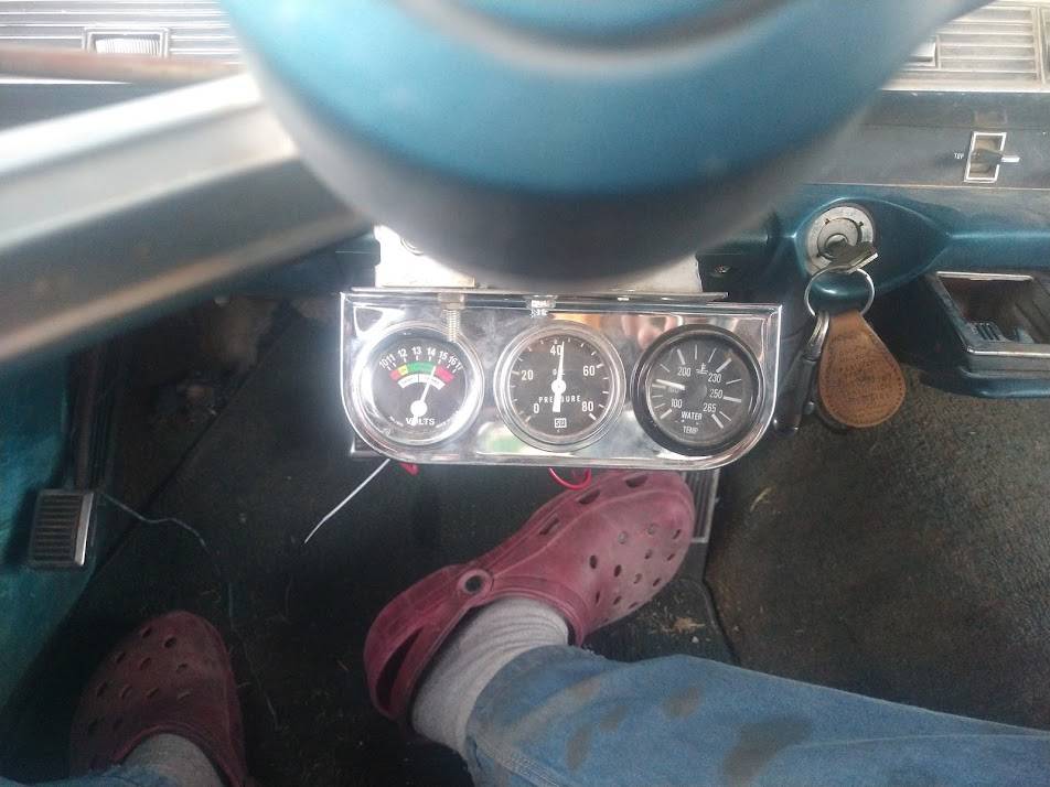

Hmmm new Thoughts: Drove Gertrude downtown and back this eve, without her getting over 210F after late Sunday afternoon flush. Flushing HAS helped, somewhat. Noticed that so long as I keep my big heavy foot OUT of that damn carburetor, she doesn't heat up so. Also noticing deteriorating power brake quality. This comes as NO surprise; that booster looks original to the car.
Sooo, I hate power brakes to start with. Can't feel the street with them. Mathilda did fine without them too, even after putting the Bendix clone dual pot master in last summer. Soo, I reckon its time to delete that booster! Nothing but good can come of this. I HAVE the direct connection rod, in Mathilda, but I can remedy that OR get another one maybe. Think I'll pull what Tilly has first. THEN, I can delete the leaky booster and see how much better the engine behaves without that huge vacuum leak!
In the worst case, I'll just have to muscle the brakes, but I prefer to do it so anyway.

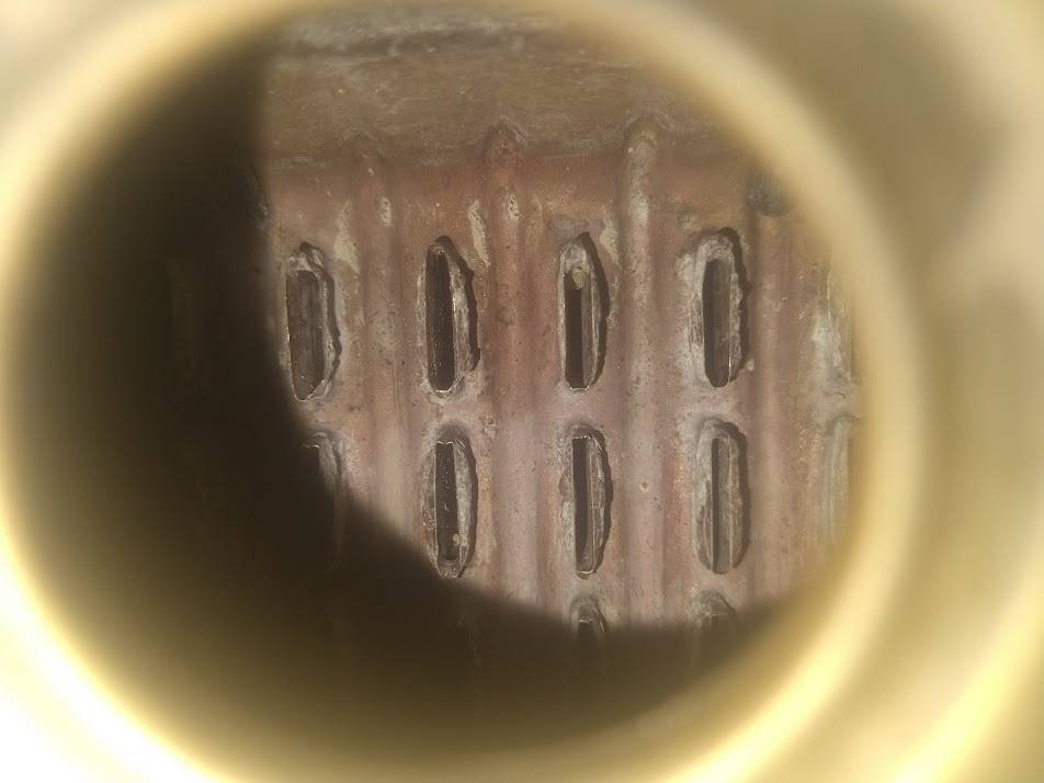

TRIUMPH! The old 3 row 1965 #2524984 came home from the shop up the road from me, BETTER THAN EVER! I NOW assert I can RACE UPHILL in HELL, towing lead ingots all the way, and never overheat! I took Gertrude for a test run once I had the freshly rodded out, painted and sealed old treasure installed. Let the pictures do the talkin'!
After 3 miles, ambient temp, 74F, rush hour traffic, temperature rose to just about 162F. I plan to reinstall the thermostat this Saturday. Idle around 700 rpm.
At trip's end, temperature rose to just under 180F after stopping. At NO time did I engage the pusher fan on this test run. Coolant consisted of
distilled water with Rislone's wetter. Come Saturday, I'll add 1.5 gallons of Zerex Green, to create a 50% glycol solution for the winter and to preserve the cooling system from corrosion. The shop did a nice job restoring Mathilda's original radiator to a useful state.
Tubes nicely cleared for good coolant flow.

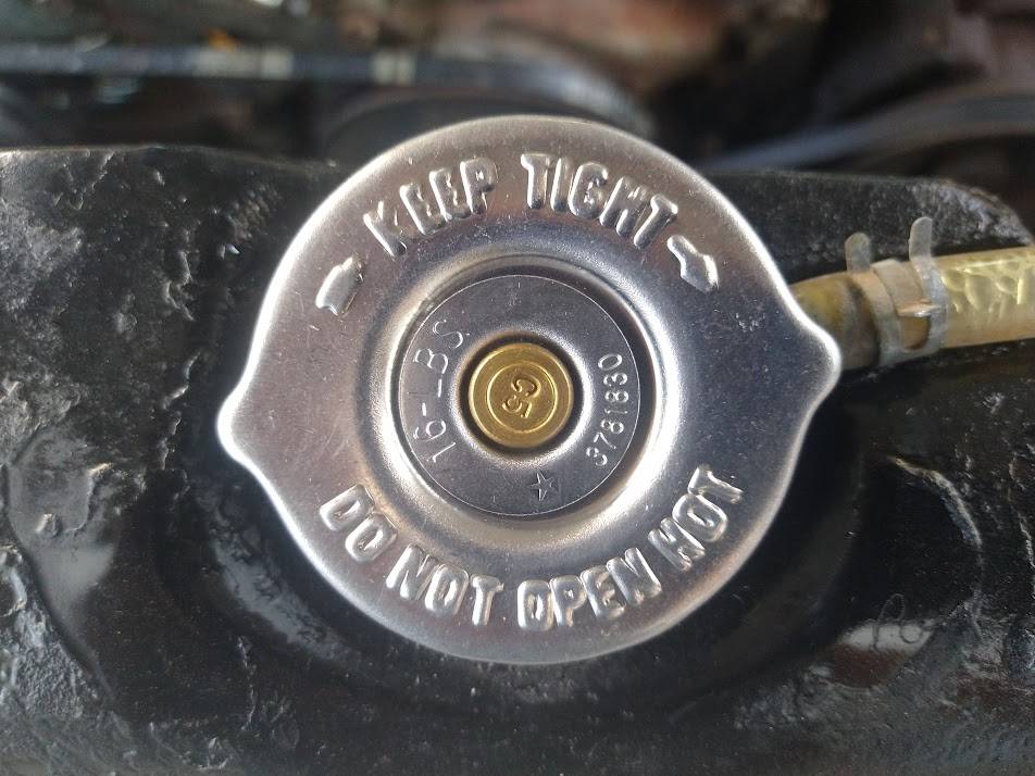

The old Stant radiator cap wore out a bit around the edges of the rubber cap gaskets. CLEARLY OVERDUE for replacement! So, in keeping with the rarity and vintage of Gertrude, I found her a WORTHY radiator cap! Ecce!
Nice NOS stainless steel #3781830 Mopar cap, dated March 1975, w Chrysler Pentastar authentication. I always run cooling systems at 16 p.s.i., and retired the 13 p.s.i. cap that came on this radiator over 5.5 yrs ago very soon after getting the car it came with. But not until today have I ever installed a genuine MoPar cap. For all practical purposes, I think the matter of runaway overheating on this engine has been solved, and thank all contributors to this happy circumstance.
