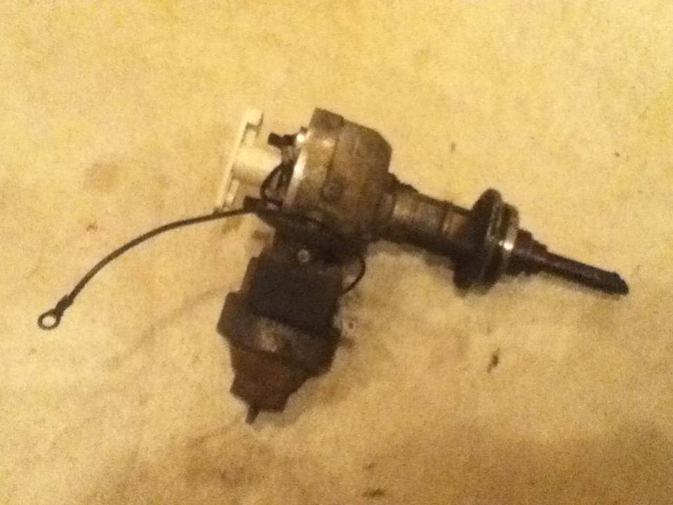

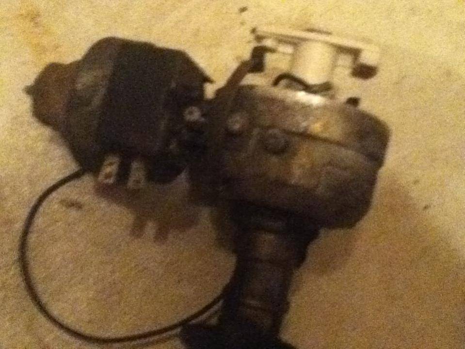

Can anyone tell me about this distributor....why it has such a HUGE vacuum advance canister??...and those prongs were connected (electrically) to the back of the 2bbl carb, which had identical prongs. I just installed new mopar performance electronic ignition to get rid of the crappy points and the new distributor looked nothing like this....the vacuum canister is nowhere near the same size, and there is no electrical prongs on it either. Has anyone else run into this?? I'm trying to get the girl up and running again and I'm hoping this isn't an issue.

so are you able to say what this/what this does (prongs) on the vacuum canister? It was wired/plugged into the back of the 2bbl carb. The new mopar performance dist. does not have this feature (yes, I double checked--multiple times,hahaha to confirm that I order the correct replacement dist). I've never seen this before on a 'B' motor dist. (not saying that its not normal - just never saw before).

Couldn't say, this sounds ridiculous but mine was melted around the prongs and ordered a NOS piece to replace it. What it does..........:shruggy:

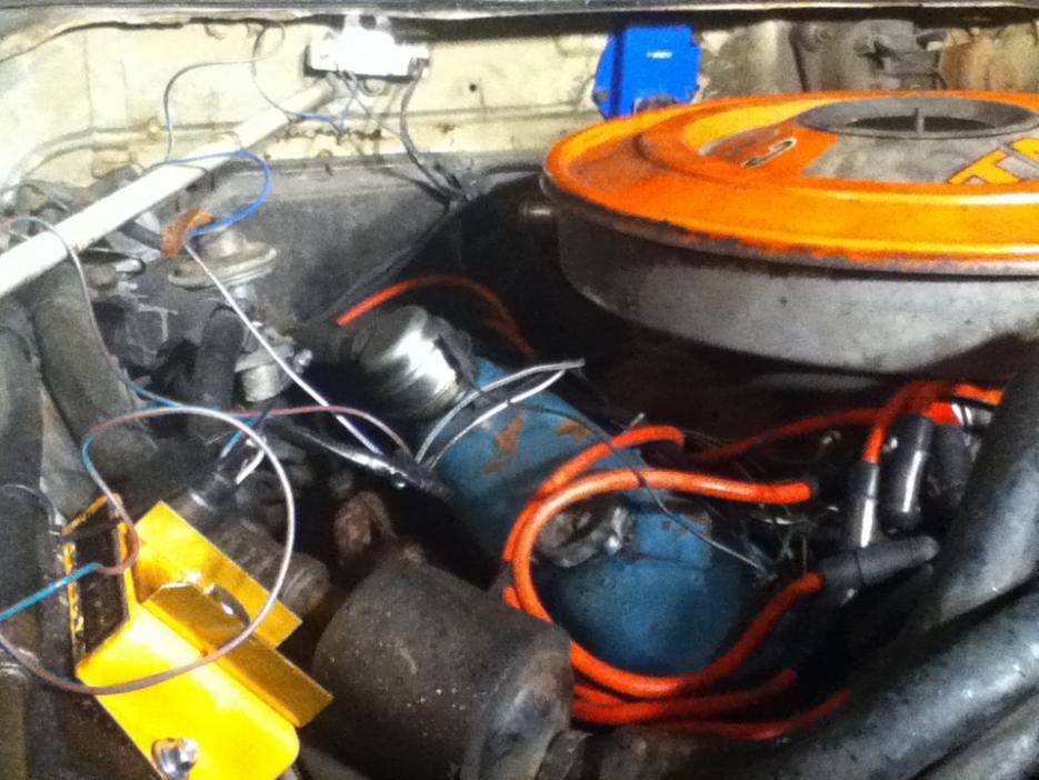

yeah, but with the NEW dist. she does not seem to want to start....the starter motor turns, I checked for electrical connectivity with 12v test light (at ballast resistor, ECU, + side of coil, etc. its all energized when key is turned), adjusted the new dist. per correct firing order 1,8,4,3,6,5,7,2...adjusted the rotor accordingly and still she won't wake up.
