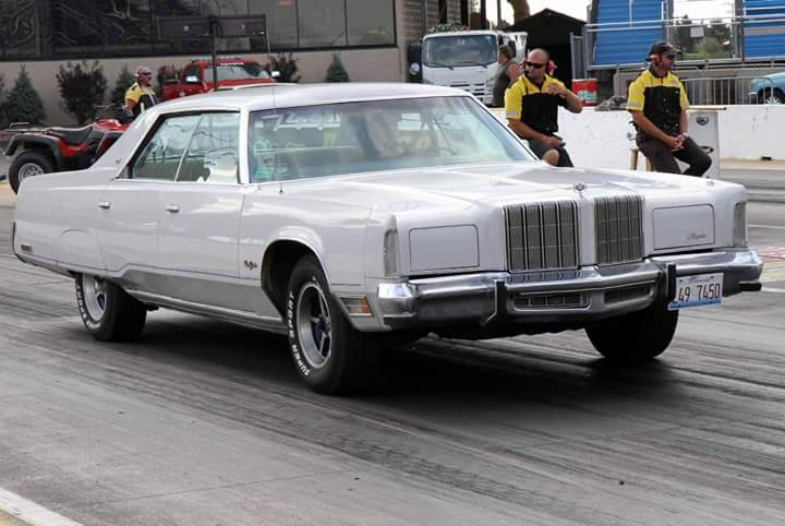

My 78 NYB went 17.3 @ 83mph with the shifter in 2nd gear going through the traps. 440/727 9.25 with 2.7 gear electronic ignition. Dual exhaust. 625cfm Carter Competition AFB.
