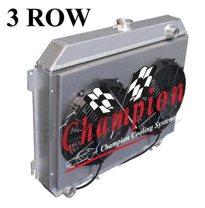

So...... what's the best route to go, recore the OEM rad or go with the aftermarket rad from Champion? I don't care about originality...looking for the most efficient fix. Which is better route to go? I can get a 26" OEM rad, 2 row, recored for $300-$350. The aftermarket looks like mods are required for fitment and mounting the shroud. That 3 row with the dual electric fans look nice! Is that the setup that is advertised for $280? I don't think it would be?
The three row champion will out cool the stock OEM any day of the week.
Installation is "almost" a bolt in. I say "almost" because I have seen/heard several times the top two mounting holes didn't line up correctly and had to be redrilled (no biggie in my opinion).
Oh, ya.. the fan setup is waaay extra...
So 3 row champion for 240 or try pricing re cores and hopefully get lucky in a junk yard... Thanks for the info. Only other question, has anyone noticed any improvements with an electric fan vs. mechanical set-up?
