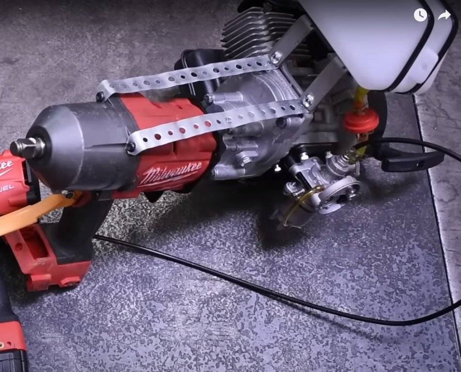

Some on the 'net ain't to happy with Milwaukee these days. (love the 2-stroke version as I hate batteries)
