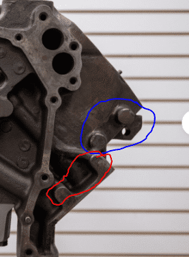

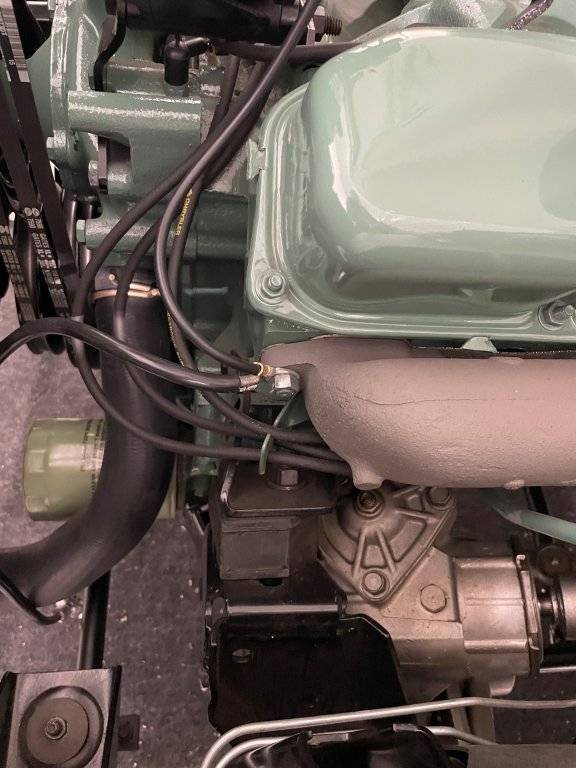

No, 'tis correct. :)
There are 2 types of brackets available nowadays. (I just learned about the 2nd bracket in the last 6 mos)
The one you posted is the OEM style, for engines with the bosses, but modified to use an available insulator (from an early B-body).
The 2nd one is for engines without the bosses.
Both Schumacher and 440Source have webpages for them.
Early C Body 1965 Only-store.440source.com
'67-69 A-Body & '65 C-Body Big Block Left Side Conversion Kit
Presumably the 'oil pump' bracket is made to use the same B-body insulator, but I didn't dig into that.

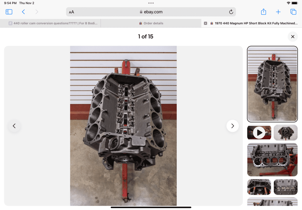

Are you thinking iron heads and flat tappet cam on the 440 block? Everything is on the table at this point. Stick with factory iron 4 barrel manifold as well? I don’t really need a lot of horsepower. I just like the idea of a 440 in front of the four speed while I rebuild the 383. I’m selling off my motorcycle collection and recently quit riding so I need a project. Sounds kind of silly. I really appreciate your perspective Fury Fan as well as the feedback and information coming from the forum.
My cars are street (67 Coronet 383 car) car that runs 14's and is a blast to drive, totally stock 65 383 Fury cop car and a 1060 hp drag car.
Based on my experience, if I were doing it, I would stay with cast iron heads, just clean them up, probably go with a very mild hydraulic roller cam (tired of the flat tappets not lasting anymore), and put a nice dual plane intake like the Edelbrock RPM on it. I would shoot for about 9.2:1 actual measured compression. If you look for my post on the intake, you will see where I overcammed the motor and totally killed the bottom end and hated to drive it. Also did not want to idle well. Took 13/14 degrees duration out of the cam and added 0.020" lift on the exhaust and a completely different car. Starts great, idles well and is a blast to drive.
If you are going to rebuild the 383 to re-use it, why spend much money on the 440? Take the downtime thru the winter, rebuild the 383 to 325/330hp specs (or a little more), and be back to 'original' condition for summer 2024?

I don’t really need to build or use the 440, I just like the idea of it in the ‘65. I’d like to rebuild the original 383 back to stock specs for installation back later if I sell it or want originality. At this minute I am leaning towards a good set of iron heads well cleaned up, an iron manifold, a slightly more aggressive than stock roller cam and a carb to match.
