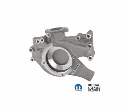

I got mine from Mancini....
Mopar Performance Water Pump Housing

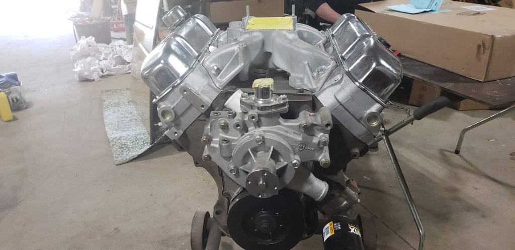

Well I finally have actual user info on this now if anyone is interested. I have the 440 source water pump housing as well as the 440 source water pump on my new 440 stroker engine. In fairness since it is a new engine build I did have the stock radiator re cored as well as a new heavy duty fan clutch as the old one was tired. I reused the factory fan shroud and fan. My old 440 engine with the old radiator ,fan clutch etc would rise in temp sitting at a light or crawling through traffic and was slow to cool down when driving. 195 to 205 or a bit more so not bad but enough to make me a little uncomfortable and watch it while stuck in traffic. Now it is really solidly around 180 and max is 190 ,quick to come down too. Take it for what it is worth but I am happy with it.
Here it is before the Turquoise paint. Got rid of the chrome water hose fitting,,junk apparently and used a stock one.
what torque value(s) did you apply to:
-bolts tightening the aluminum water pump housing to block?
-bolts tightening the aluminum water pump to aluminum water pump housing?
I had the engine built for me. I will ask if he remembers or maybe the specs are on the 440 Source site.
