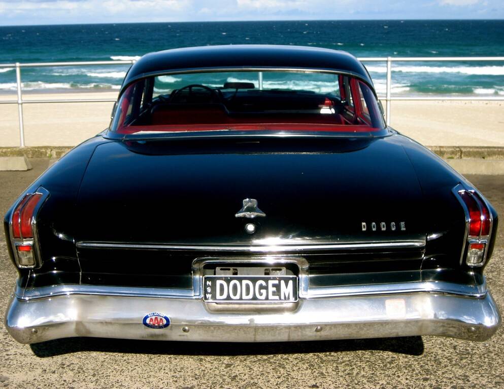

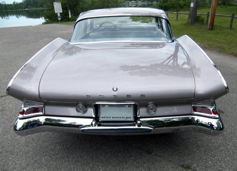

    61 Dodge Seneca
    62 Dodge 880
    They look nearly identical except for the trim - lettering etc. I bet you they do interchange, but don't quote me on it!
