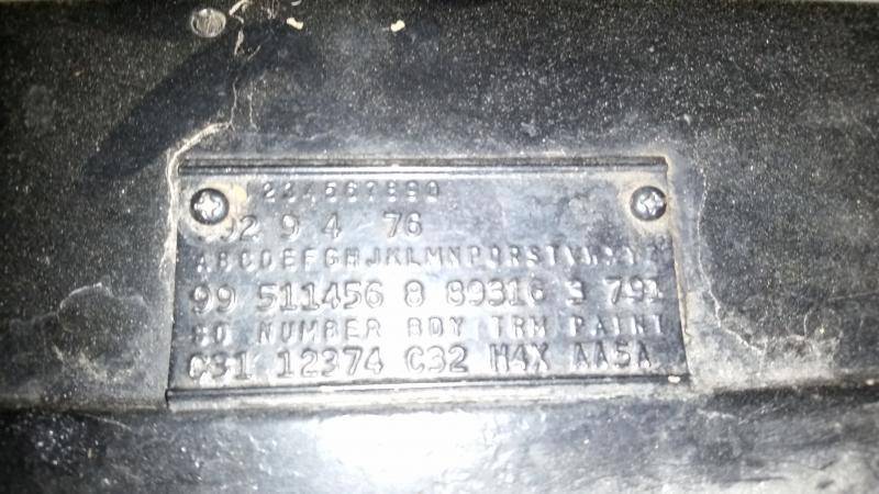

Rarely see a tag filled up like that! Looks to have been gold originally with black interior. I could work on decoding that later.

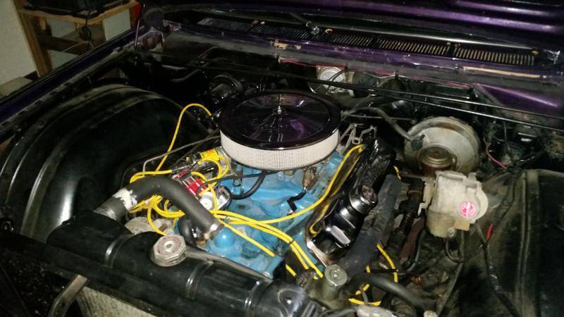

Wow! That is hauling *** for a big C-Body. Especially with a 2.76 gear. What kind of engine and mods are you running in that thing ? Are you running nitrous ?
Here is a link for 65 tag decoding
http://www.1962to1965mopar.ornocar.org/ml-osterling65fendertag.html
remote mirror
variable wipers
Air
power brakes
power seats (both)
power windows
power vent windows
auto pilot
rear defogger
am/fm with rear speaker
power antenna
rear speaker reverb
black vinyl interior
monotone regal gold
493 440Source stroker kit. Just under 9:1 compression. Edelbrock RPM heads with a good valve job. OOTB the valve job is less than marvelous. M1 single plane with Holley 950 Commander Pro TBI. MP 509 cam. Hedman shorty headers. 3000 RPM Turbo Action converter.
