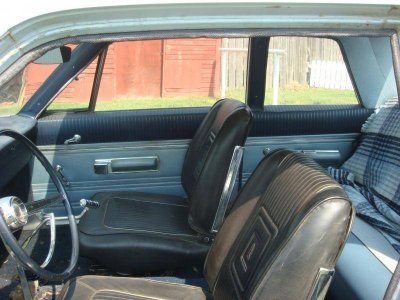

Not sure what Plymouth these seats are out of but they were in my 66 when I bought it. Luckily the original bench came along with it. The outside mounting bolts fit the original holes in the floor and they drilled the inner 2 holes closest to the hump. Fit seemed ok.
Thanks everyone. I have a console car. It was originally a Fury III but converted to a sport fury and has buckets from a late model Pontiac. When I saw pics of 66 Belvedere seats, I realized they looked similar. If not as wide they might not look right. 1Fury1, yhour seats don't look original but, they look great. I like them. I may end up going with low back vinyl buckets from Procar. Again. thanks for the replies. This will help.
