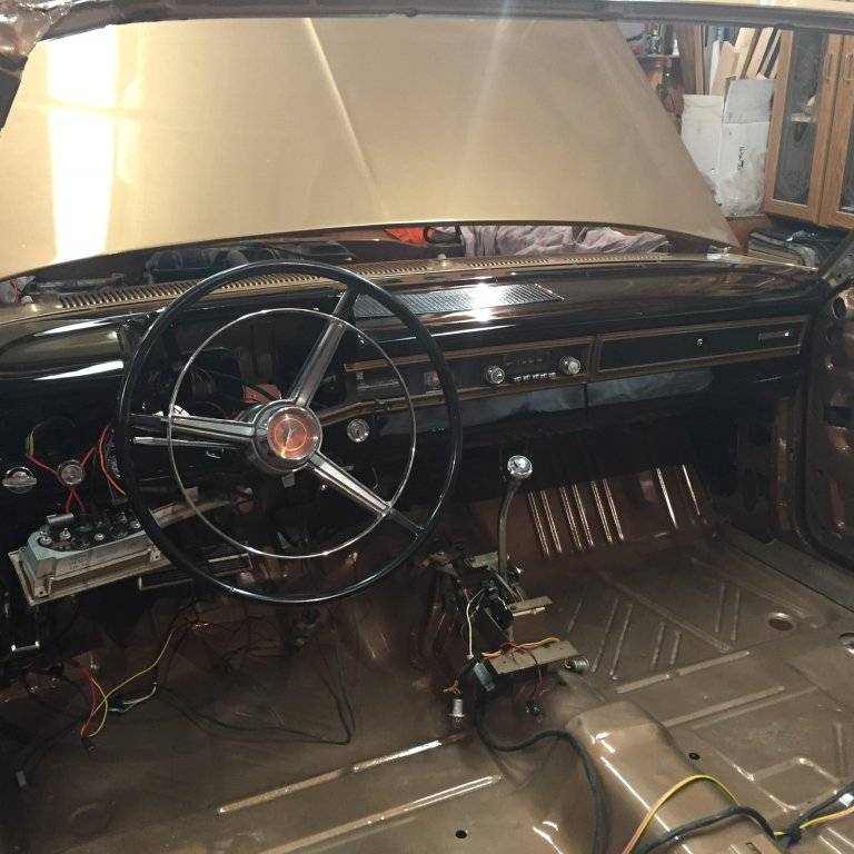

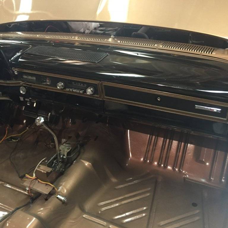

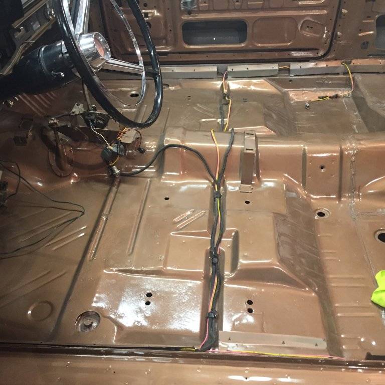

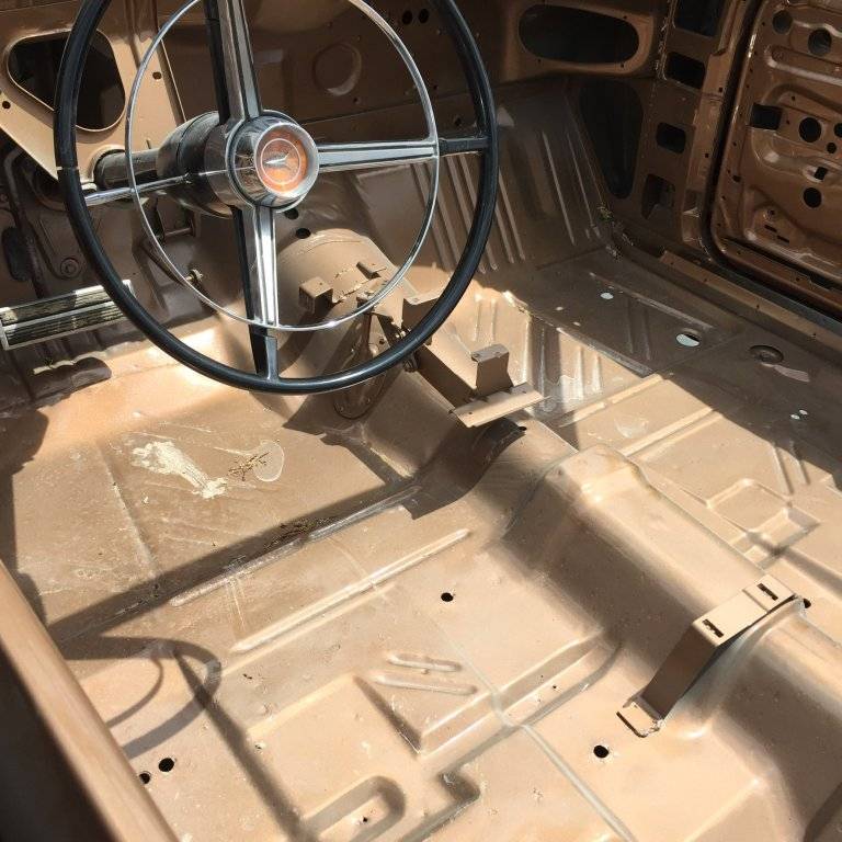

Here are a couple of pics showing the location of the brackets but unfortunately I don’t have any dimensions.

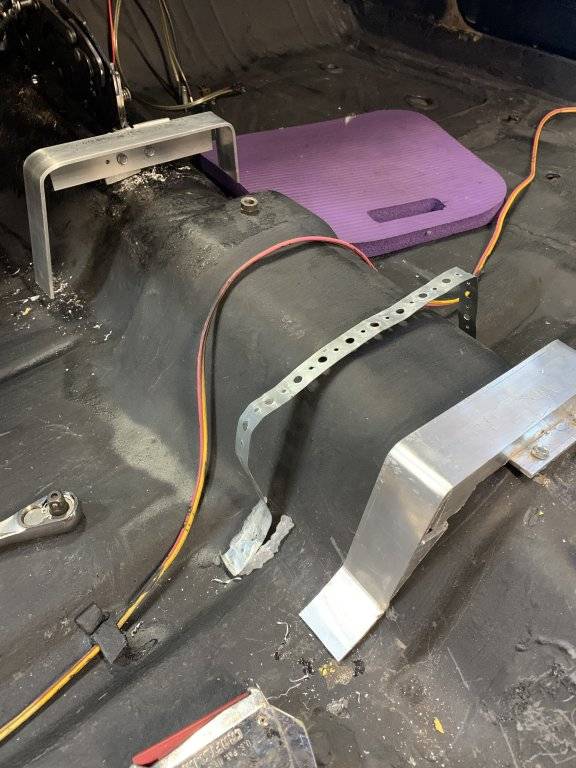

Related to the thread mentioned by Welder guy I can add that I too had no mounts and at first I wanted all the individual measurements too but in the end you can just get someone with a factory console 66 to measure the distance from the under dash heater vent (or just firewall) over the hump to the console. Once you get that measurement and locate the 2 obvious places on the console itself where the screws go through the plastic then it you can locate a floor position. Plus a general location for your shifter. It wont be exactly factory but close. The important part is your shifter location relative to the seat. In some ways you are luucky in that you can customize to your seats and arm reach.
BTW the hump is NOT centered in the car! And the console is NOT centered over the hump. There is more drivers side floor than passenger. The console kind of makes up for this by having an offset to the drivers side. I already had a shifter in a good position (not stock) so used this for left/right orientation. You don't have this yet. Not sure but there might be marking/indents as to where a sfifter would go.
The point is get the console front and back location by a OEM measurement. It will start falling into place after that. Sorry if this is unclear. Caffeine I guess.
Also SEM Landau paint can really help the look of a console. the scratches and interruptions in the texture will still be there but much better.
I added center console mounts to a fury that never had one. I started - with help from members - trying to recreate the factory mounts, but soon realized that because of my non-stock shifter it was a waste of time. I then just added plumbers strapping to the console itself using the 3 built in mounting spots and then leveled and centered on the shifter. Wherever the strapping hit the floor I hot glued it down. After removing the console that gave me a template for location, height, etc. I had a piece of aluminum angle that I used but in retrospect wood could have worked just as well.
My console will be higher than stock because of my shifter (Hurst - promatic2) but carpet and sound deadening should fill the gaps just fine. Super excited about finishing this and the interior but the nice weather as me appropriately distracted.

RK, I really appreciate the great photos, that have helped me to see how the console and shifter are mounted, and moreover, how the console wiring comes into the mix. I thought wiring came in from the head, as I attempt to rewire mine, but have not thought about pulling seats and carpet to work on the floors yet....trying to get RoadKill running first. Did you replace metal, and if so, where did you find it....have not found a source of new floors yet.
Yes I replaced the floor panels. Had to use the dreaded C2C panels as that’s all that’s available. Your only other choice is a donor car or make your own. In the end they worked but are thinner than oem.
