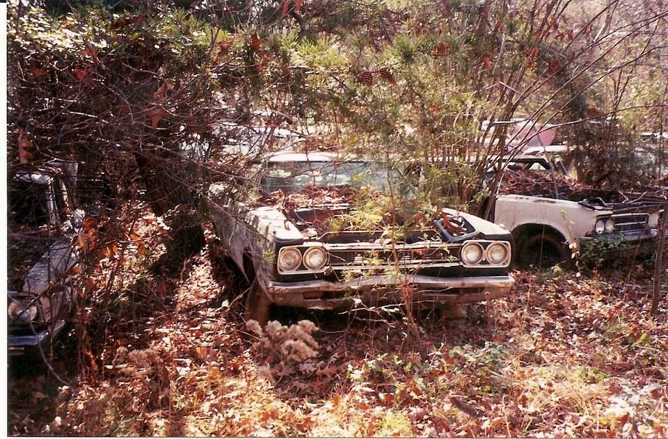

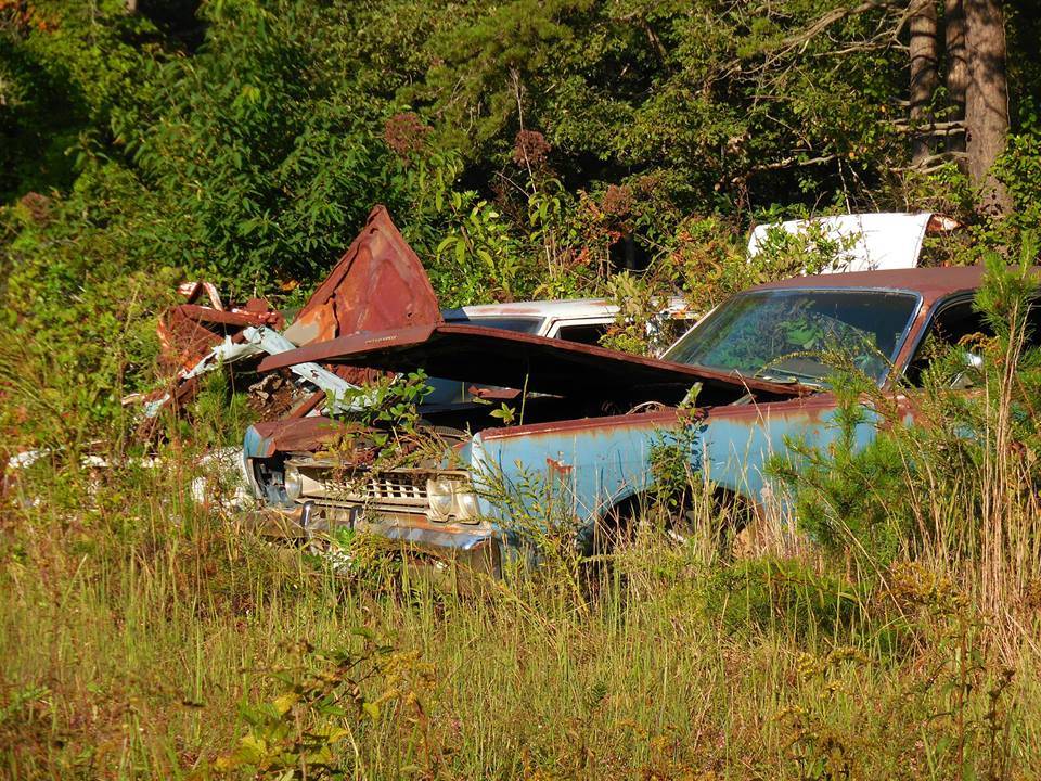

Just be aware that at the two larger yards I mentioned, Leon's and Fredricksburg, the cars won't be in neat tidy rows with limited vegetation. Those yards are heavilly overgrown. Some cars are so deep in weeds and thistles, you could walk right past without seeing them.
Man, oh man.....that brings back memories of wandering through Gates Salvage Yard in Hardwick, VT back in the day. Last there in the mid-80s, bet it's all crushed up now.

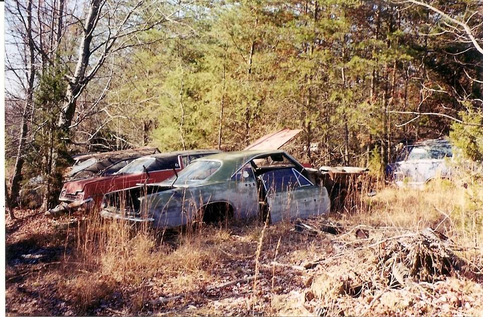

That last shot looks like a 66, and even though it's a 4 door, the trunk lid and bumper are the same. Do you find the park and remove it or do they pull parts? Those bumper bolts might need some persuading with a torch....
Bring your own tools. The Imperial in the picture is a 65, not a 66. The picture of the 65 was taken several years ago. Not sure if that one is still there or not. 65 trunk lid and bumper are different from 66. But there were other mid 60's Imperials there. You would have to ask about removing the bumper. I am sure that if they remove it, there would be an extra charge.

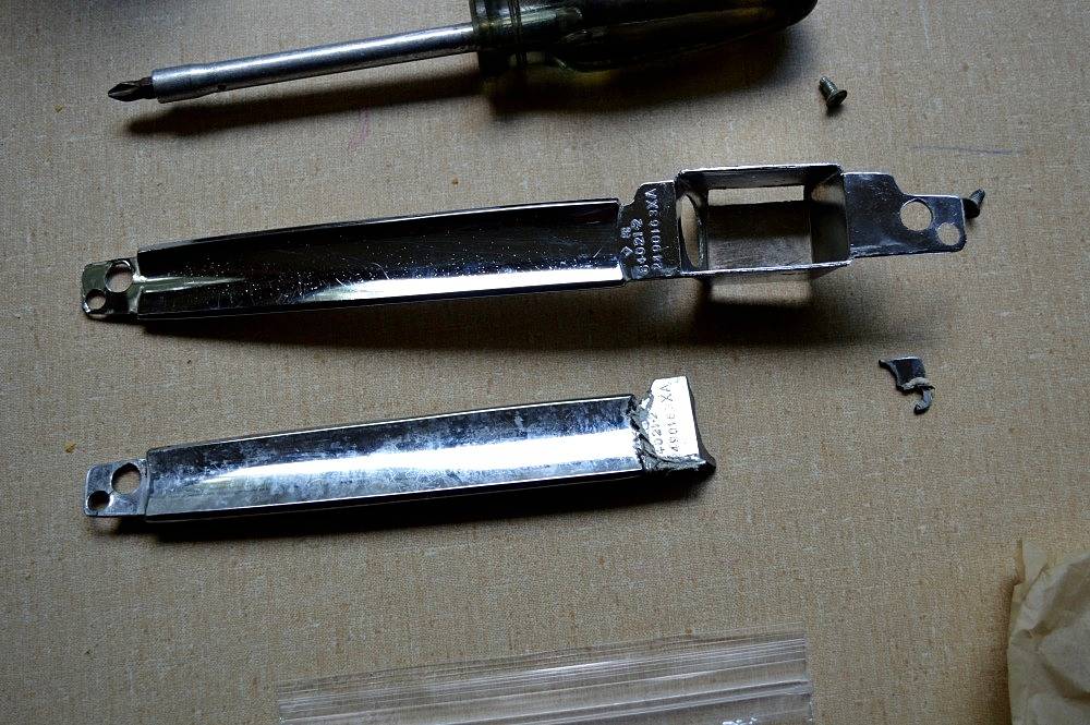

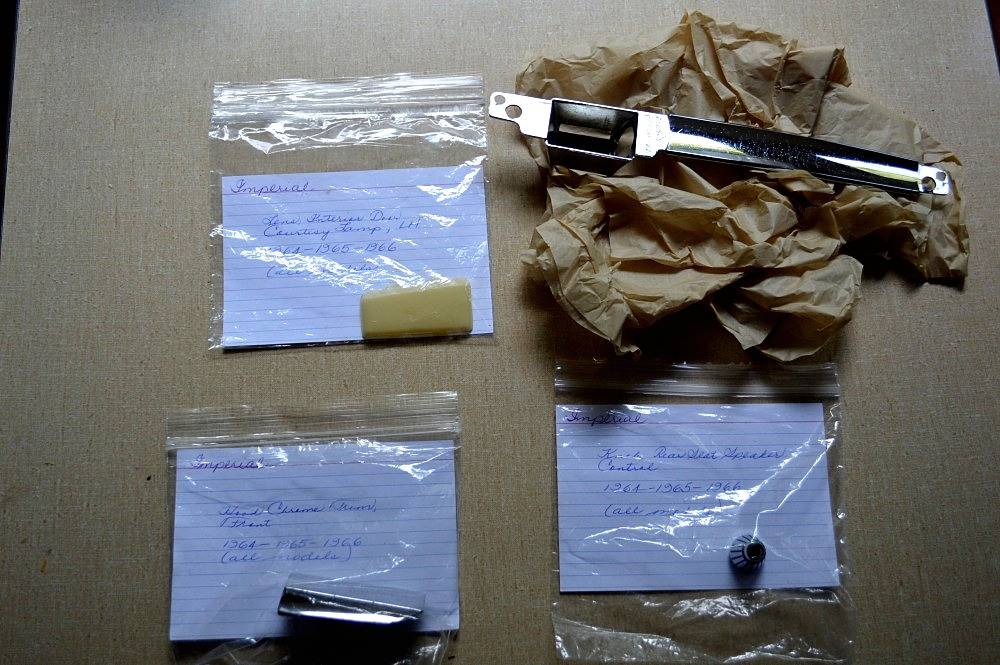

Received some small parts from a fellow named Charles out on the left coast. A true gentleman and class act - fair prices, honest descriptions, didn't charge and arm and a leg for shipping. And packing, well....have a look:

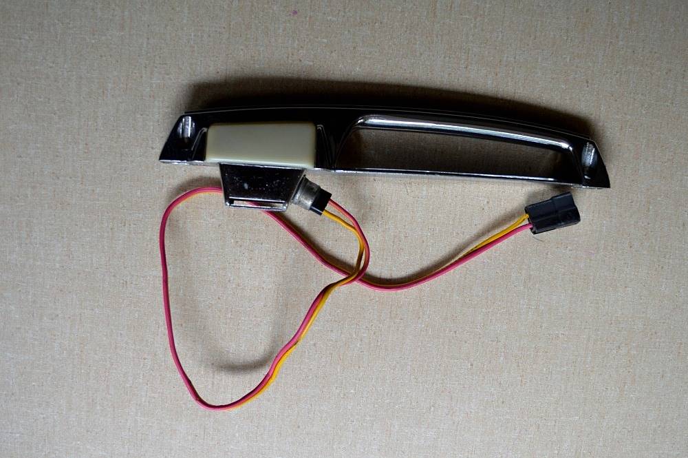

Every deal should be like this. Got the missing piece of hood trim, missing rear speaker knob, and a lens and backing plate for the driver's door pull. All areas that, while not critical to using the car, needed to be addressed at some point.

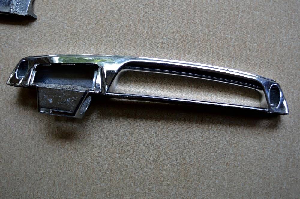

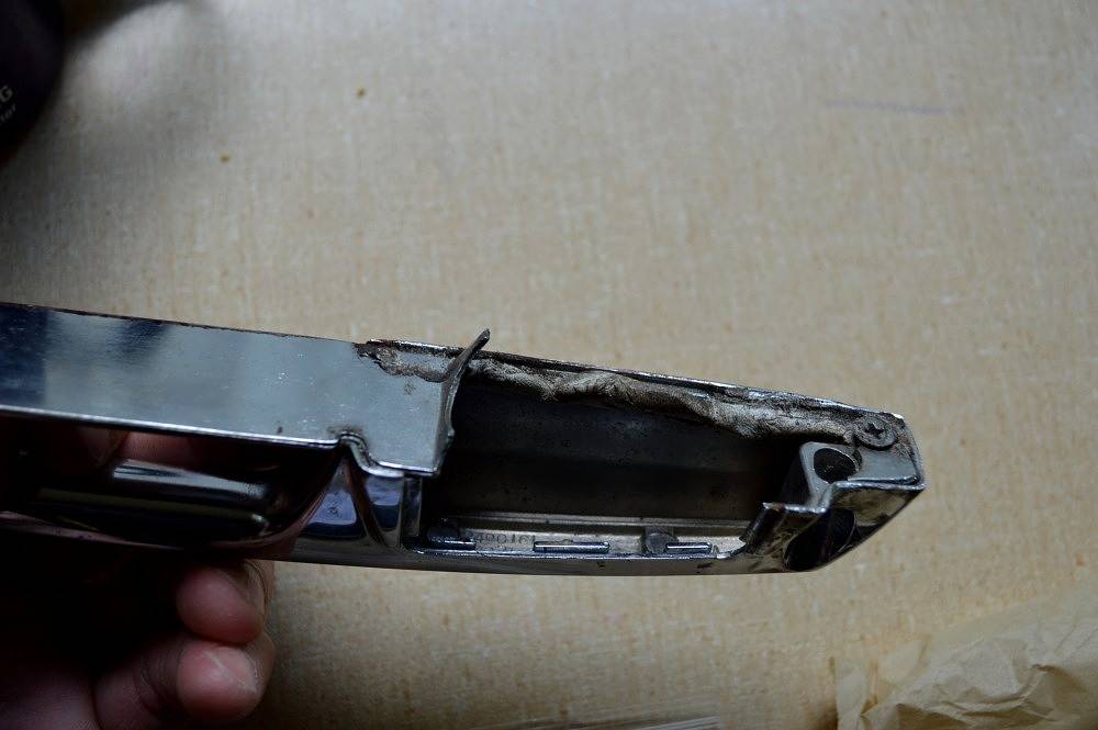

I had noticed the pull had an issue in one of the original photos from the seller. The bulb was dangling out. Figured it was just left that way waiting for a new bulb or such, but it turns out the piece that holds the pigtail socket in place had broken off at some point and was missing, probably inside the door now. On top of that, the plastic lens was missing and one of the contact springs inside the socket was AWOL. Rather than try to wrassle a spring into the socket and around one contact I found a replacement pigtail previously for $7 and change, shipped. Charles provided the remaining two parts and now the completed door pull awaits re-installation, hopefully this weekend. Need to pull the door panel first to fix the outside door handle which appears to have become disconnected at some point before I got it. It was a fairly simple fix that will bring light back to that side of the car when a door is opened:

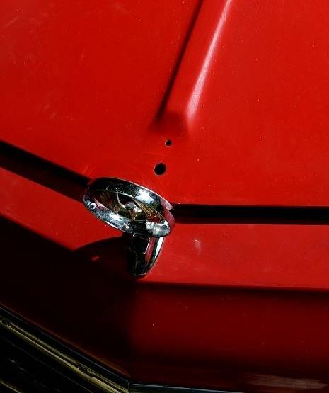

The little missing piece of trim was annoying and let rain into the hood. Though it's a little cloudy compared to the bird ornament, it's a lot nicer than what I had (nothing):

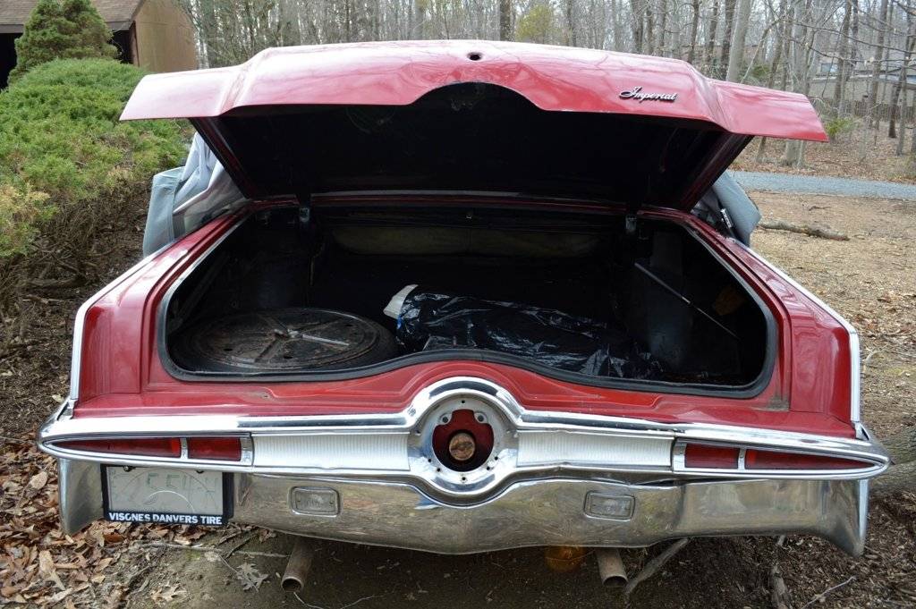

The main issue gnawing at me since the damage during delivery has been getting the jammed trunk open. Recently purchased a Whistler inspection camera on closeout, thinking it would answer all. Spent about an hour with it stuff down through the aerial hole someone blasted in the rear fender. Works great, but no joy. Couldn't even find the latch, just...blackness.

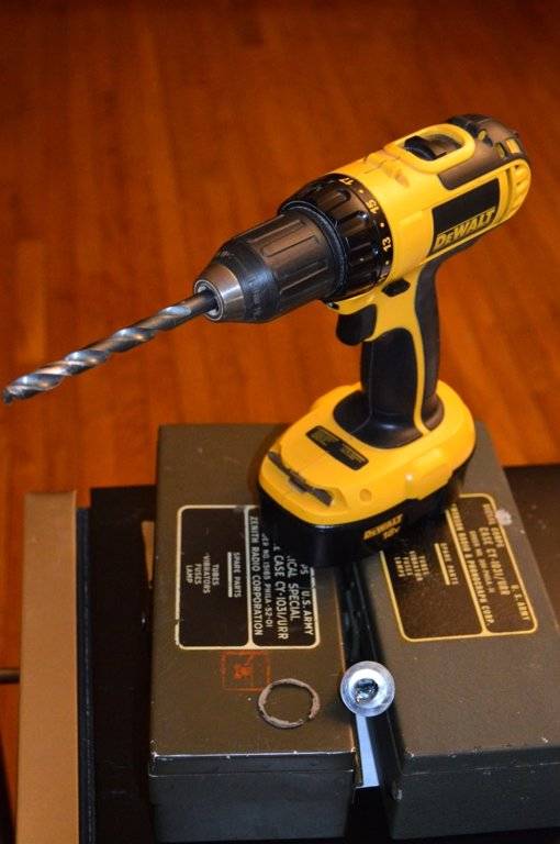

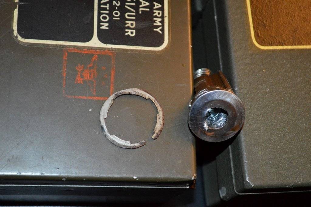

Finally got a hair cross my *** and went for the drill. Turned out the be the best decision I've made in a while. Had that lock cylinder out in 10-15 seconds. Stuck a screwdriver into the latch, and voila - the trunk lid rose like it was hydraulic, smooth and steady. Turns out the latch is just fine - not jammed or damaged in any way. I had suspected it was okay because the lid wiggled up and down, but there was no 'click' or response to turning the key in the lock.
Seems the flat aluminum rod between the lock and latch was the problem. Still haven't found it, in fact. But since it opens fine with the screwdriver, I'm sure it will be okay with a new lock (ordered one last night). The backseat option wasn't available since it's a convertible and other problems as well (like hydraulic fluid everywhere due to a leaky top hose).
Here are some impressive (to me, because I FINALLY got it done)photos of my handiwork. The drill gets most of the credit, it did the real work.

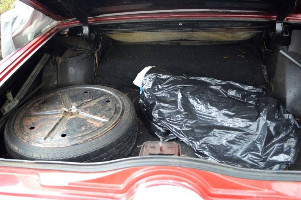

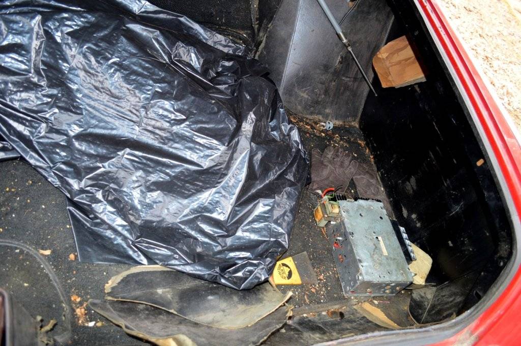

What I found inside was pretty interesting....
I knew the parade boots were in there because they were on the car when I bought it. The seller bagged them up for me for the trip. Despite the tree incident, they were right where he set them.
The spare tire, cover, original bumper jack & tire iron are all in place, just missing the carpet cover for the tire (if there ever was one?).
Also an ice scraper and a pair of gloves that look too small to fit me ("If da gloves don't fit, you must acquit!").
Then it got really good. I had a dim recollection of the seller telling me the original radio was included in the trunk. Someone had replaced it back in '85-'86 with a stylin' Jensen cassette deck and crappy little speakers they cut into the rear side panels, along with aerial #2 they bored into the back fender. Might not be half bad if it didn't sound like Minnie Ripperton singing through cellophane stretched over a dixie cup. I mean, it'll make your ears bleed.
Anyhow, I digress....happens more as I get older....I had actually started looking for an original radio just to see what was out there. I had though AM/FM was probably standard equipment, but not so, not yet. Seems many of the cars were shipped with AM radios that had the groovy auto-search feature controlled by a foot switch next to the dimmer switch on the floor. Sure enough, foot switch was in place, so I had a hint.
Apparently the AM/FM radios are somewhat scarce. What's more, they made a different model for 1965 and another for 1966. The optional radio for 1966 was (no kidding) the model 420. What are the chances of finding one of these? Well, I did track one down in Kalyfornia for a mere $350. Decided to hold off since the brakes, top, and other, more pressing items need to be fixed first. Minnie would just have to do for now. And I think I dreamed something about a radio in that @#$%!&* jammed trunk.
Sure enough - there was the original radio, connectors cut off by the genius who installed the Jensen (at least I can reclaimed them with some solder and heat shrink). No knobs, either. No big deal. So, which would it be - AM only, or the elusive AM/FM auto seek (or whatever)??

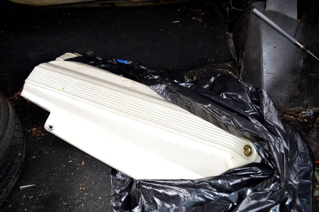

Well....after regaining consciousness after finding the model 420 radio, I noticed the cardboard siding was loose around the rear area by the tail lights. Thought I spied a mouse nest behind it, grrr.
Sure enough, they had moved into a mouse condo with building material courtesy of the back seat by the looks. But! they had built their home up against....
...a factory reverb unit! Incredible. I of course immediately became the nasty landlord and evicted them, condo and all. No rust, staining, or apparent damage to the reverb, however it is installed directly behind the impact area of the rear bumper, so I'm prepared for potential issues.

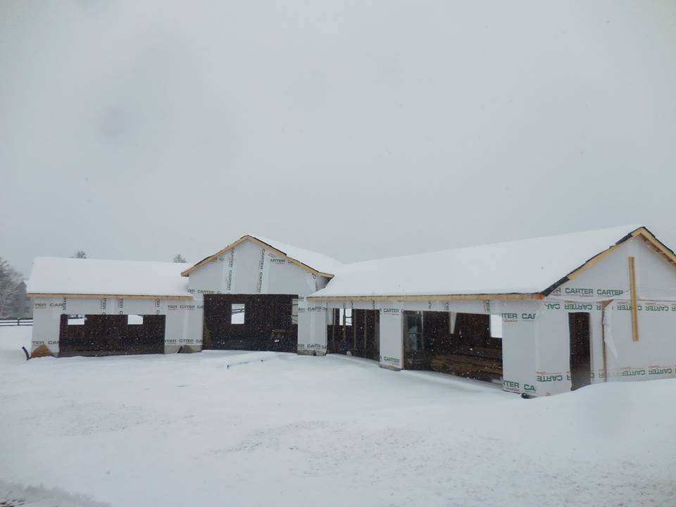

Yes, it has been a while. Hope you are doing well. Not much progress on the Mopars here over the winter, but the new garage construction is moving along.
Nice!! Damn, that's bigger than a lot of houses. My biggest gripe about this place (after taxes and all the 'too close to DC' crap, of course) is the lack of garage space. You will have it licked once that place is done. Hell, you can spend another year setting up and outfitting it inside and out!
