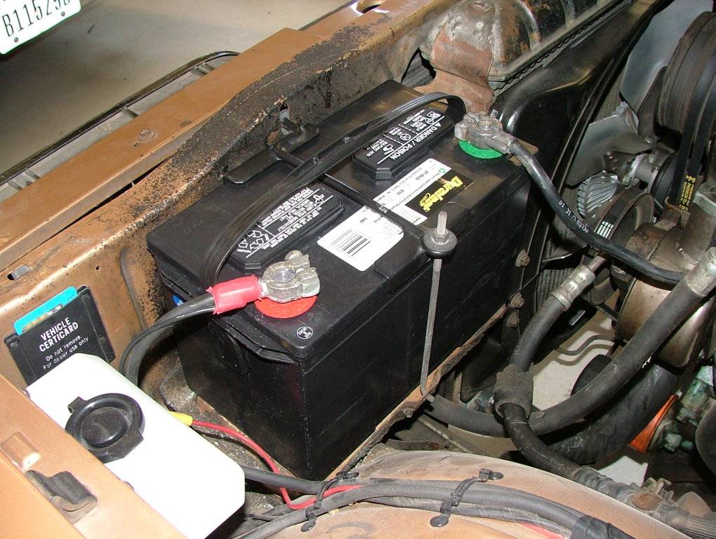

I took this car out to one of my Saturday cars-and-breakfast shows the weekend before last with some car buddies. The younger one (late 20s) had never ridden in a station wagon and had to climb in the wayback seat and wave at everyone on our way there. Had a good time and the car drove great. Three days later I went to move it and it wouldn't start, charged the battery but no good. Put in a good battery from another car and it fired right up so the 6 year old Interstate was junk. I had not bought a battery in while so I did some research as to AGM (Optima) versus traditional lead acid. Turns out all the major brands now have AGM alternatives but the long warranties that used to be common are gone. Now all the AGM's and quite a few regular only have 36 month free replacement warranties. I wound up buying a Duralast Gold size 27 from Autozone, it has 3 years free replacement plus two years prorated. Remember when some batteries were guaranteed for life? Good old days...

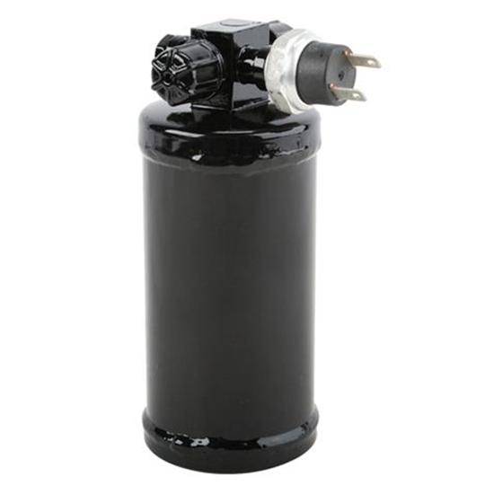

What is a cut-off switch?
A cut-off switch prevents the compressor from engaging when it senses there is either too high a pressure or too low a pressure in the system to prevent damage. It works in conjunction with a sensor. They're typically included on R134A conversion kits.
There are also rpm related switches on newer systems to prevent damage from high RPM use.
OK, I've heard of that on GM cars, nothing like that is mentioned in the shop manual for the 66.
Compressor wire runs to the sensor on the dryer first and then to the compressor. Sensor breaks the circuit when tripped and compressor can't engage. Not sure if it does high pressure too, but definitely low pressure.
