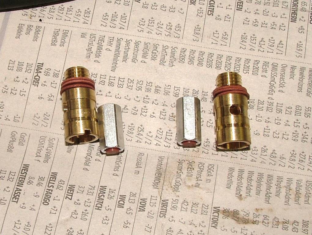

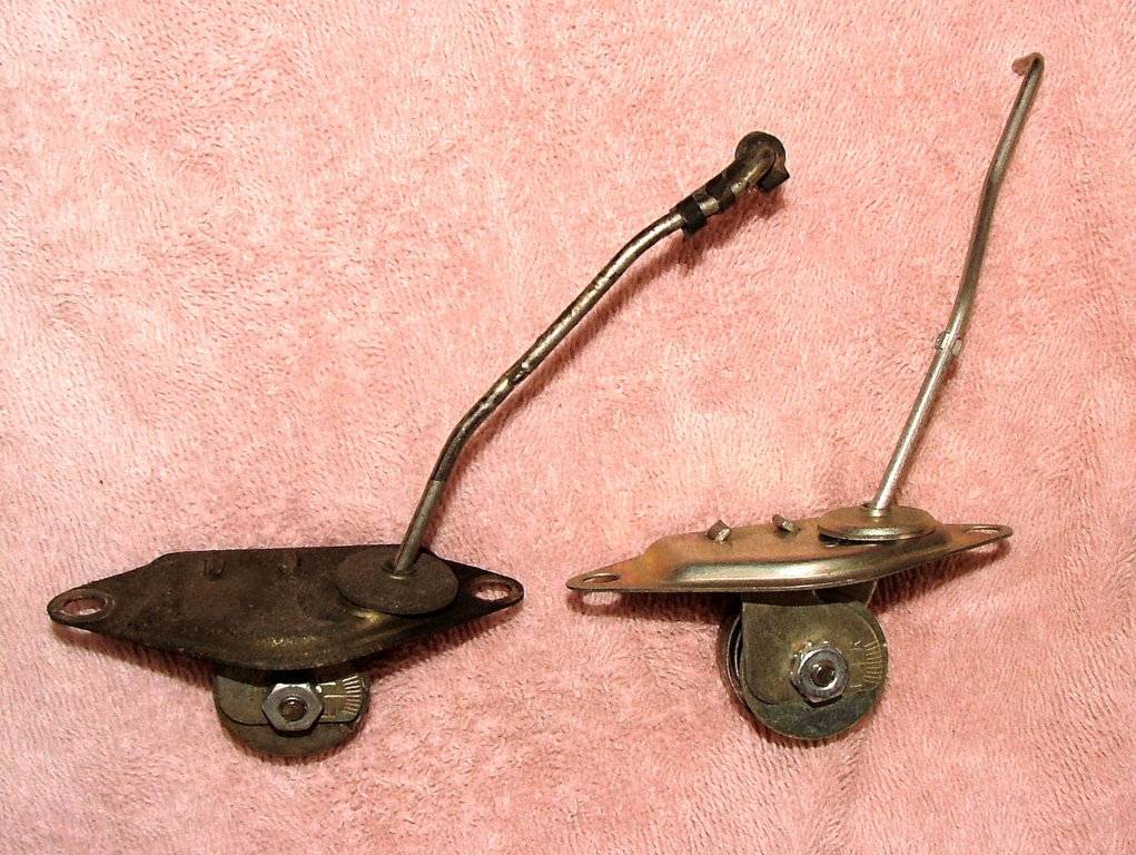

Finished up the carb last weekend. Found the floats were not moving freely, wound up putting back the original floats and needle-seat assemblies. Float levels were right on. I put the carb back on and it ran better but was missing, so I replaced the spark plugs. The old ones were seriously gas fouled, no surprise, now it runs good. I also put the old choke unit back in, it connects without binding but does not open all the way when warm so I disconnected it again. Drove the car, what a difference! I'll drive it a while like that and hopefully burn out some of the carbon slowly, but I will have to revisit the choke before winter.
Overall I'm not happy with the Daytona kit. They were very helpful on the phone but the kit had issues with missing and incorrect gaskets plus their needles and seats did not work for me, IMO not worth the price.

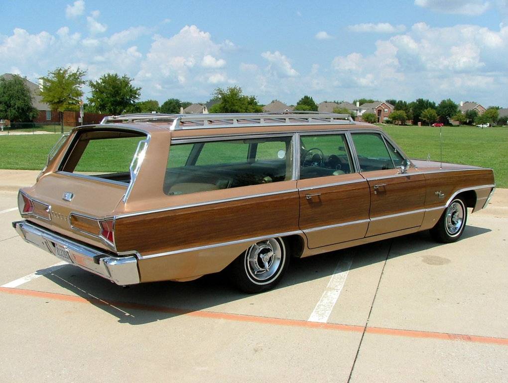

I took the wagon for a longer drive yesterday including some freeway time. it does cruise nicely at 70-75 with those 2.76 gears. The ride is very nautical and it really bounces on dips in the road, my to-do list includes new sway bar rubber in front and new shocks with helper springs in the back, I may also tighten the torsion bars a turn or so and see if that helps. One thing I have to add to the list - I have no kick-down passing gear so will need to look at all the linkage.

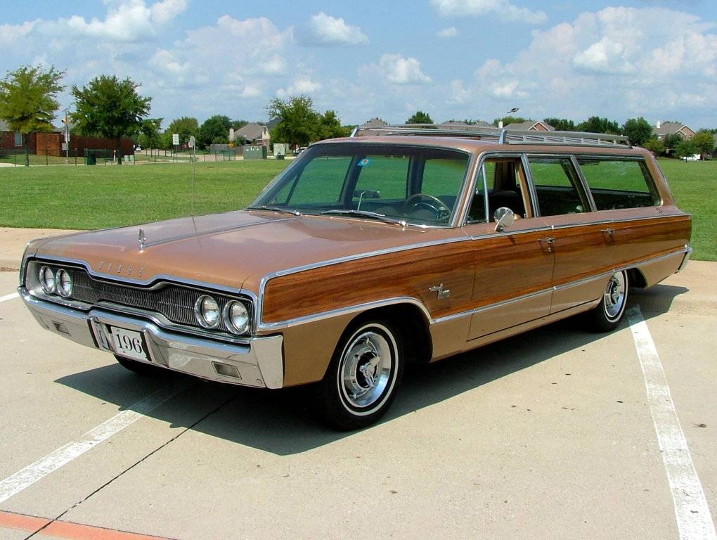

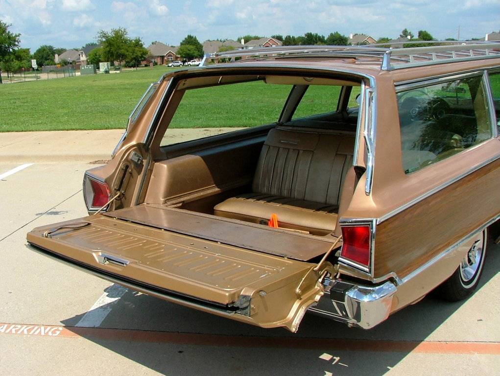

I also took some new photos...
She looks wonderful!

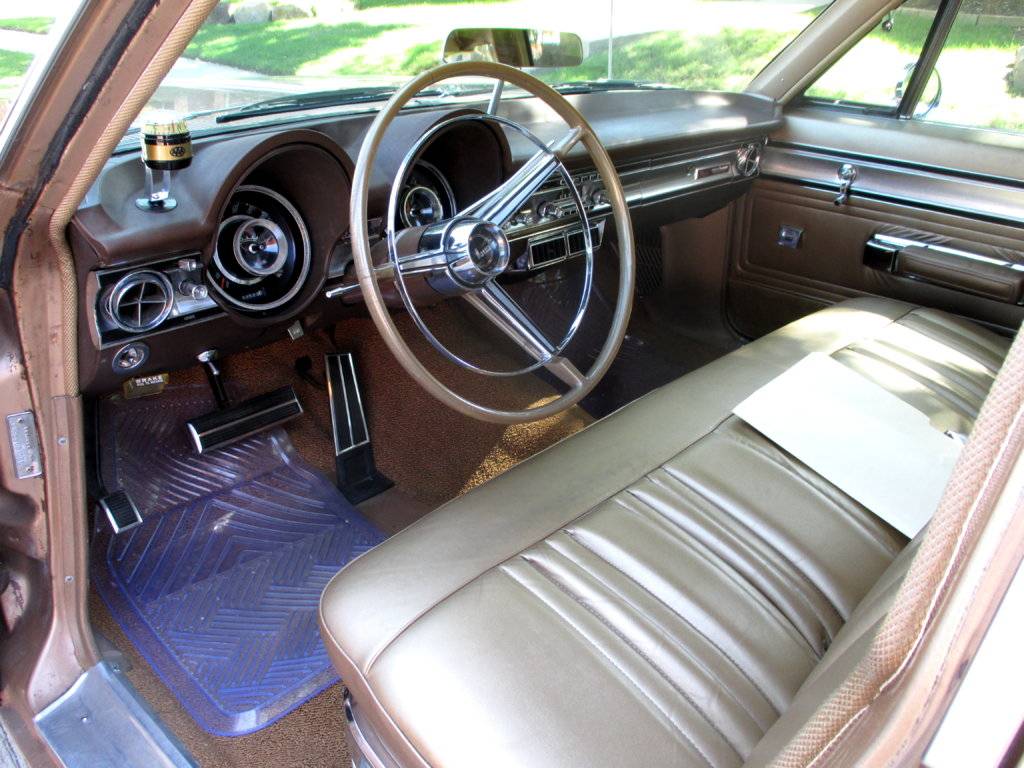

What's the device on the left corner of your dash?

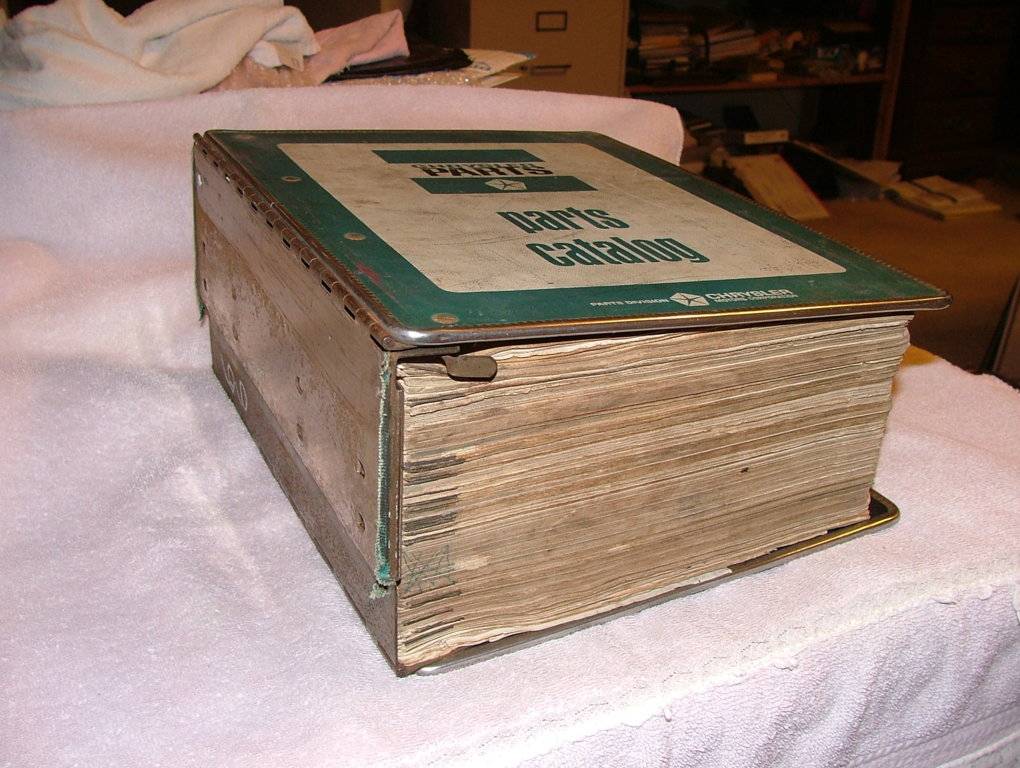

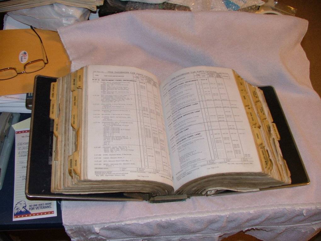

I just found a 66 full line parts catalog. It's parts counter fresh with the metal covers and most of the divider tabs. If anybody needs a number lookup let me know.
