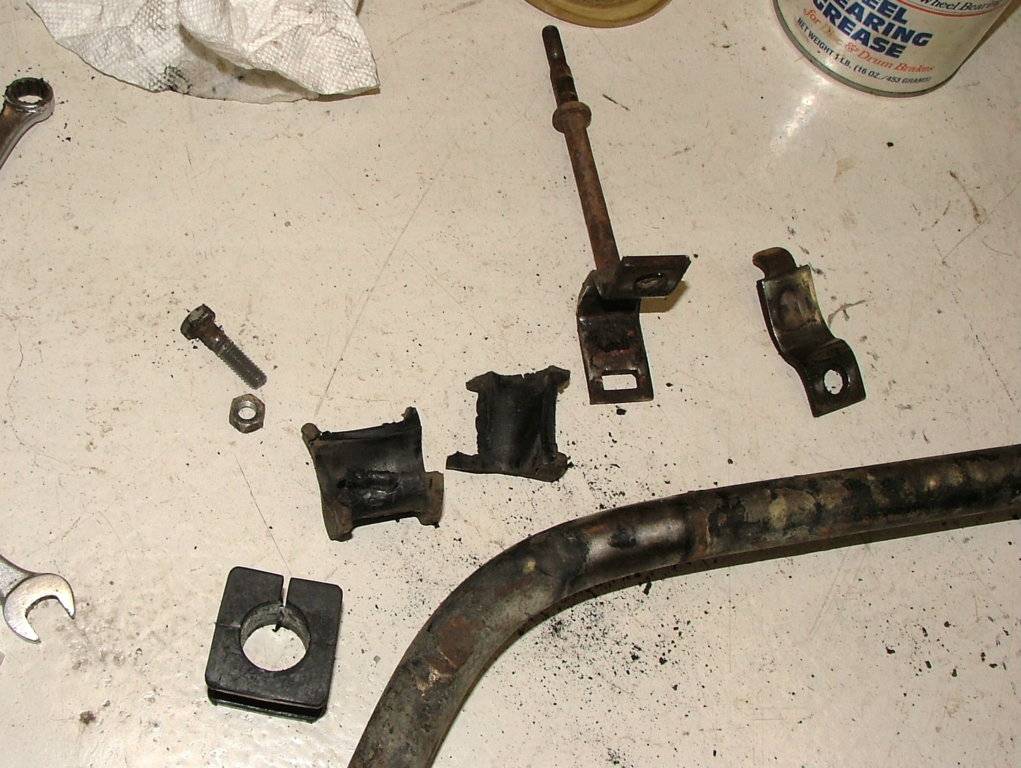

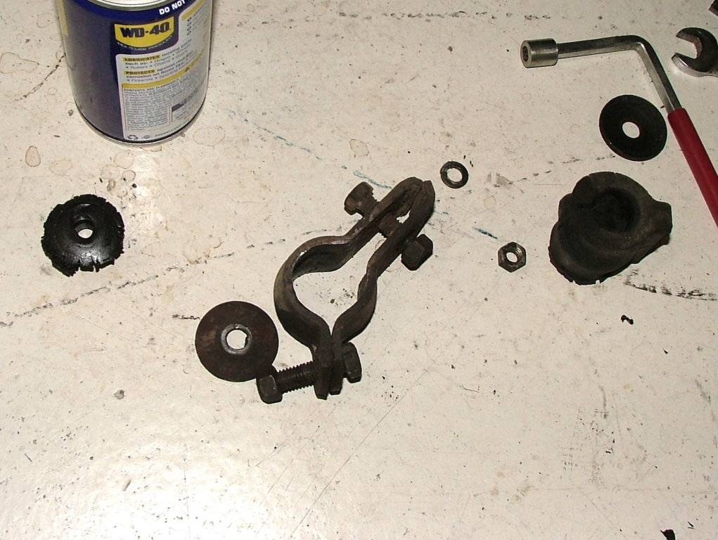

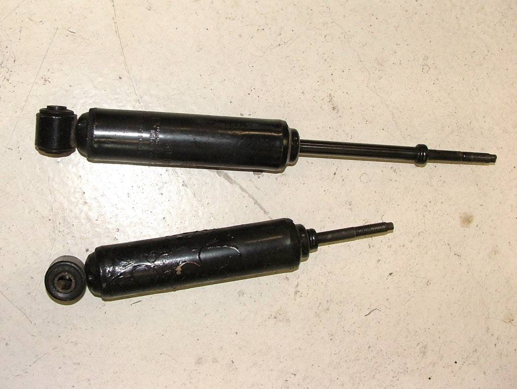

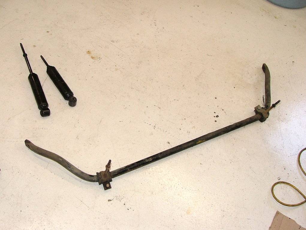

I took the last couple of days and worked on the front end, replaced the shocks and all of the sway bar rubber. I was happy to see that there were no rusty bolts and everything came off easy. The sway bar had been done before as both the frame supports and end links were the bolt-on type. Pretty easy install, although I forgot and tightened up one side then was surprised when the other side wouldn't fit! The shocks looked fairly new but one had no gas in it and squeaked when the rod was moved, definitely shot. I took it for a ride today and there is a big improvement, no more bottoming and porpoiseing and no more tire squeal on turns. The rear shocks are next.

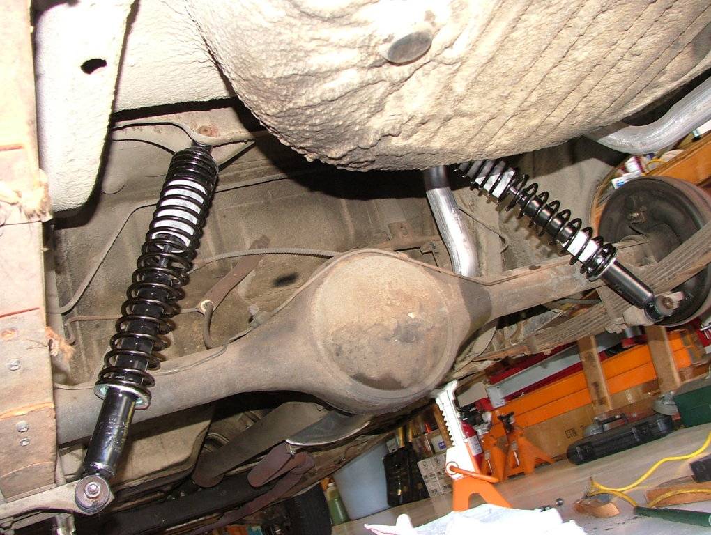

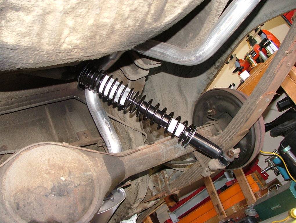

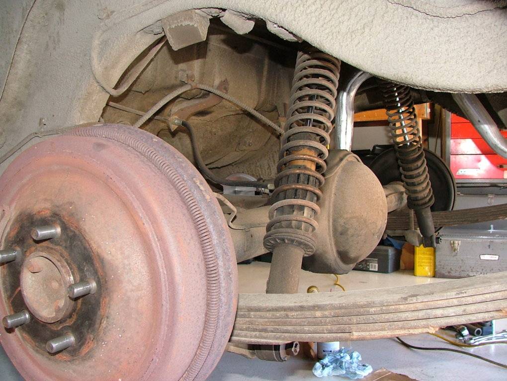

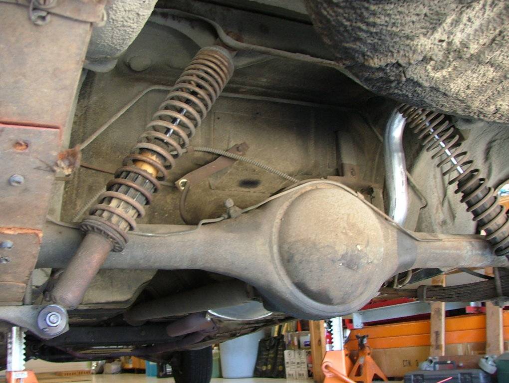

Finally a break from rain and unseasonal cold in north Texas! I took advantage of some nice summery weather to install my rear shocks. This was a much easier job than the front shocks / sway bar, whole thing done in 3 hours including lunch break. The old shocks were both leaking, new are the same load leveler type. The ride is now even better, still a little boat like befitting the car's heritage but no more bottoming out.

Are these the ``hi-lift`` shocks from the option list?
What are the road manners like with them?
These are not factory style shocks as far as I know. They are regular Monroe gas shocks with coil helper springs around them, designed to keep the rear from sagging under load (and maybe also compensate for old sagging leaf springs. The ride height is pretty level but I would actually prefer the rear to be a little bit higher. The car rides smoothly and is a bit floaty even with the new shocks but if you hit a sharp bump you can feel the helper springs kick in.
I agree with the ride height.

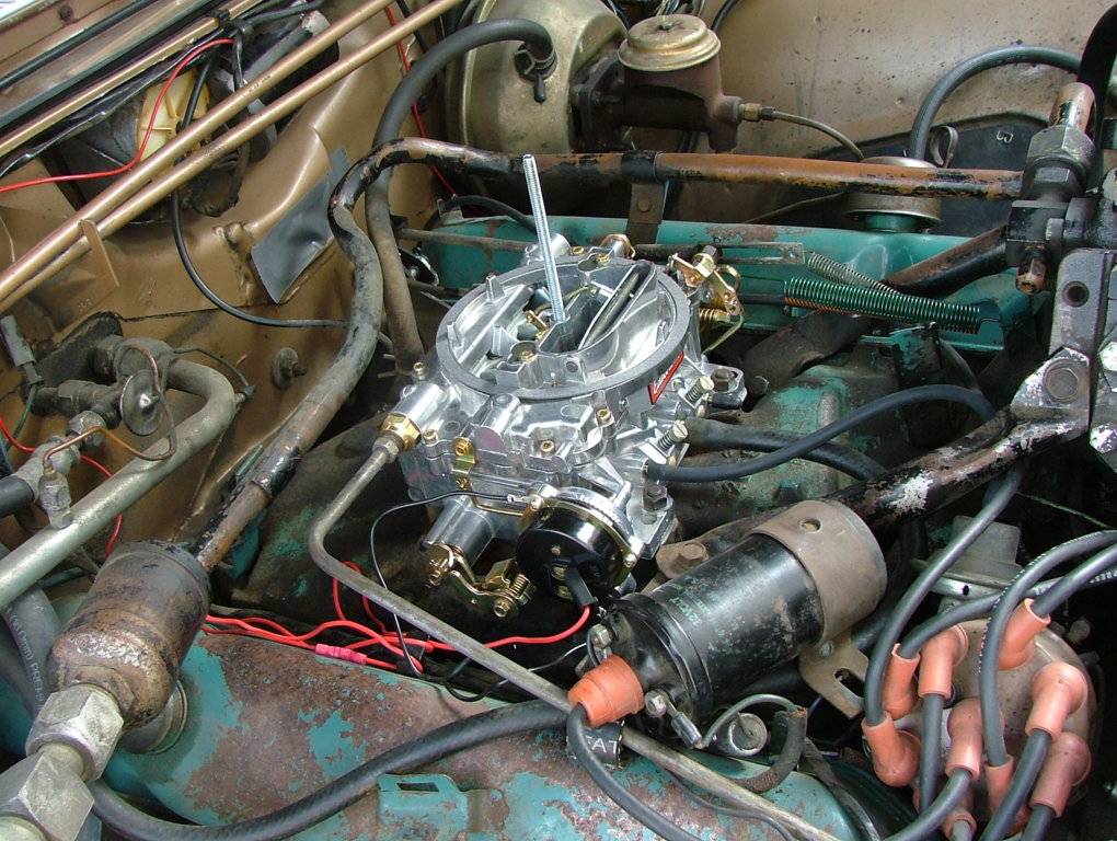

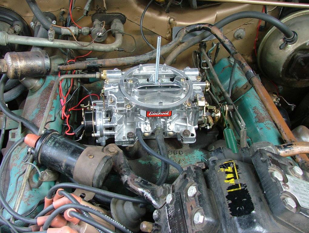

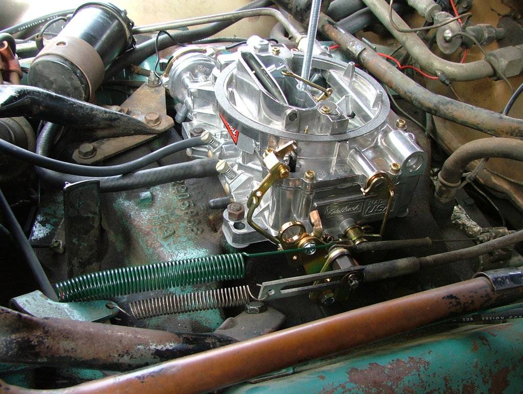

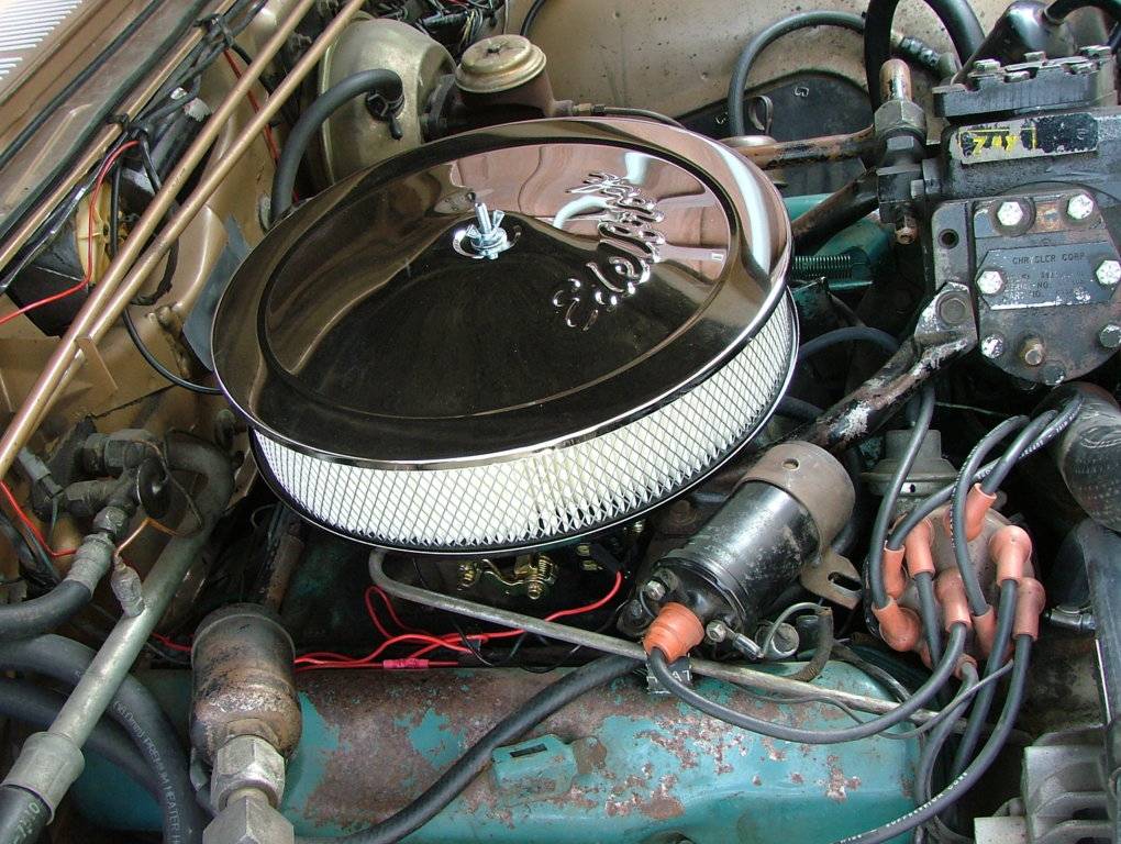

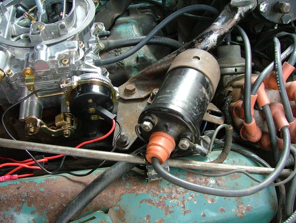

I'm back after almost three months and finally a little progress. My AFB never ran right even after two rebuilds and the choke never worked. I wasted time trying to rig a manual choke unsuccessfully but just wound up with a car that was a ***** to start and always ran too rich. So like many before me, I finally gave up and bought a shiny new 1406 Edelbrock. I used the Edelbrock Mopar linkage adapter and found a fitting that let me retain the original metal fuel line. I did the whole conversion in less than a day, the most time consuming part was wiring the electric choke to the accessory fuse under the dash. I had to do a redneck relocation of the coil to clear the choke housing but I'll improve on that. This is the third car that I have adapted an Eddy carb to and I have to say they have all run pretty much perfect out of the box as advertised. The car is now a pleasure to start and drive - on to other issues.
Good news! My car runs great on that carb also.
Strange my stock air cleaner fits on with no adaptor.
