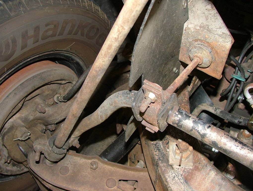

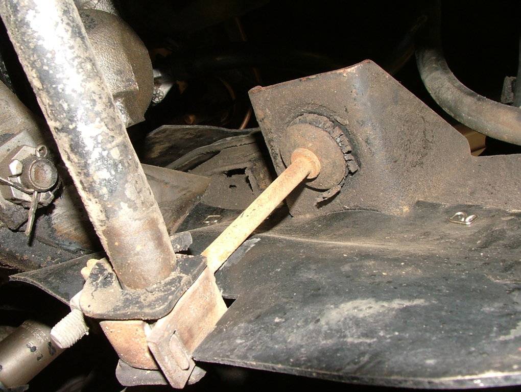

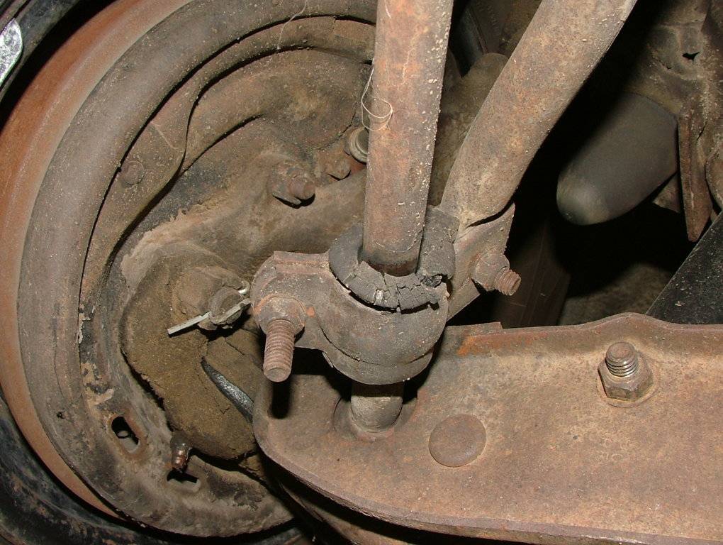

I also got under the car and took a better look at the front suspension. All the linkage is tight and the balljoints and CA bushings are good. The swaybar linkage is really bad with missing bushings at the top of the support rods, no wonder I hear some clunking. I also think I may replace the front shocks, even though the PO said they were done it moves too freely on the bounce test.

How about that LH side torsion bar bushing that looks pretty bad? It seems to be cracked.

Are you referring to the sway bar bushings? They are all cracked and some are partially missing, I have already purchased new Moog replacements.

Maybe the strut rod bushings is what he is referring to.

I refer to the bushing around the straight bar visible on the last picture you posted. If I was looking right that straight bar would attach to a lower point of the lower A arm and a bit closer to the brake than the anti sway bar. I hope my explanation helps.
Oops! I was thinking that the car was ```mirrored``, so that pic was taken from rear to forward and not vice versa.
