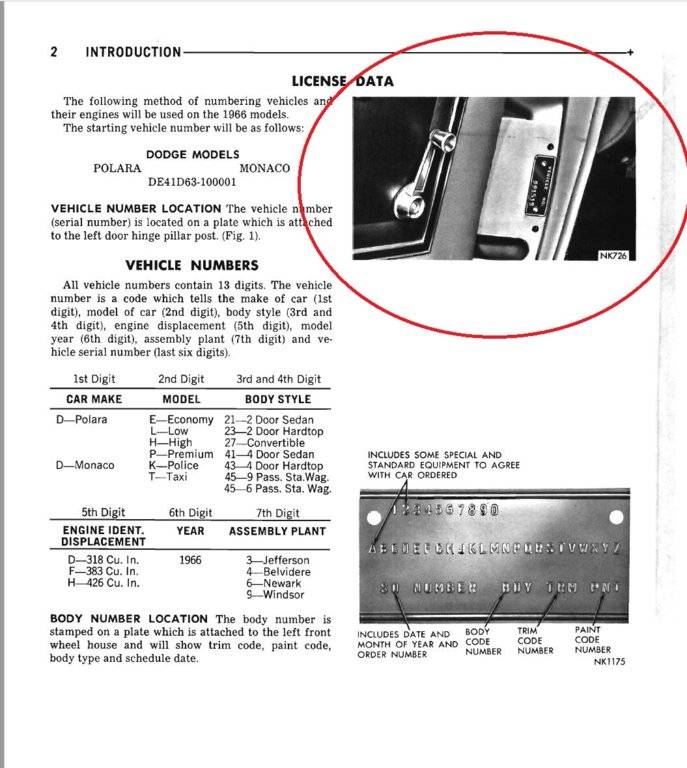

Hey guys, the FSM says that the VIN for this car is located on the driver side door post up by the hinges.The owner says there is nothing there. Could it be anywhere else on the car? Stamped in stub frame or firewall or anywhere else on body? I Can't buy a vehicle without a VIN and do anything with it up in Maine.Thanks
No, that is the only VIN on a 66
Certi-Card & Broadcast sheet can match the data plate to the car but that is the only VIN
Alan
Thanks Alan, turns out the guy was looking in all the wrong places.Hopefully will have it by tonight.
