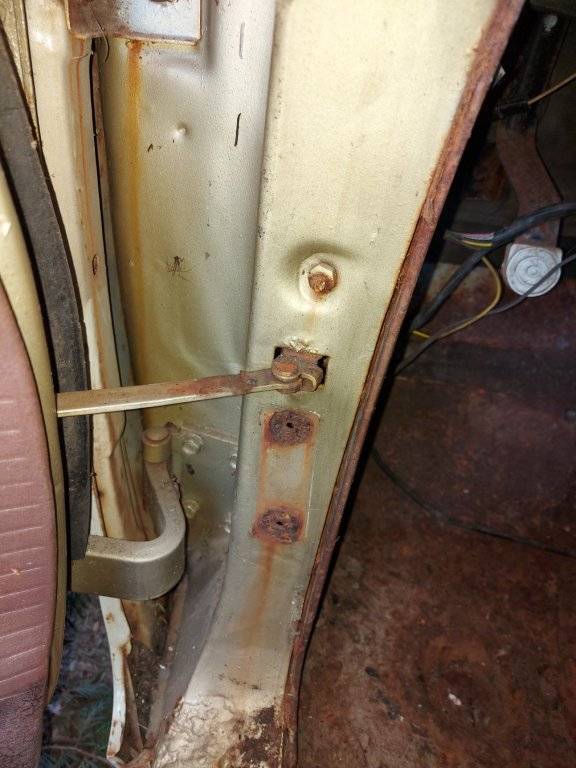

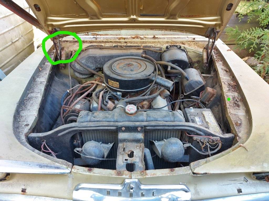

these are pics from a 59 dodge i nearly bought, it too is missing the tags. you can see the holes on the driver's front door jamb and right side cowl/firewall where the tags were. i assume the door jamb tag would have been the VIN and the tag on the firewall the body info tag

Your '59 was imported by a private individual so it could have been built at Hamtramck (Dodge Main) , so you would not have had a VIN plate attached to the "A" post , instead you would have had a stamped rectangular plate attached to the cowl with the Vin stamped on that along with other info. Factory exports were shipped TKD (totally knocked down) usually from Windsor Ontario. Those cars would have had the stainless steel VIN plate on the "A" post , with a Model code plate attached to the Passenger side of the cowl. Hopes this helps....
The car has outline marks on the door post of a VIN plate.
