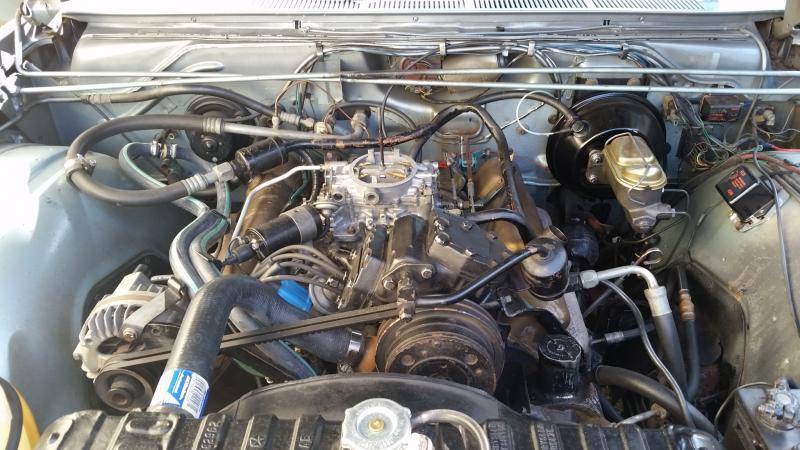

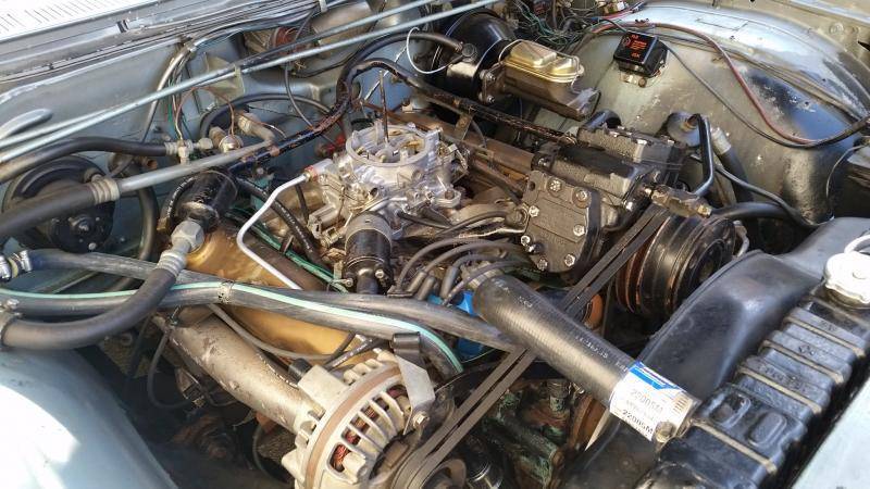

Just wanted to give "Blue" some face time. Had carb rebuilt and spent Saturday dialing it and the timing in. Had problem with hard starting, but advancing the timing to 12.5 BTDC the car started right away. Thinking I was down easy street I took the car out for a drive only to find it began “knocking like crazy”. I started retarding the timing little by little beginning at 10d, 7.5d then to 5d BTDC. At 5d BTDC the engine initially ran without knocking, but became apparent at cruising trying to maintain 65mph. When the engine was shut off, it again was difficult to start - realized the engine didn’t like being retarded as much.
Began thinking some more about the situation and started thinking that since the engine was knocking under acceleration/load the vacuum advance came to mind. Thought about the Vacuum Advance Control Valve and went through the Service Manual on adjustments. The manual says it should pull 6 in. mercury but saw it was pulling 10 in. Tried to remove the VCA’s cover, but due to its location the cover was impossible to remove let alone adjust the spring. In order to access the cover the bracket holding it would need to be taken off, however it was secured by one of the intake manifold bolts. For obvious reasons I decided I didn't want to do that. It was late and getting dark so I called it a day and back to my think tank.
This weekend I think I'll just bypass the vacuum adv and run the distributor as as if it were a mechanical advance unit. I’ll just need to figure out the total advance curve and reset the timing accordingly. I’m pretty sure the knocking will stop if I do this. BTW, I do have Supreme (91 oct) in the tank.
Plugs, wires, cap, rotor, points, condesor replaced. This is a stock 383 2-barrel car, but carb upgraded to a 4-barrel Carter 3611S. Timing 12.5 BTDC, Points gapped at 0.17 and Dwell set at 30 degrees (28-32)
I have a Pertronix Igniter II and Flame Thrower Coil (40Kv) yet to install, but wanted to get to whole ignition system dialed in before I made any other change and end up chasing a new sympton.
Any ideas and/or suggestions welcomed.

I bypassed the vacuum advance and that didn't make a difference. I then drained the gas tank and put in 100 octane race fuel.
The pinging was reduced significantly, but was still present - however there was a VERY noticeable difference running on the highway. I pressure tested the vacuum advance diaphragm and I believe there is a leak in the diaphragm. I have a pertronix igniter II kit, but rather than get a replacement diaphragm I'm just going to get a Proform electronic dizzy & module from Summit http://www.summitracing.com/parts/pro-66993/overview/

Mine has the 440, but it also is pretty sensitive to ignition knock. If you saw no improvement with the vacuum advance disconnected, I wonder if the ignition is your problem? IMHO these cars are sensitive to lean fuel mixtures, is it possible you have a vacuum leak? Try spraying brake cleaners around the usual subjects such as carb gasket, vacuum hoses, etc. The leaking vacuum advance might be one, but since you said it was bypassed... Put an old fashioned vacuum gauge on it, it may give you some clues.

That's a really nice Wagon! Regarding your Disributor, are the centrifugal weights inside the dist. moving freely? It sounds like they may be binding or sticking causing lack of advance? maybe? But a new distributor will probably fix the problem.

michiganhotrod, I did the brake cleaner test = No vacuum leak anywhere. Rebuilt carb, replaced all vacuum hoses, by-passed vac adv, retarded and advanced timing = no change, pressure tested vac diaphragm and didn't see weights move, but pressure would not hold so I surmised the diaphragm was leaking... I'll go back to the drawing board after I get my front suspension all put back together.

sounds like you have a mech. adv. problem. take the rotor button and see if you can turn it one way or the other and it should spring back to were you started. if it stays were you turn it you have issues in the mec. part of the dis. you should be able to run 12 to 18 degres of static timing with it having any valve pinging probblems. how do the plugs look
rumpfox, I'll double check the rotor button tomorrow, but I'm sure it does spring back when turned either direction. The weights are under the breaker plate so I wasn't able to check them unless turning the rotor button is doing the same thing. Plugs look great as they should.
