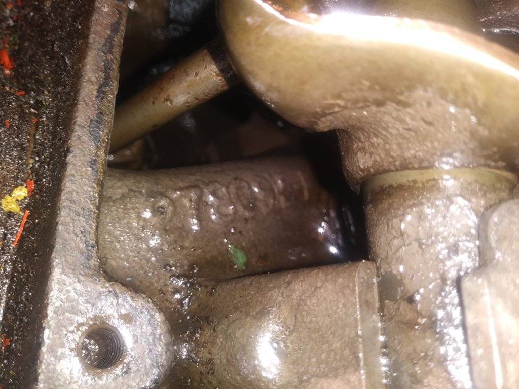

take some pics of the casting numbers swisherred
2780915-1
Score.
I had a set done, new valve guides, valves, springs, retainers, expanded valve to 1.74, hardened seats, very minor bowel work on exhaust, and slight milling to to true surface. $900. That was about 5/6 years ago.
They are 915....very clear casting towards upper front between 1st and 2nd set of valves.already changed the gasket and reinstalled
I’m really surprised and happy to be wrong in this case.
