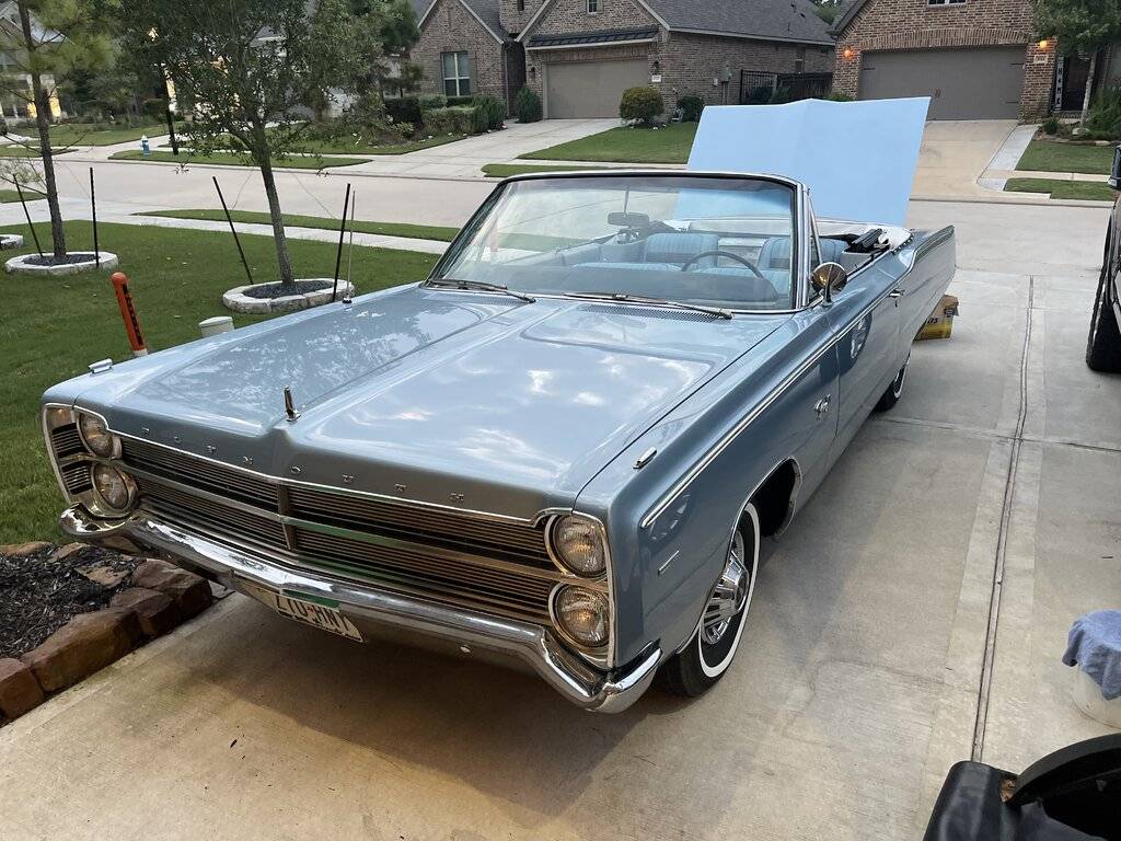

well, after decades of rotting in storage i brought her home today. i drove her from college station to houston. i was scared to death something would go wrong but amazingly enough we made it!

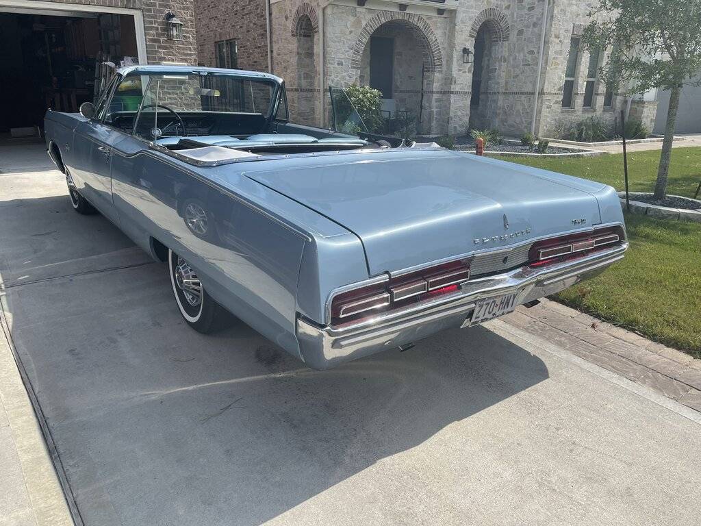

and so it begins... anyone know why my tail lights will not shut off? i have turned the light switch on the dash all the way to off - not in park or 'lights on'. for now i have had to pull the ground cable off to prevent the battery from dying. i cannot get the tail lights to shut off.

I'm going to suggest its not the tail lights, but the brake lights. If so, likely from a weak or bad brake pedal return spring, or an out of adjustment brake light switch at the pedal. Not uncommon on a car thats sat for years.
It its truly the tail lights, you'll need somebody smarter than I to diagnose that.

and you sir were 100% correct! thank you.

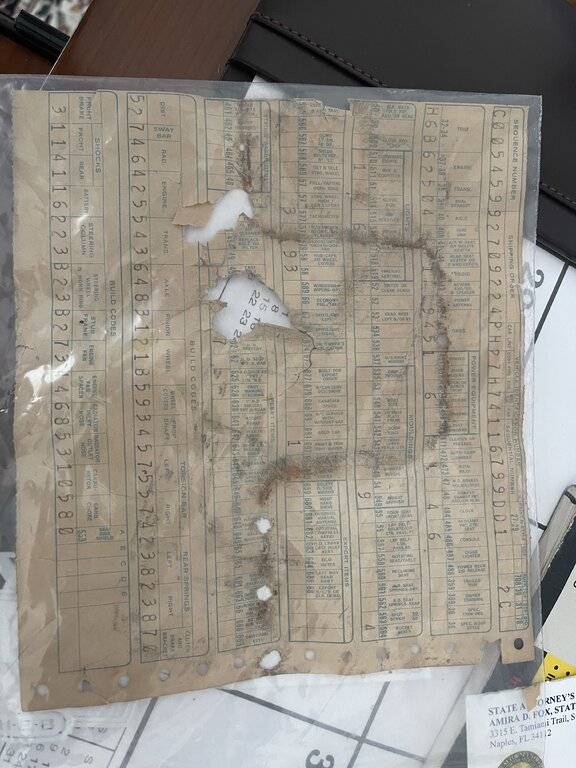

i apologize, i should have stated it has been at the restoration shop in Bryan TX for almost 18 months. from there it had lived the past almost 25 years in a half dozen different storage locations across 4 states. it was just something i could never let go. to see it in my driveway and driving it now is a bit surreal. i found under the front seat that piece of paper you find in new cars that tells you the original options selected at the factory. also, in the engine compartment is a metal "credit" card (not sure if it was a dealer or factory thing) in a sleeve against the frame that has my grandfathers name and address stamped into it the day he bought it.
i should add, this was the 1st car i ever drove or had. i drove it in highschool before having a small accident that put it out of commission. that small accident required me to replace the front sub frame during the restoration process. it wasnt a bad accident by any means. there was just a tiny hump in the front frame pillar. it was still easily drivable but it needed to be replaced - not straightened. we found a subframe quickly!
does anyone know how to decipher that "build code" sheet? im googling with little luck.

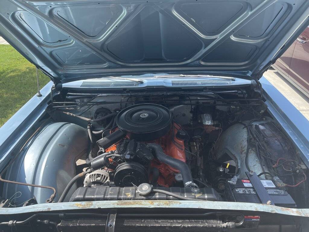

i have a question but i think i am going to phrase it a different way so as to not badger folks on this forum on a daily basis. I need to know the size of the belt tensioner bolt for my AC compressor belt (318). I am going to see if I can get the AC working, I bought a belt today. However, i noticed the tensioner bolt is missing. I do not know what size bolt it is. Is there a good reference i can buy that will have answers to mundane questions like this?

That "credit" card thing is called a Certicard and was found in all Mopars up until, I think, 1972. I could be wrong on the dates. That's a great find and beautiful car, congrats for keeping it going. Also try Vans Auto Parts in Waupun, WI or Nationalmoparts.com in Oregon for your tensioner bolt. They both have tons (and I mean tons) of Mopar parts, everything. Vans ph #920-324-2481
