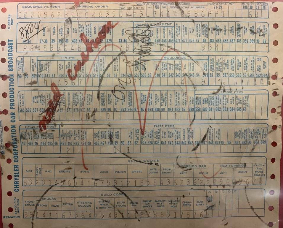

Looking at my broadcast sheet. In the upper right hand corner under box 31 it says STP which I believe to be stripe? In that box is what looks like a 3? Car is PP1 with a black vinyl top. The TOP box is marked 6 which I'll assume is black. What color is 3 for this stripe? And was this a tape stripe or were they painted on? Is there any documentation for the size/shape and exact placement of these stripes? Thank you!

I don’t know what the various numeric codes mean, but it looks more like the number 8 in box 31, not a 3.
I don’t know what the various numeric codes mean, but it’s a number 8 in box 31, not a 3.
318 stripe delete
Or
31B Black accent stripe.
I think it's an 8. Picture of the fender tag?

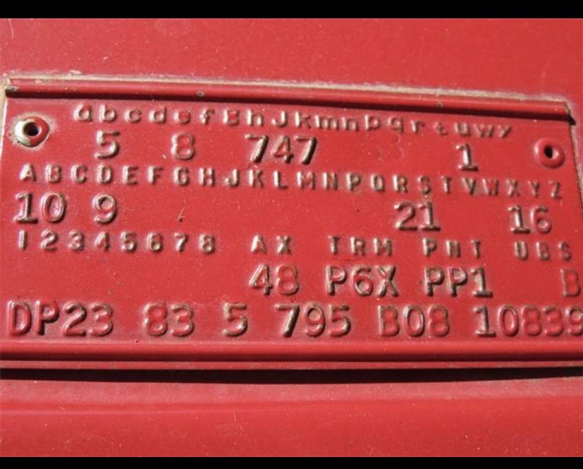

Looking at the other 3's on the sheet I think you guys are right. It's either an 8 or maybe a B. I have attached pic of fender tag.
Looking at the tag now i see "B" under the s. Black stripe I'm assuming. Now, I am just in need of some info on the exact size and placement. I have found a few pics of cars online that have what look like a thin, dual pinstripe following the upper body line. No real close ups though to get a feel for the spacing between the stripes.

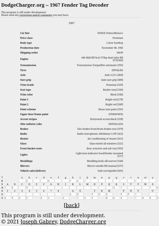

Here's a rough decode of your fender tag.

Production traditionally for the model year typically ran from August through mid July so November 66 would be around mid ‘67 model year.
