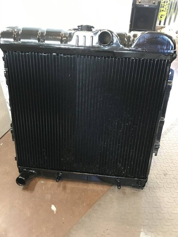

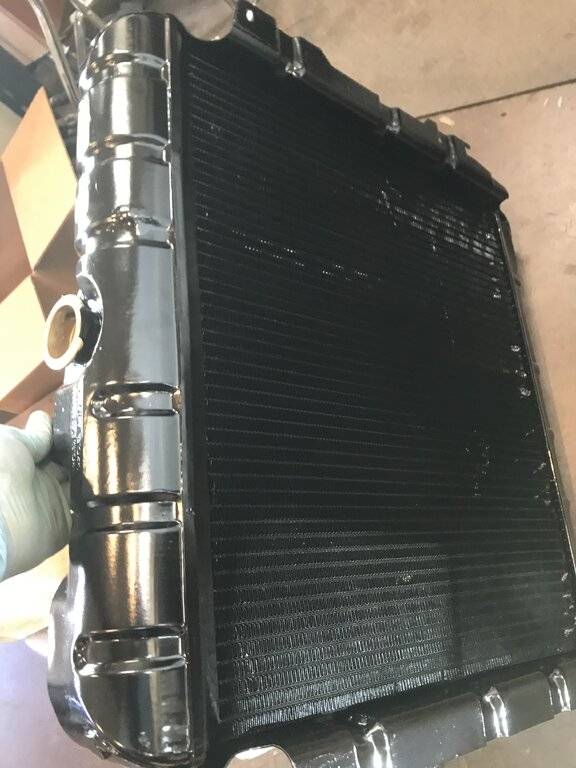

    If you don't mind my asking, what was the cost on the recore? I am guessing$4-500, I haven't had one done in a long time.
  2. HWYCRZR
    HWYCRZR Senior Member FCBO Gold Member
    Messages:
    3,155
    Likes Received:
    3856
    Joined:
    May 13, 2015
    Location:
    Fargo, ND

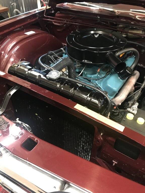

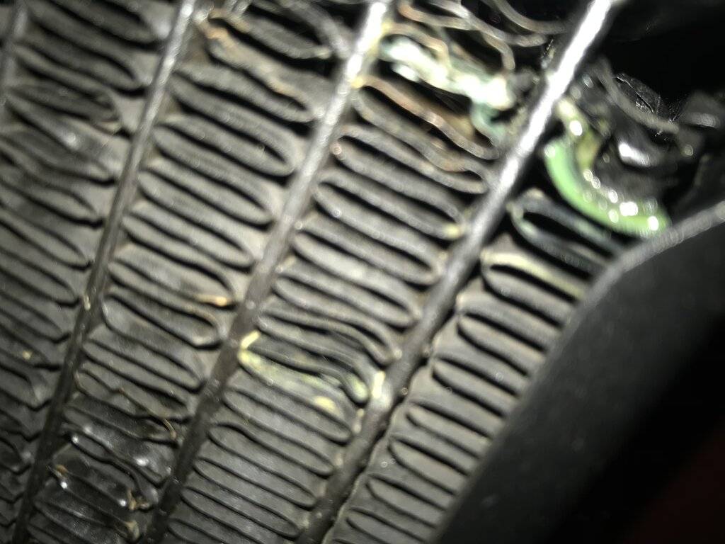

    There was another thread on here just on recore costs. It seems to be pretty regional. In ND I was quoted $600 for a 22” 2 core. I upgraded to a high efficiency 3 core which ended up being $700. I seems the larger radiators are less maybe more companies make the larger cores. supply and demand.
    Many in the East were around $5-$600
    Radiator Recore Cost

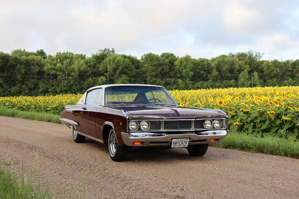

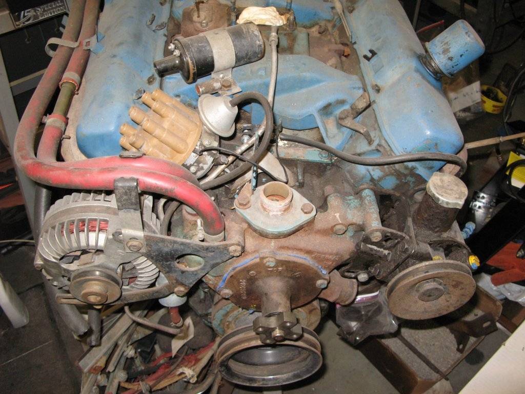

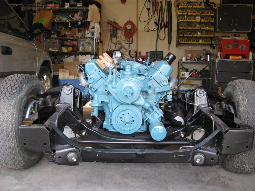

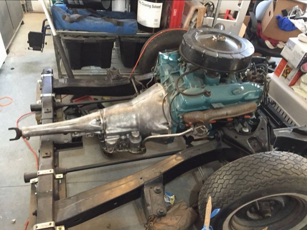

    A couple more pictures to keep with this thread.

    Before during and after.
  6. HWYCRZR
    Messages:
    3,155
    Likes Received:
    3856
    Joined:
    May 13, 2015
    Location:
    Fargo, ND
    1986
    2020
    • Like Like x 10

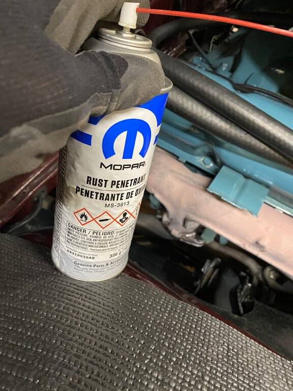

    Getting it ready for winter.
    I put another 2,205.5 miles on this summer.
    That is 4,100.7 miles since May, 2019 after the total restoration.

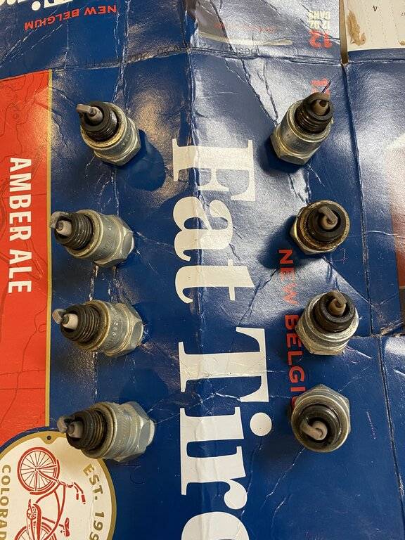

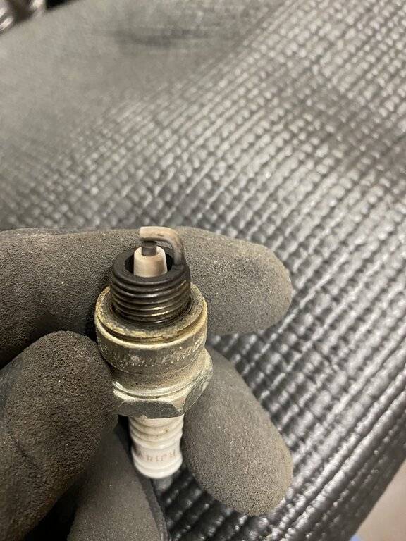

    Changed the oil, Lubed the exhaust cross over valve and checked the plugs. Everything seems to be in order. I was thinking I was running a little rich, but the plugs look about right I think. All were very even.
    Only issues I had this summer was a broken ballast resistor which took out my points after limping home 50 miles, and a radiator re-core.
    Next steps prior to winter, change fuel filter and rotate the tires.
    Winter projects, send carburetor for a total rebuild, fix reverse lights and try to tighten up gear selector column (maybe some of my reverse light issue. Otherwise I am ready for spring.

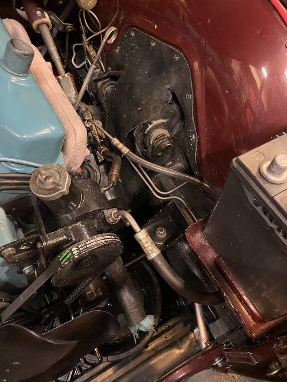

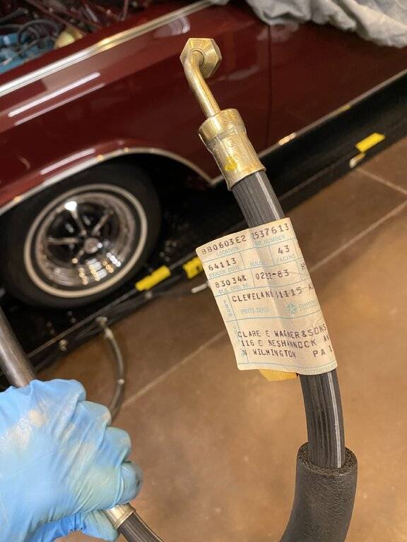

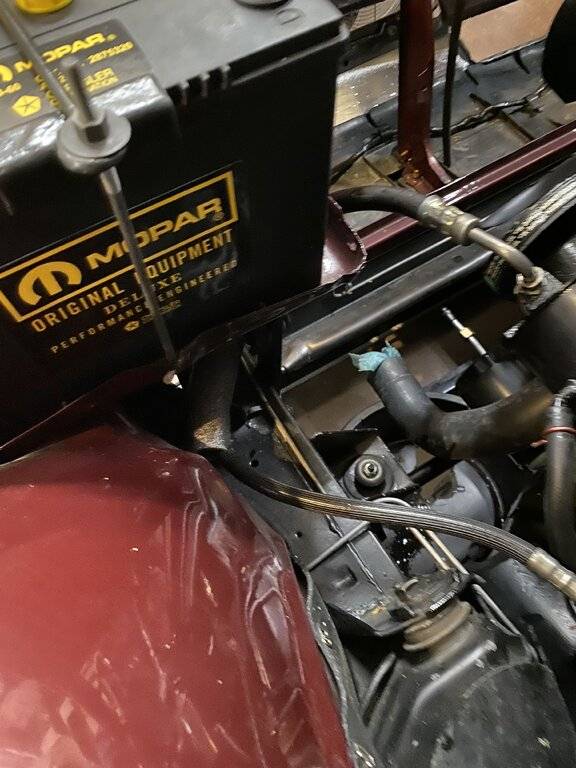

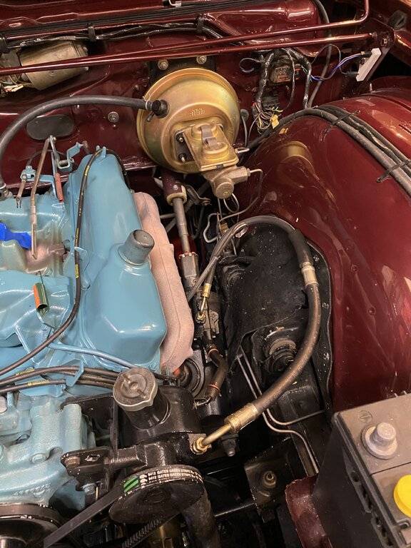

    My desire for perfection struck again. This time the power steering hose wasn’t quite right. I had a good routing that ran under the battery tray and back up to the pump. The problem is I kept seeing original pictures where it went towards the brake booster then looped around on the inner fender. I looked up the part number and started googling. It seems mine was a little different than the original p/n. It had a longer metal end on the gear side and was a little longer overall. So I found an NOS one on eBay and ordered it.
    Before routing. It was actually a decent routing. The larger hose likely had a little tighter diameter bend than the 10” diameter recommended.
    AE3E26E7-C82D-4200-9D42-B955743C9D56.jpeg 7BE07399-7A49-45B6-8DBB-DB6219CC1535.jpeg
    New hose and after routing. I think my routing was better.
    I followed the Technical Service Bulletin.
    4D0976B6-F4BC-4336-91BF-5D66D036BE28.jpeg 43BC5717-F9DC-447D-A09C-F4AE7DB6381A.jpeg 4F85D316-E390-4EC9-B774-6343866B9EDC.jpeg

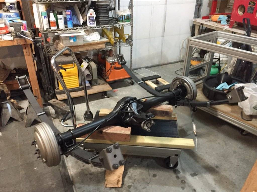

    My springs were taken apart and cleaned and rebuilt with a kit I got from Year One back in the days when they had a C body catalog (kind of). I don’t remember where I got my Shackles. Year One only had them for A bodies. I will have to see if I can find the invoice.
