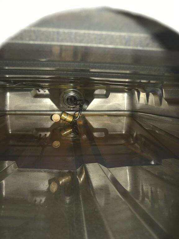

    I Spent some time chasing down my fuel sender accuracy. My repop would only go to 3/4 tank. I was recommended to try the Meter match by Big John. At the same time I decided to try and rebuild my original sender. Everything checked out on the bench but was getting some crazy readings. Come to find out my original one was twisted and did not sit flat in the bottom of the tank. Got it squared away now. And goes to full and seems accurate. I haven’t used much gas yet to verify the low end.
    Fuel Sender calibration using Meter Match

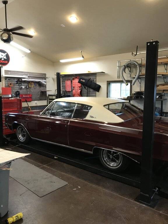

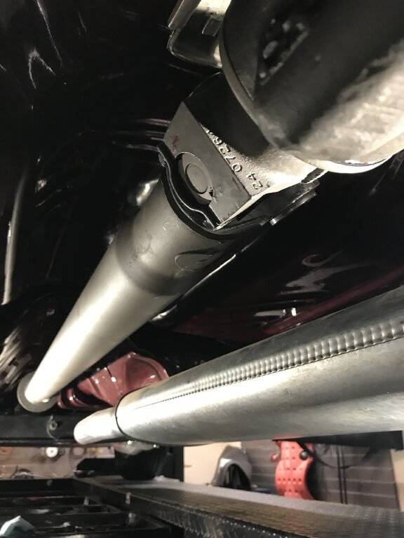

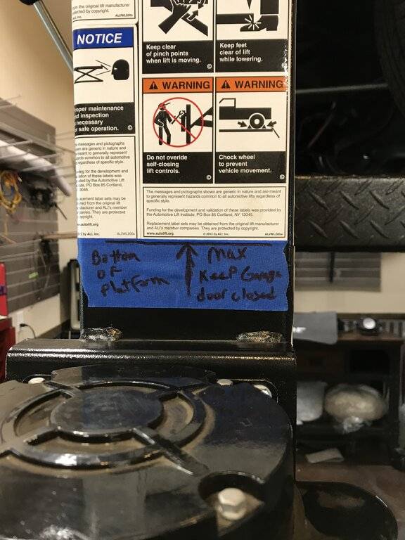

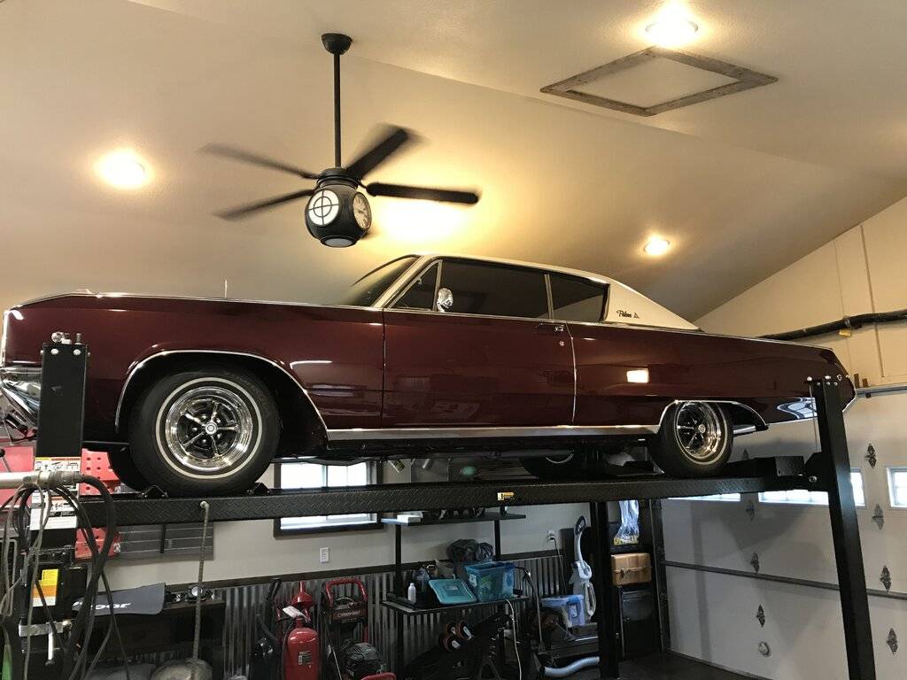

    I got a lift last weekend. Direct Lift Propark 8 plus long. Finally after I am done with the restoration.
    Anyway I found my vibration issue at 80 mph. I think it was creeping lower. Turns out I had a bad U joint. It was tight torsionally but could move it up and down in one axis. Around 2,000 miles. The lift made it easy. I replaced it and my vibration doesn’t start until I get close to 90 mph.

    I think you can set the stop kill switch at a lower height--or at least relocate it so the hoist will not go any higher than you want to.

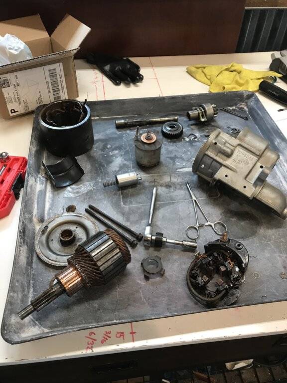

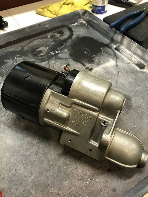

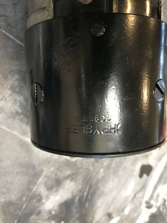

    Since I had easy access to the under side I decided to pull my starter and re build it. It was sounding a little slow. Seemed even slower when the engine was warm. So I tore it apart, cleaned the brushes and armature and installed new bushings. Turns much faster now.
    Chrysler Starter disassembly and refresh.

    No limit switch. The hydraulic cylinder runs out of stroke at the top. No wiring to the towers or cylinder. When I am working on it, the optimal height is one stop below my self imposed maximum. If I go to my max with the car on it I really have to reach higher than comfortable and I am about 6’3.

    Found my vibration for real this time. Finally sent my drive shaft to get either re-built or balanced. They ended up straightening one of my u-joint ears and about 3 other places along the drive shaft. Then they re balanced it. I also did some pinion and transmission alignment. Now I can get up to 100 mph with no vibration.
    Thread on pinion alignment and drive shaft.

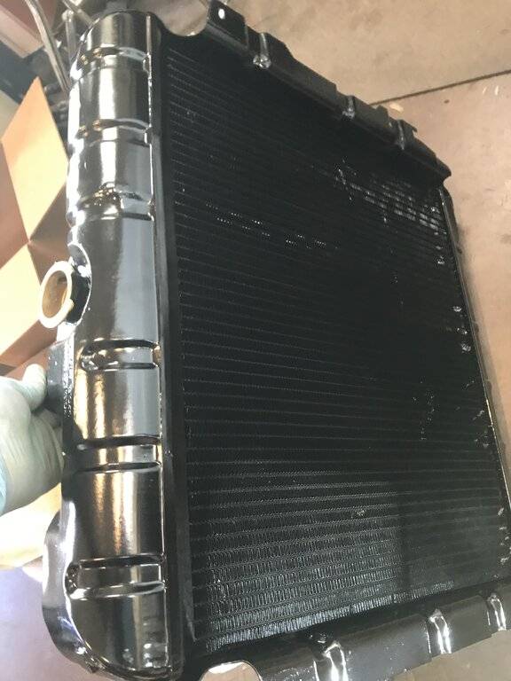

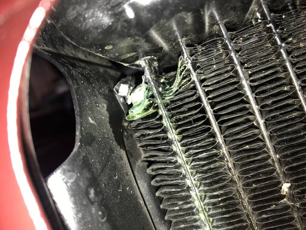

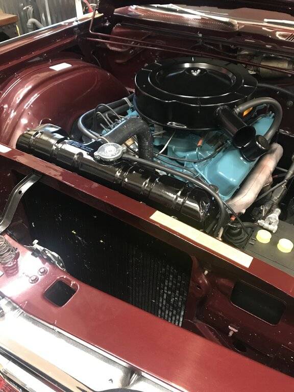

    The reason I started messing with my drive shaft was due to my radiator being out to get re cored.
    I was starting to see some green among a couple of rows. Not enough to drip yet but starting to seep. Found a local shop that still re-cores.
    Went from a 2 row std core to a 3 row high efficiency core. I should be good at any temperature.

    Looks good. FWIW, I'd get some screening from the hardware store and make a bug catcher for that nice new rad.

    You are spot on. My trial runs were at dusk so I collected more than I liked. Dad used to put one on this car. The grasshoppers in Montana could plug up a radiator quickly.
    I need something just smaller than the fins. A regular screen blocks about 1/3 of the air flow. (I have had to work with our engineers on machine cooling tests)
    But with more capacity now I am probably ok.

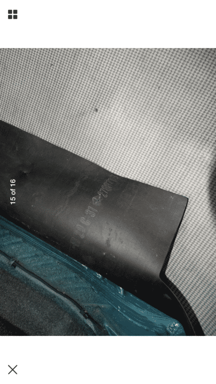

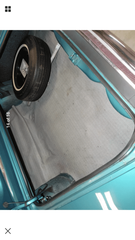

    Thanks for the offer. I have the shape, it is just the print pattern that seems to be elusive.
    Trunk Mat Truths. What’s correct?
    The material pattern I need/want.
    from a beautiful convertible on e-bay a few years ago. Original trunk mat with the P/N still on it.
