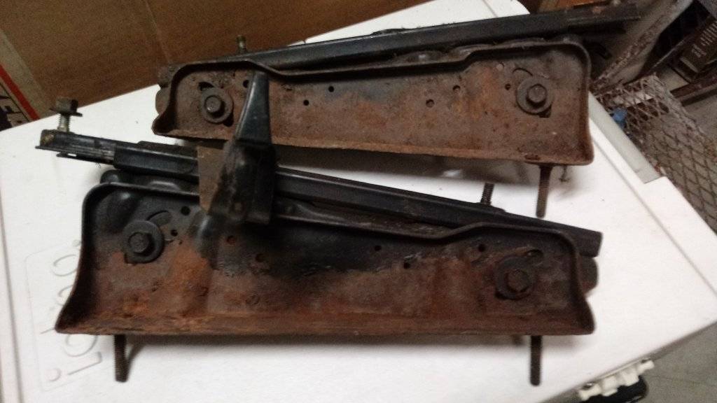

When you pull the seat out, look at the bottom of the tracks. There should be another set of holes that you can move the bolts too.
This picture is actually a B-body seat track, but the C-body has the same extra bolt holes. One set moves the seat up and one set moves it back. The bolts are peened over, so if you break one, just use a carriage bolt from Lowes Depot.
I've done this on a '68 Chrysler and that inch that you move it will do a lot more than you think it might.

Here's a set of the adjustable tracks...they were picked off a 65 to 68 Fury over 20 yrs ago so I can't swear exactly what they came off...I have the opposite problem, short wife...going to try to rig these on drivers bucket eventually...there should be 4 small spacers between the bracket and the floor...removing those might get you another 1/2 inch lower
