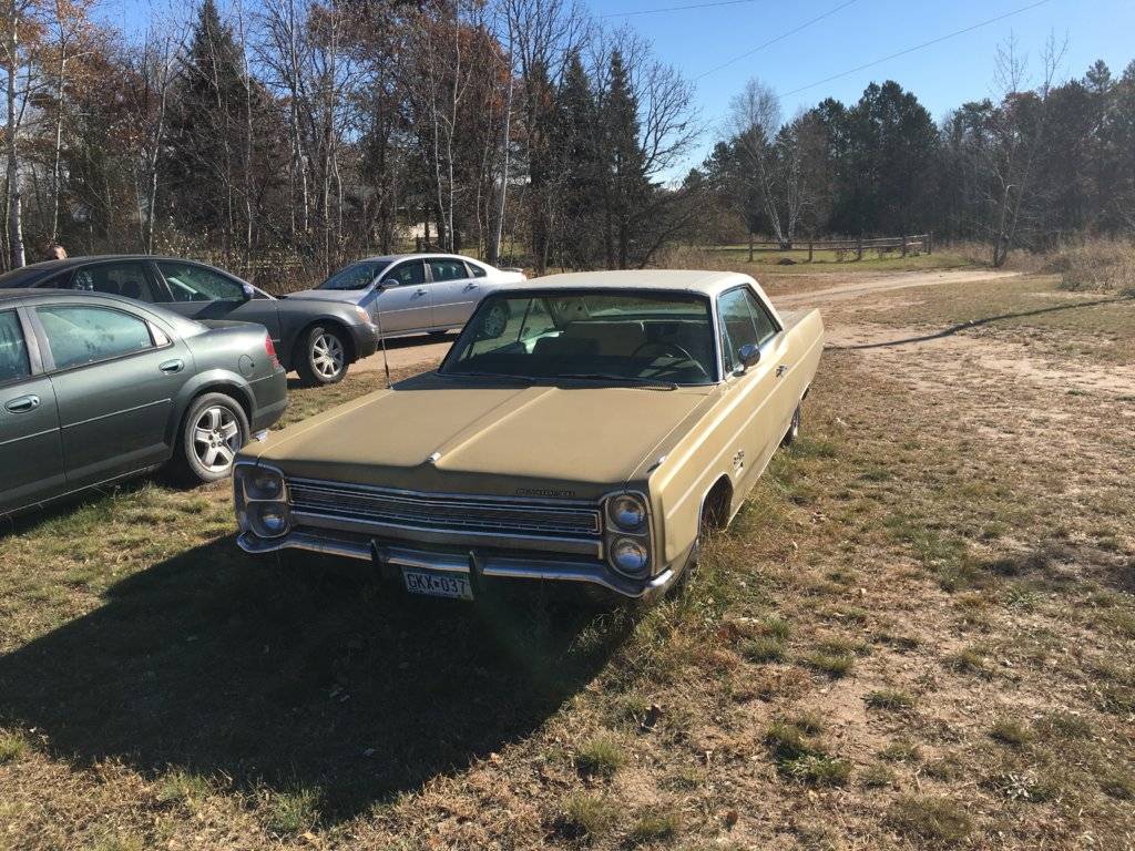

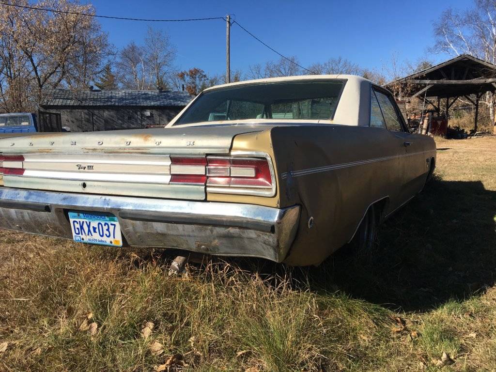

I recently purchased a 68 sport fury III 383 auto, factory a/c, power windows, vinyl top. As far as I can tell so far the car is all original with the factory paint and 87,140 miles on it. It is an Arizona car so it it rust free. Are these cars worth much if it is all original numbers matching? I know it isn’t as desirable as a B body or E body but I hate to start modifying stuff if it is worth decent cash. The passenger rear 1/4 is dented pretty good but otherwise the car is straight and solid. What are your opinions?

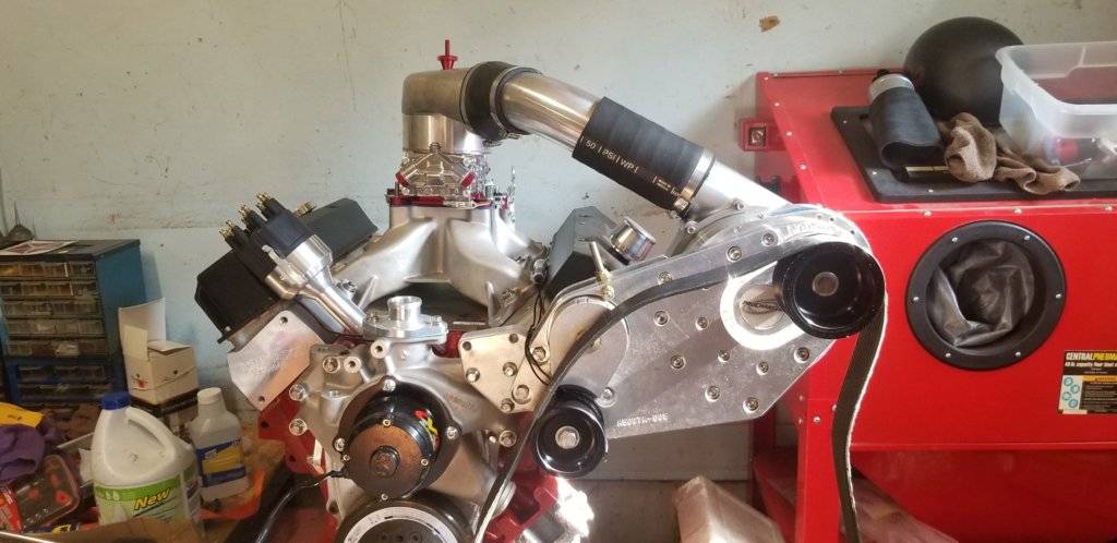

That's exactly what I did. I have a 68 fury 383-496 procharged. Nice having everything tucked under the hood.
