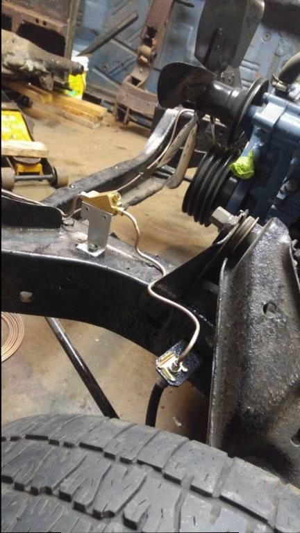

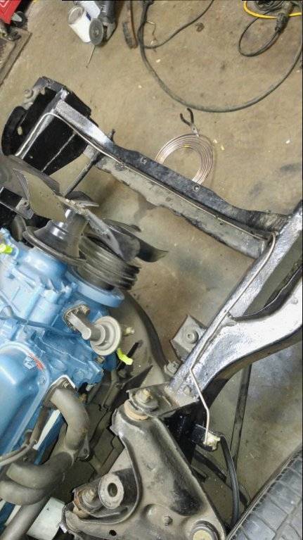

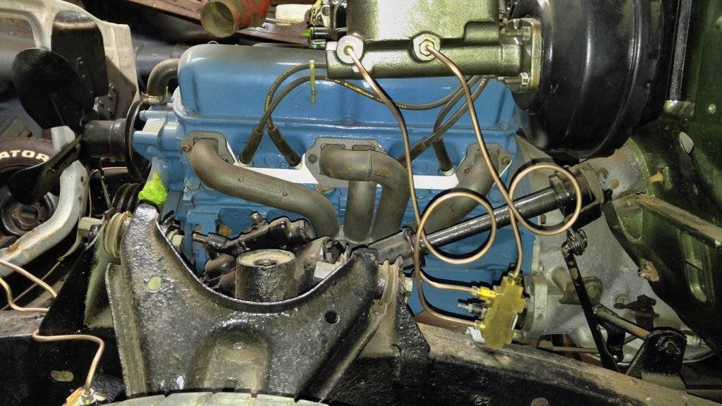

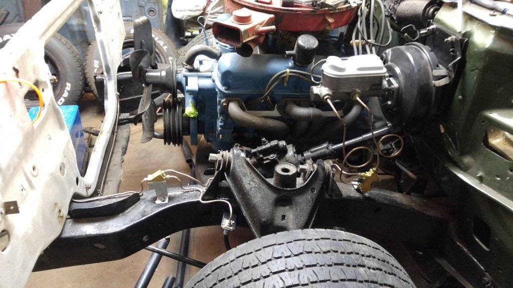

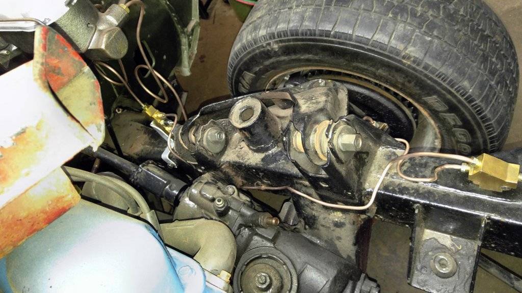

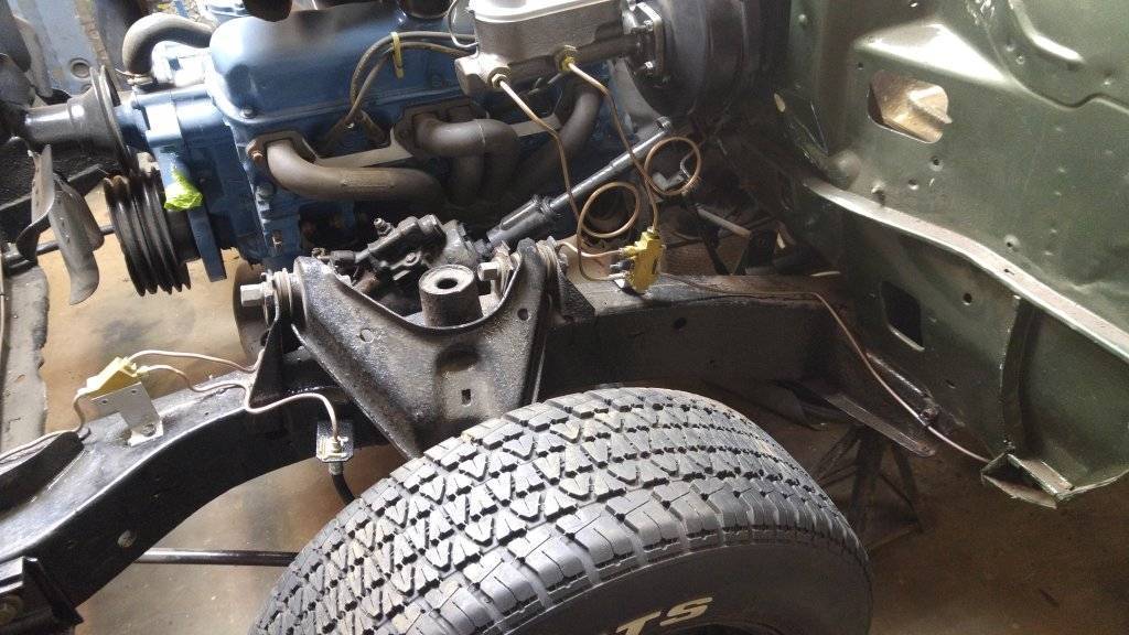

Copper/Nickel, the best stuff you can buy and use, resists corrosion, bends smoother, flares better.Nick, is that steel line?
That's cheap in my book. Well worth it.Copper/Nickel, the best stuff you can buy and use, resists corrosion, bends smoother, flares better.
All I use at work, it's not cheap though, 25 feet of steel 3/16 is $8, 25 feet of the cop/Nick in 3/16 is $35

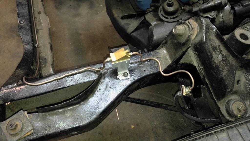

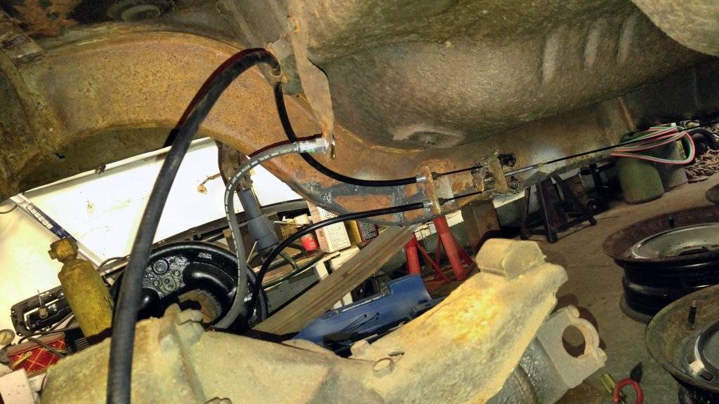

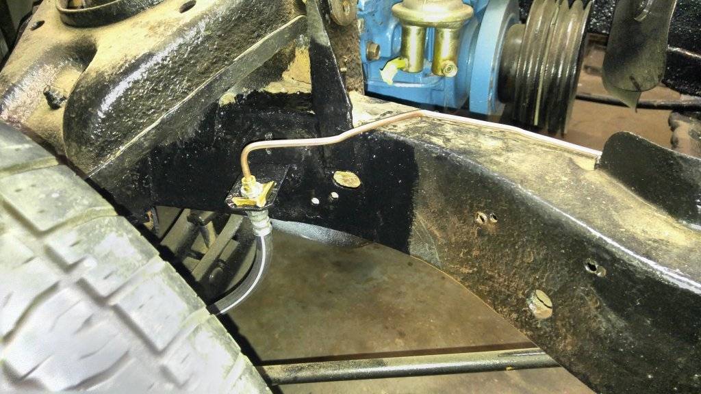

I bought some steel line a few years ago, and it is very hard to bend, I'll have to look into the copper/nickel. Interesting, I have no place on my stub frame to clip the brake hoses to. Did you add those? Do they bolt up or are they welded. Great job, BTW, I'll be tackling this soon myself.
Thought you were going after that one?Buy that parts car and use those lines
The clips were on there from day 1, it and the parts car I just dismantled have them, I'm not sure how they are held in?I bought some steel line a few years ago, and it is very hard to bend, I'll have to look into the copper/nickel. Interesting, I have no place on my stub frame to clip the brake hoses to. Did you add those? Do they bolt up or are they welded. Great job, BTW, I'll be tackling this soon myself.
Looking good, the copper/nickel lines rock. Very easy to work with.
They are not 100% copper, they are DOT approved and once you use them you will never use anything else. Stainless becomes brittle when worked creating a fragile spot at a flare, put some street and strain flexing a real street car and you will have a failure. This is the reason auto makers do not use the stuff. Stainless is for trailer cars and tv show cars. Copper nickel is for cars that get used. Steel lines are for stubborn people that like to do brake lines the hard way over and over.And a recipe for disaster. It's your brake system, use stainless....!
